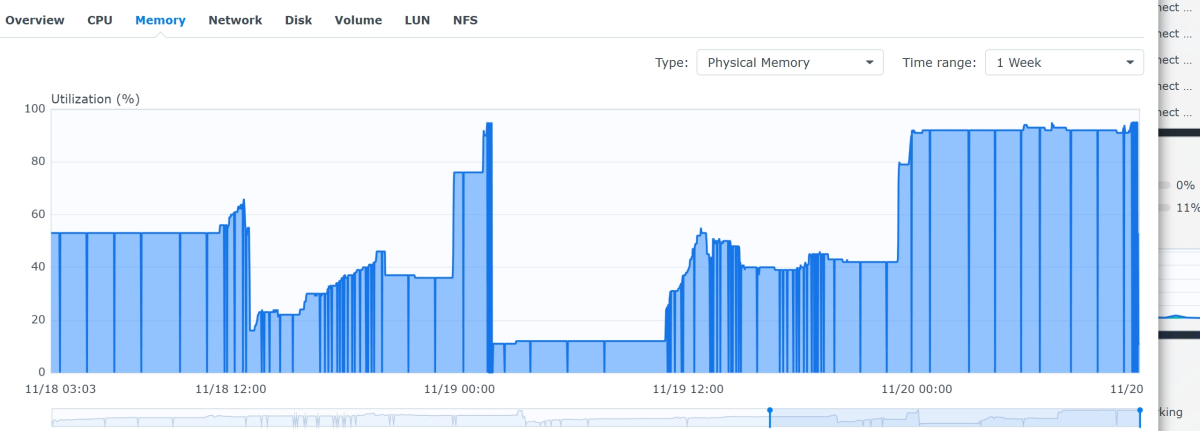

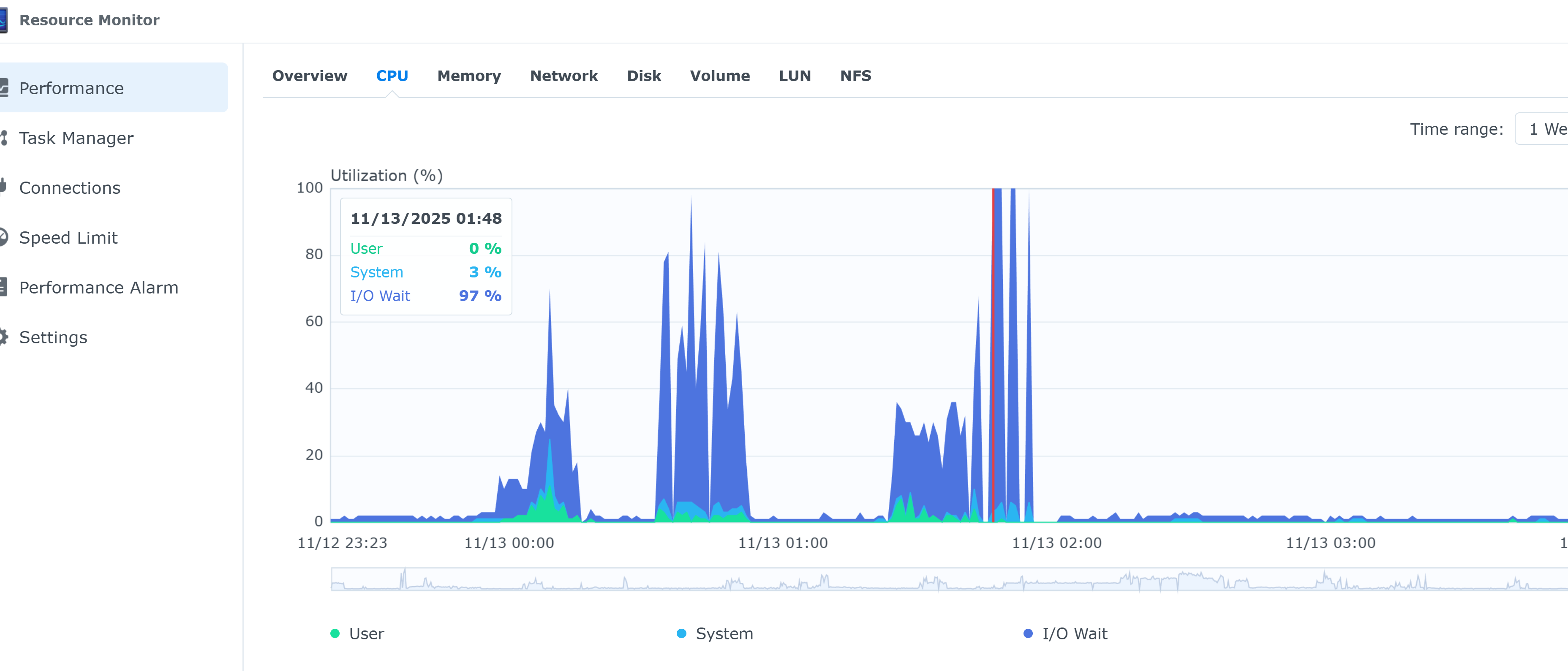

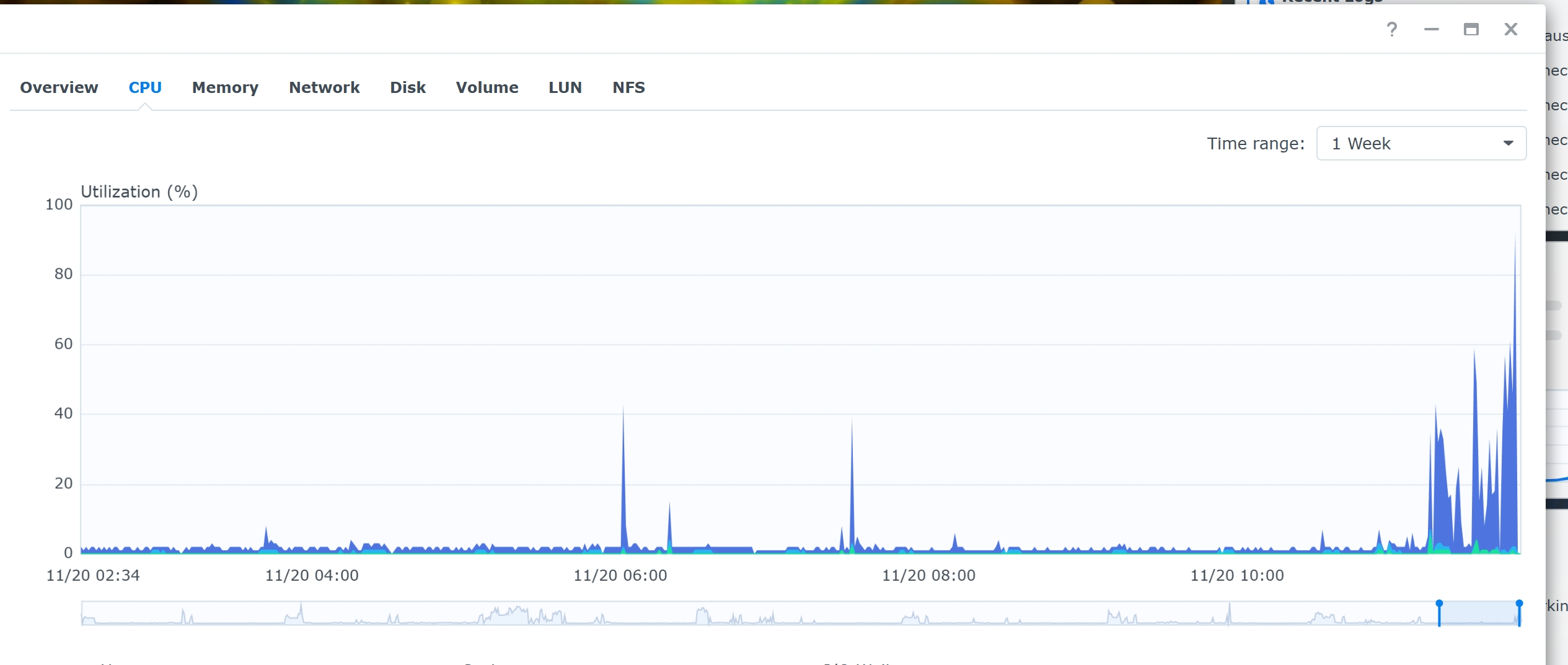

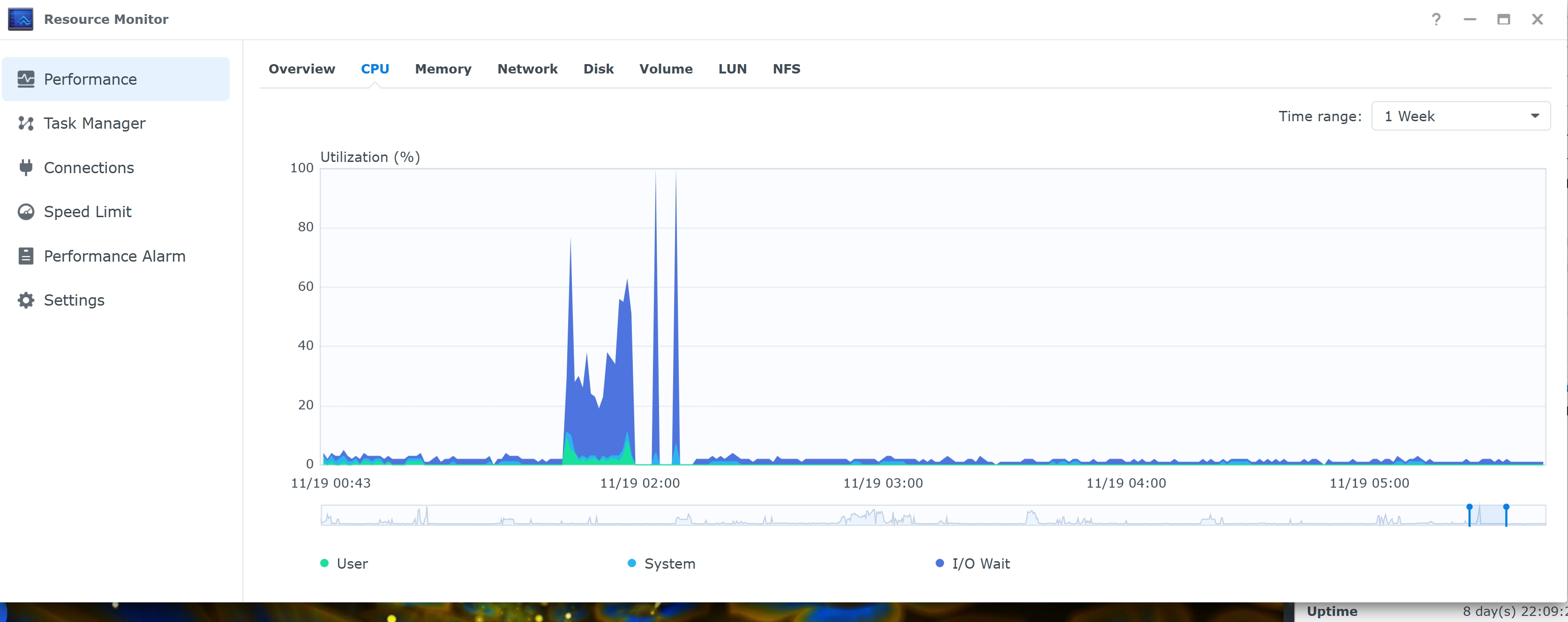

Kiniu 22 Posted November 17, 2025 Posted November 17, 2025 Hello there. Unfirtunately problem not solved.... i thiught that when i buy more RAM everything is going to be ok but it isnt, it happened again. i did a little research myself but im not a brainiac like you guys so i use common sense i try to find anything out of the ordinary and this is what i found: when i looked at memory i found nothing, network also in normal state but CPU was alarming: i/o wait cause emby to crash. as far as read about his it is cause by applicatio it self but that all i could understan maybe someone have an idea how to fix this? i want to also add that it happend when server was idle in the middel of the night - everytime, i attach logs as well. embyserver.txt

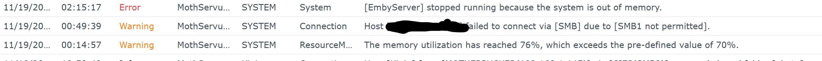

Kiniu 22 Posted November 19, 2025 Author Posted November 19, 2025 hello Luke. Unfortunately, I didn’t have to wait long. It happens again this night I have yesterday disconnected those two plugs that you suggested and then in the middle of the night this happened again. The strange thing is that it happens again of the same time. I attached a new log file. any solution on your mind? syslog_2025-11-19-13_37_20.csv

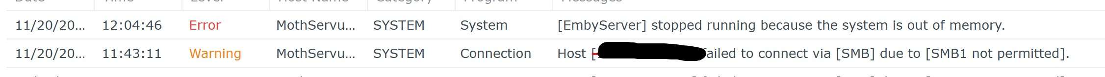

Kiniu 22 Posted November 20, 2025 Author Posted November 20, 2025 Hi there guys. It happened again. I send another log maybe it will help you. syslog_2025-11-20-12_14_7.html 1

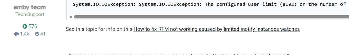

sa2000 696 Posted November 21, 2025 Posted November 21, 2025 @Kiniu Some feedback for other issues seen in the log - You have reached the iNotify limit of 8192 for the libraries "Real Time Monitoring" System.IO.IOException: System.IO.IOException: The configured user limit (8192) on the number of inotify watches has been reached, or the operating system failed to allocate a required resource. See this topic for info on this How to fix RTM not working caused by limited inotify instances watches - You have permissions issue on your emby server backup path "/volume1/music/Emby backup/" 2025-11-13 12:00:03.631 Error Backup & Restore: Error copying file from /var/packages/EmbyServer/var/config/users/0c379bb4074b43e4a229071b9be6e75a/@eaDir/poster.png/SYNOPHOTO_THUMB_XL.jpg to /volume1/music/Emby backup/embyserver-backup-full/config/users/0c379bb4074b43e4a229071b9be6e75a/@eaDir/poster.png/SYNOPHOTO_THUMB_XL.jpg . . . System.UnauthorizedAccessException: System.UnauthorizedAccessException: Access to the path '/volume1/music/Emby backup/embyserver-backup-full/config/users/0c379bb4074b43e4a229071b9be6e75a/@eaDir/poster.png/SYNOPHOTO_THUMB_XL.jpg' is denied. ---> System.IO.IOException: Permission denied 1

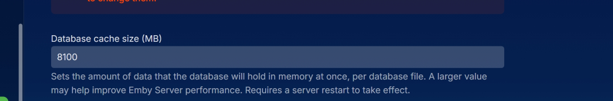

Kiniu 22 Posted November 22, 2025 Author Posted November 22, 2025 Hi... Unfortunately, for me, this crash didn’t happen during that night so I stopped the log and I started a new one. I attached de logs to that post, but I was analyzing what you wrote it to me about scanning Media library, during that log I have scanned the library couple of times and seems like it didn’t have any bad effect on this. ( i force scanning when i add new files or change icons etc...) In the meantime, I also set up log which was suggested in that link. I’m sending you those files as well. Maybe it will help. files script and output. Another thing is about the size of the cash on the server. I changed that number to the highest possible maybe that was the reason why he didn’t happen last night. if this decision was not wise please let me know and i change back to default value. "Oh and one more thing"... One more thing I would like to mention is that my NAS have eight gig Ram capacity.but this is recent, when this starts I had only four gig RAM. I thought that when I buy more RAM, it will not happen again (but unfortunately dId ) so I add another piece of RAM, which at the end didn’t make any change. hope this maybe helps. script.log output.log MothServucker_emby_memory_log_2025-11-21 (1).csv MothServucker_emby_memory_log_2025-11-22.csv MothServucker_emby_memory_log_2025-11-21.csv
sa2000 696 Posted November 22, 2025 Posted November 22, 2025 (edited) 10 hours ago, Kiniu said: so I stopped the log and I started a new one. You don't need to do that. You can leave it running. I see you left the original script running and started another one on 22 november at 00:57:49. That is fine. So long as I have complete memory logging from launch time of emby server up to the time of the issue arising You mention cache. you mention running scanning twice but you did not include the embyserver logs for the times covered by memory logging and you doing these changes / tests You quoted the iNotify limit issue of 8192 but then said you changed the db cache to 8100. That was wrong thing to do. The db cache has nothing to do with the iNotify Library Real Monitoring issue. Please set the db cache back to the default of 128 Mb and restart the server - but switch to the new script below and run it before you restart the server For the iNotify issue, read the linked forum topic that i gave you here One other thing to be aware is that server logs get purged after 3 days - so you either save the files out of the logs folder every 2 days or you restart the emby server evey 3 days and hope you can get the problem arise within the 2-3 day period. If you do copy the logs files out to save them, note these copies would not be sanitized so do not post in the forum - you can zip all the files and PM to me if you did copy them out. PS: You can switch to this version of the script which will append if restarted on same day (echo "PID,time,VmPeak,VmSize,VmLck,VmPin,VmHWM,VmRSS,VmData,VmStk,VmExe,VmLib,VmPTE,VmSwap"; while :; do PID=$(pidof EmbyServer | awk '{print $1}'); [ -z "$PID" ] && { sleep 1; continue; }; printf "%s," "$PID"; date "+%F %T" | tr '\n' ','; awk '/^VmPeak|^VmSize|^VmLck|^VmPin|^VmHWM|^VmRSS|^VmData|^VmStk|^VmExe|^VmLib|^VmPTE|^VmSwap/ {gsub(/ kB/, "", $2); gsub(/[ \t]/, "", $2); printf "%s,", $2}' /proc/$PID/status | sed 's/,$//'; echo; sleep 1; done) | tee -a "$(cat /etc/hostname)_emby_memory_log_$(date +%F).csv" The script should be running before server is launched. If the server is relaunched later it will automatically pick the new process PID - so you can leave this running all the time until you get the problem and when you do, make sure you include the debug enabled server logs as well as the memory log csv file Thanks Edited November 22, 2025 by sa2000
