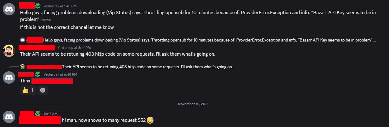

Neminem 1585 Posted November 15, 2025 Posted November 15, 2025 I'm seeing the same thing in Bazarr so guess Opensubtitles.com are having API issues. Throttling opensubtitlescom for 1 minute, until 25/11/15 02:27, because of: TooManyRequests. Exception info: "'' ~ opensubtitlescom.py@545" 2025-11-15 02:26:03 Using opensubtitlescom again after 1 minute, (disabled because: TooManyRequests) 2025-11-15 02:26:03 Throttling opensubtitlescom for 1 minute, until 25/11/15 02:24, because of: TooManyRequests. Exception info: "'' ~ opensubtitlescom.py@545" 2025-11-15 02:23:01 Using opensubtitlescom again after 1 minute, (disabled because: TooManyRequests) 2025-11-15 02:23:00 Throttling opensubtitlescom for 1 minute, until 25/11/15 02:22, because of: TooManyRequests. Exception info: "'' ~ opensubtitlescom.py@545" 2025-11-15 02:21:58 Using opensubtitlescom again after 1 minute, (disabled because: TooManyRequests) 2025-11-15 02:21:58 Throttling opensubtitlescom for 1 minute, until 25/11/15 02:21, because of: TooManyRequests. Exception info: "'' ~ opensubtitlescom.py@545" According to Bazarr discord discussion devs are asking Opensubtitles what going on.

Neminem 1585 Posted November 16, 2025 Posted November 16, 2025 Have a look at this. It looks like they are working on it. To many Request+Bazarr - General Talk - Open Subtitles
