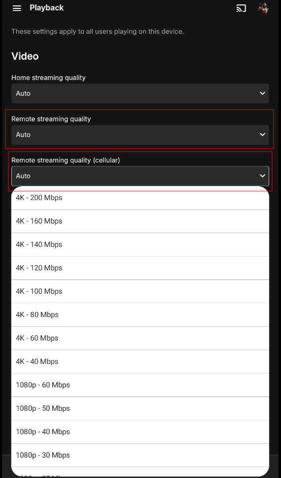

Neminem 1623 Posted November 14, 2025 Posted November 14, 2025 Try playing with these settings in your mobile app. Because of this. TranscodeReasons=ContainerBitrateExceedsLimit Also do you transcode to HEVC ? Try turning that off.

EatPrilosec 22 Posted November 14, 2025 Author Posted November 14, 2025 Quote Try playing with these settings in your mobile app. i have, tons of combinations. Quote Also do you transcode to HEVC ? wow you know what, i think that fixed it... why would hevc only have an issue on a mobile network? i had no issue transcoding to hevc (according to stats for nerds) on local WIFI or outside the network on WIFI
