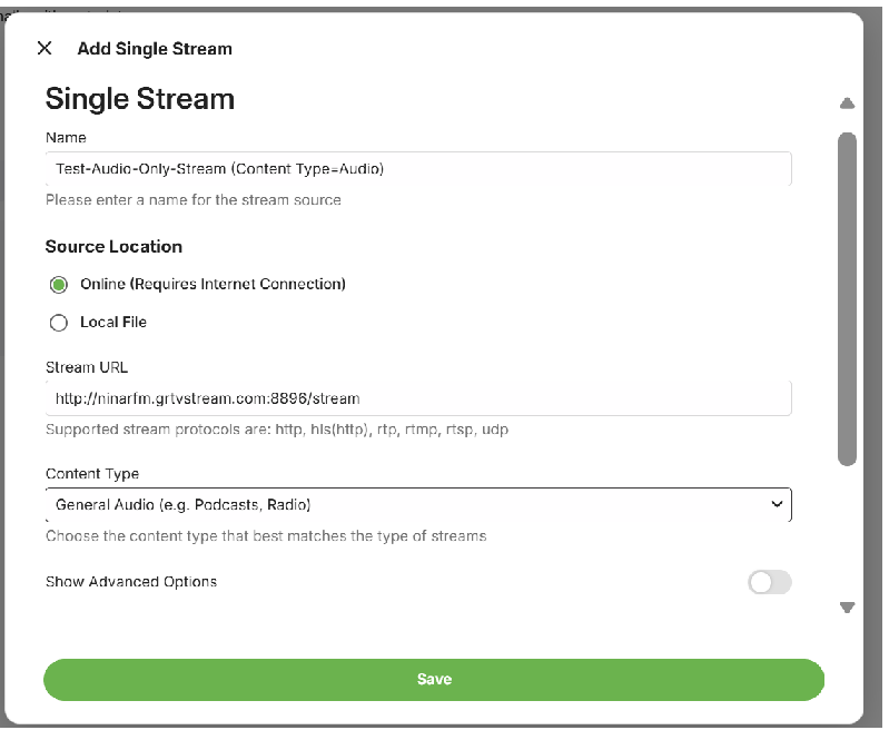

Relocate0604 8 Posted November 13, 2025 Posted November 13, 2025 I’m running Emby (Version 4.9.1.80) in Docker on my NAS and trying to add a simple internet radio streaming the plugin Web Streams 4.9.1.28. I will take this as an example: http://ninarfm.grtvstream.com:8896/stream It works in browser, VLC and even inside the container using: docker exec -it embyserver ffmpeg -i http://ninarfm.grtvstream.com:8896/stream -f null - So FFmpeg clearly works. But in Emby, no matter what I try — direct URL, .m3u, .str or M3U tuner — I always get: Playback Error No compatible streams are currently available. Please try again later or contact your system administrator for details. Emby logs show nothing useful; it doesn’t even seem to start an FFmpeg process when I click play. I have enabled debug logging and then tried starting the stream multiple times before downloading the log file attached. I must add that the Live TV function does work without any issues. On reddit a user tried adding the stream and it worked immediately. How can I find out what it preventing the stream and how do I get it to work correctly? embyserver.txt
Luke 42288 Posted November 14, 2025 Posted November 14, 2025 Hi, what options did you configure the webstream with?

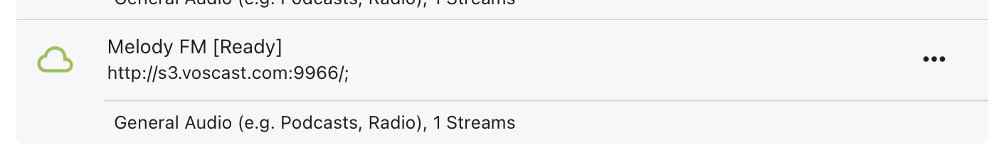

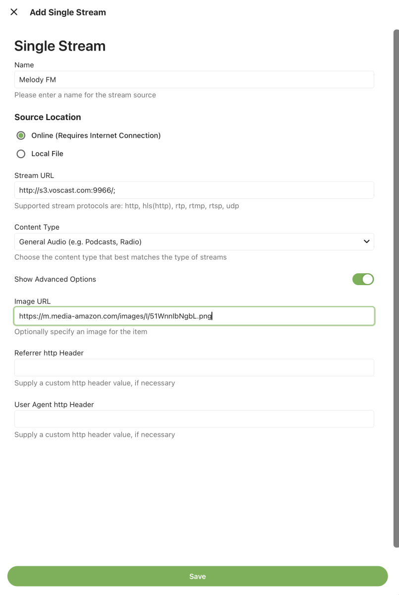

Relocate0604 8 Posted November 14, 2025 Author Posted November 14, 2025 For example there is this Web Stream of a Radio Station That I Know works (http://s3.voscast.com:9966/;). I simply add the stream as follows: Then the stream is added: But opening the stream always results in error.

Happy2Play 9814 Posted November 17, 2025 Posted November 17, 2025 (edited) To me it is something with Content Type as leaving it on default "General Video" the url in first post worked just fine in Web Stream. But changing to "General Audio" I got the playback error above with same error in log "System.IndexOutOfRangeException: Index was outside the bounds of the array." But devs would have to comment on what actually changes per these types. Not this was a test on plugin 4.9.1.28 ffmpeg-transcode-c46aebf0-5a7f-44e2-af55-230cb356ee12_1.txt Edited November 17, 2025 by Happy2Play

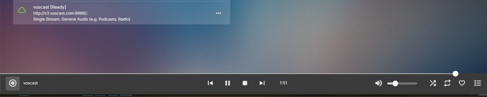

sa2000 703 Posted November 17, 2025 Posted November 17, 2025 There may still be a WebStreams issue - this url streams ok on vlc but not webstreams http://s3.voscast.com:9966
Happy2Play 9814 Posted November 17, 2025 Posted November 17, 2025 (edited) 6 minutes ago, sa2000 said: There may still be a WebStreams issue - this url streams ok on vlc but not webstreams http://s3.voscast.com:9966 your missing the /; as I just added the url above and had no issue. Edited November 17, 2025 by Happy2Play
sa2000 703 Posted November 17, 2025 Posted November 17, 2025 interesting no change for me with or without the trailing "/". ffmpeg log exits with error on this 18:45:02.443 http://s3.voscast.com:9966/: Invalid data found when processing input Invocation 2025-11-17 18:45:01.927 Info App: ProcessRun 'StreamTranscode 3777bd' Execute: C:\Users\emby\AppData\Roaming\Emby-Server\system\ffmpeg.exe -loglevel +timing -y -print_graphs_file "C:\Users\emby\AppData\Roaming\Emby-Server\programdata\logs\ffmpeg-transcode-3777bd2b-f17f-4498-b6ba-dc2f2a1e6667_1graph.txt" -copyts -start_at_zero -user_agent "Mozilla/5.0 (Windows NT 10.0; Win64; x64) AppleWebKit/537.36 (KHTML, like Gecko) Chrome/64.0.3282.85 Safari/537.36" -i "http://s3.voscast.com:9966/" -vn -an -sn -max_delay 5000000 -avoid_negative_ts disabled -f segment -map_metadata -1 -map_chapters -1 -segment_format mpegts -segment_list "F:\Emby\Transcoder\transcoding-temp\943D6E\943D6E.m3u8" -segment_list_type m3u8 -segment_time 00:00:03.000 -segment_list_entry_prefix hls/943D6E/ -segment_start_number 0 -individual_header_trailer 0 -write_header_trailer 0 -segment_write_temp 1 "F:\Emby\Transcoder\transcoding-temp\943D6E\943D6E_%d.aac" I will look further
Happy2Play 9814 Posted November 17, 2025 Posted November 17, 2025 (edited) 4 minutes ago, sa2000 said: interesting no change for me with or without the trailing "/". ffmpeg log exits with error on this 18:45:02.443 http://s3.voscast.com:9966/: Invalid data found when processing input Invocation 2025-11-17 18:45:01.927 Info App: ProcessRun 'StreamTranscode 3777bd' Execute: C:\Users\emby\AppData\Roaming\Emby-Server\system\ffmpeg.exe -loglevel +timing -y -print_graphs_file "C:\Users\emby\AppData\Roaming\Emby-Server\programdata\logs\ffmpeg-transcode-3777bd2b-f17f-4498-b6ba-dc2f2a1e6667_1graph.txt" -copyts -start_at_zero -user_agent "Mozilla/5.0 (Windows NT 10.0; Win64; x64) AppleWebKit/537.36 (KHTML, like Gecko) Chrome/64.0.3282.85 Safari/537.36" -i "http://s3.voscast.com:9966/" -vn -an -sn -max_delay 5000000 -avoid_negative_ts disabled -f segment -map_metadata -1 -map_chapters -1 -segment_format mpegts -segment_list "F:\Emby\Transcoder\transcoding-temp\943D6E\943D6E.m3u8" -segment_list_type m3u8 -segment_time 00:00:03.000 -segment_list_entry_prefix hls/943D6E/ -segment_start_number 0 -individual_header_trailer 0 -write_header_trailer 0 -segment_write_temp 1 "F:\Emby\Transcoder\transcoding-temp\943D6E\943D6E_%d.aac" I will look further add the semicolon. http://s3.voscast.com:9966/; Spoiler C:\Users\Media\AppData\Roaming\Emby-Server\system\ffmpeg.exe -loglevel +timing -y -print_graphs_file "C:\Users\Media\AppData\Roaming\Emby-Server\programdata\logs\ffmpeg-transcode-c51ca3c9-a2ae-4e9f-ae32-cb94401b323e_1graph.txt" -copyts -start_at_zero -user_agent "Mozilla/5.0 (Windows NT 10.0; Win64; x64) AppleWebKit/537.36 (KHTML, like Gecko) Chrome/64.0.3282.85 Safari/537.36" -i "http://s3.voscast.com:9966/;" -map 0:0 -vn -sn -c:a:0 aac -ab:a:0 384000 -ac:a:0 2 -max_delay 5000000 -avoid_negative_ts disabled -f segment -map_metadata -1 -map_chapters -1 -segment_format mpegts -segment_list "C:\Users\Media\AppData\Roaming\Emby-Server\programdata\transcoding-temp\9083A9\9083A9.m3u8" -segment_list_type m3u8 -segment_time 00:00:03.000 -segment_list_entry_prefix hls/9083A9/ -segment_start_number 0 -individual_header_trailer 0 -write_header_trailer 0 -segment_write_temp 1 "C:\Users\Media\AppData\Roaming\Emby-Server\programdata\transcoding-temp\9083A9\9083A9_%d.aac" Edited November 17, 2025 by Happy2Play
sa2000 703 Posted November 17, 2025 Posted November 17, 2025 you got me ! I did not have the semicolon at the end. works ok once added. Interesting that vlc did not need it
Luke 42288 Posted November 18, 2025 Posted November 18, 2025 This doesn't look like a problem with webstreams. It is a problem with your stream url. This url redirects to an html web page: http://s3.voscast.com:9966 This url goes straight to an audio stream: http://s3.voscast.com:9966/; You cannot configure the plugin with web page urls. They need to link directly to an audio or video stream. 1
