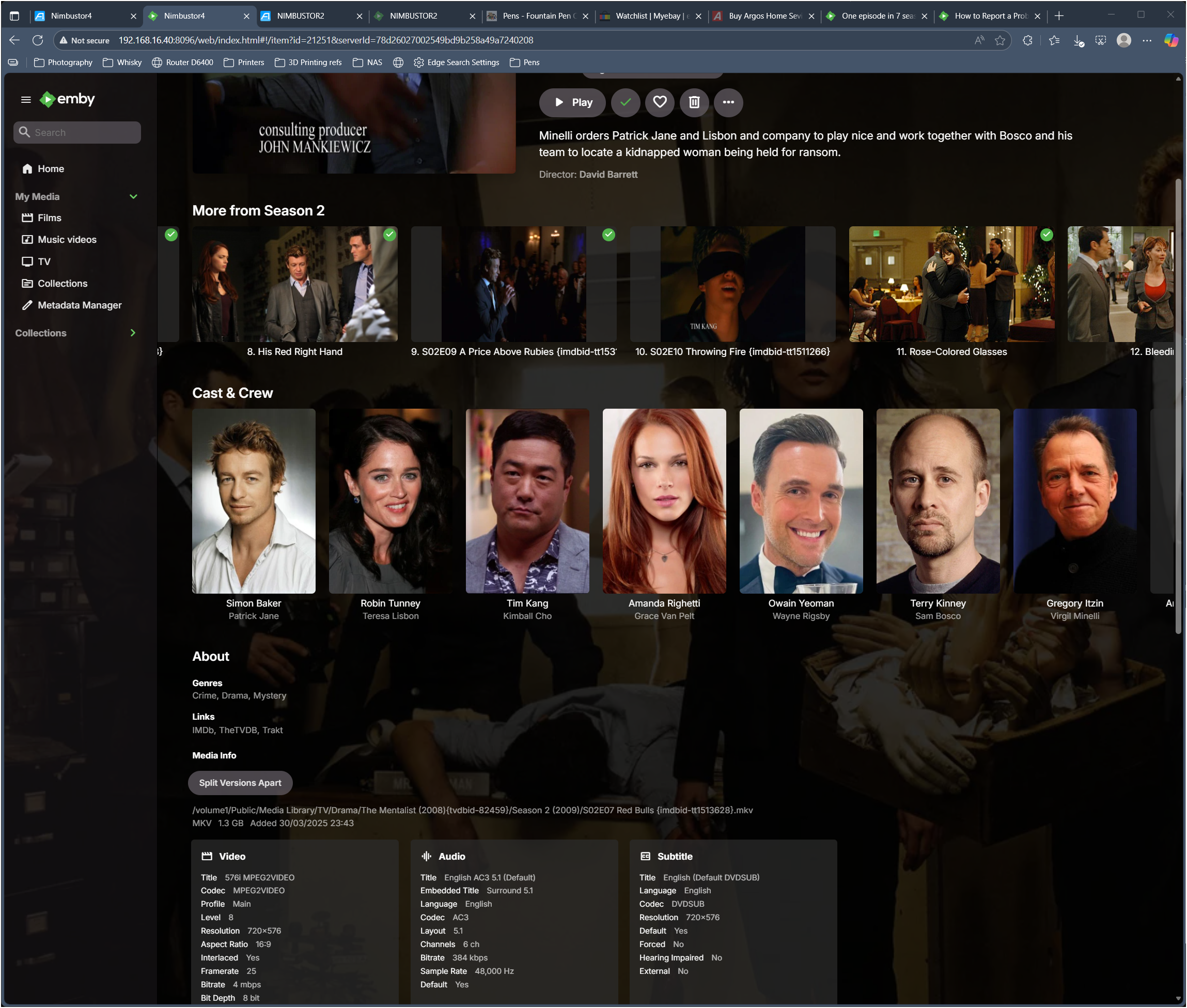

ramseyn 15 Posted November 13, 2025 Author Posted November 13, 2025 You obviously mean something I don't understand. I cannot see S06E07 to show a detail view. S02Eo7, a completely different season, does have a Split Versions button but references only the S02E07 file as its source

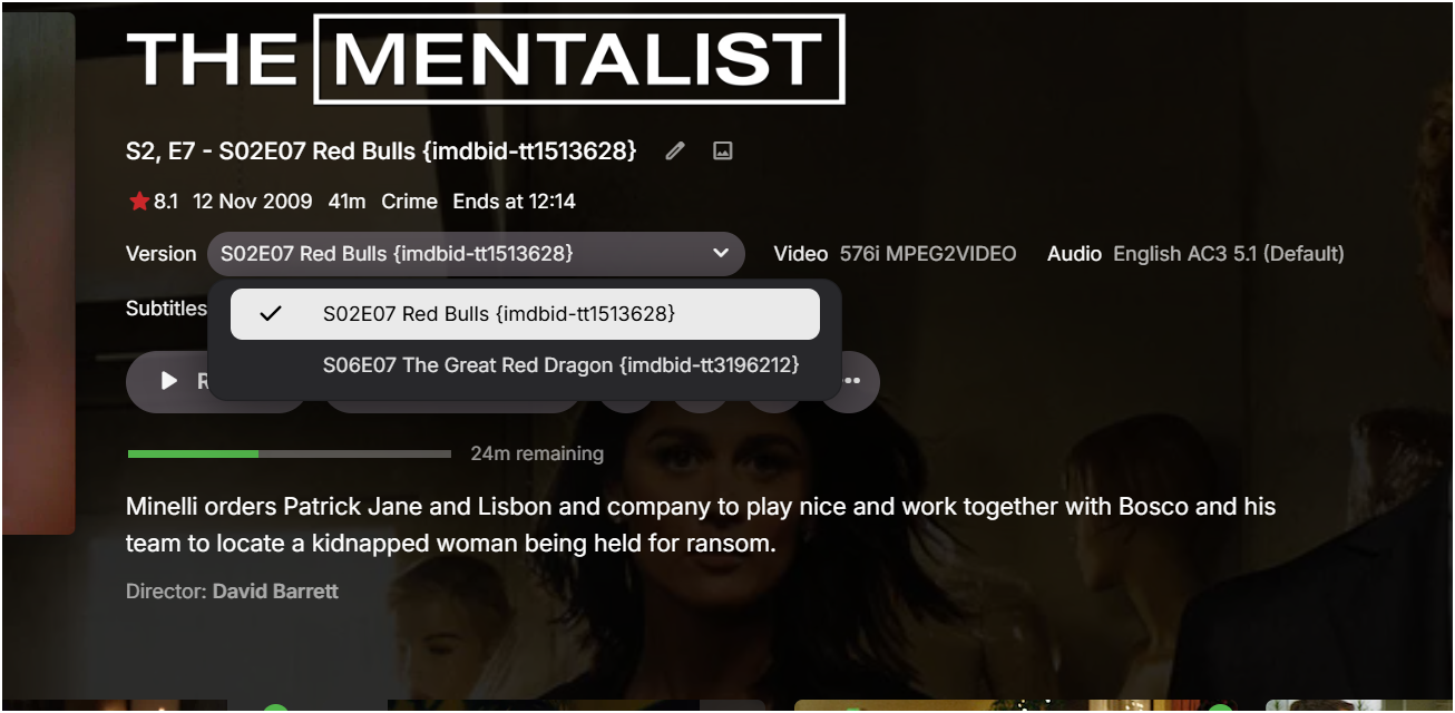

GrimReaper 4893 Posted November 13, 2025 Posted November 13, 2025 Your S06E07 was likely erroneously merged with S02E07, meaning identified as another version of S02E07. I'm not asking you for S06E07 details, as it obviously doesn't exist, but for S02E07 details. Can you share a screenshot of S02E07 detail view, below the Split versions button, showing paths for both files?
ramseyn 15 Posted November 13, 2025 Author Posted November 13, 2025 Ah, under versions in the top you are right - it shows S06E07 there! Why? If I Split Versions where will S06E07 go?
GrimReaper 4893 Posted November 13, 2025 Posted November 13, 2025 5 minutes ago, ramseyn said: Ah, under versions in the top you are right - it shows S06E07 there! Yes, that's what I was trying to determine.
GrimReaper 4893 Posted November 13, 2025 Posted November 13, 2025 6 minutes ago, ramseyn said: If I Split Versions where will S06E07 go? You will have two S02E07 episodes. On the one that has S06E07 path, Edit Metadata and fill Season 6 Episode 7 in respective fields (you can also clear External IDs fields). Refresh Metadata afterwards.

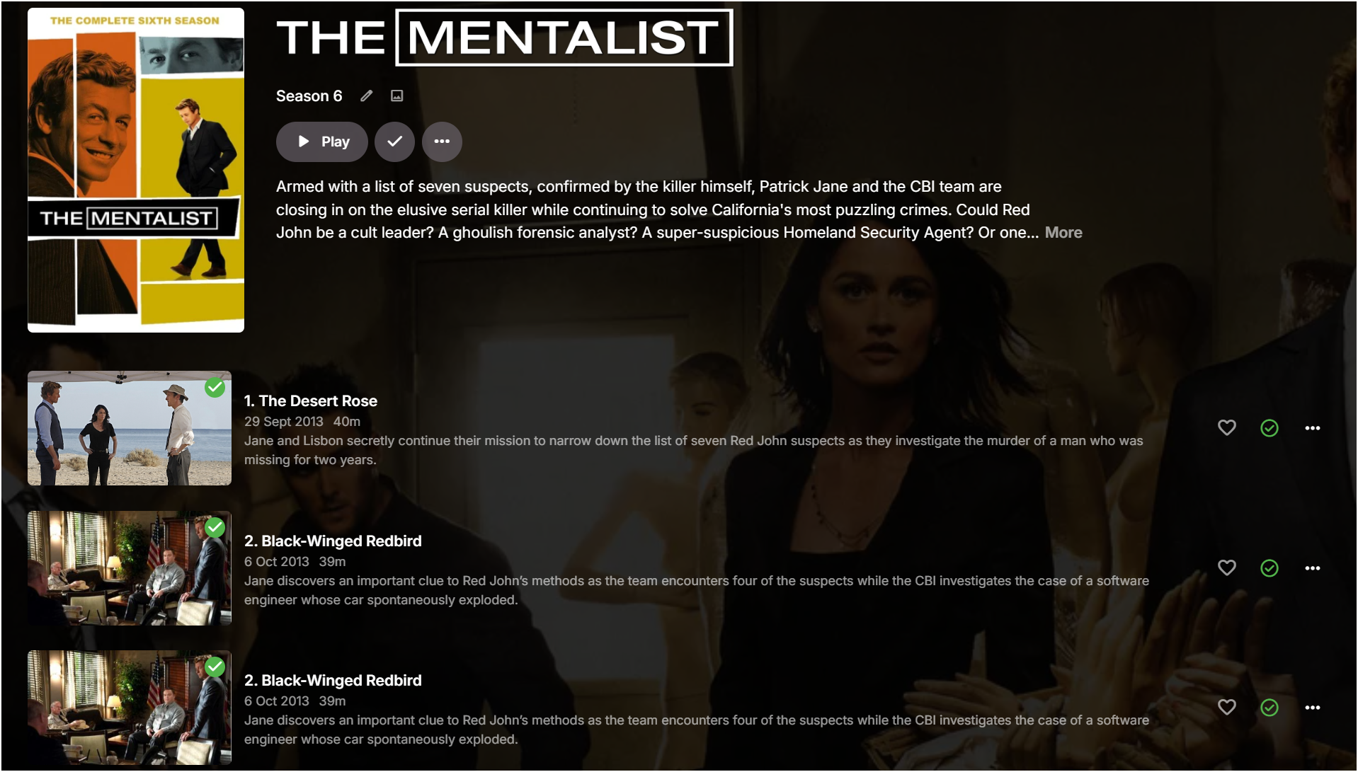

ramseyn 15 Posted November 13, 2025 Author Posted November 13, 2025 Season 6 now has multiple episodes that show more than one version - and the versions are THE SAME. If I split one, it shows the same episode twice in the list and I cannot recombine, nor can I delete one of them because it warns it will delete the file (which is shared by the "other version). And one episode from season 1 has vanished. I am going through 149 episodes in Emby looking for where it may have been merged and have not found it yet (when I reached season 6 and found the issue above)

ramseyn 15 Posted November 13, 2025 Author Posted November 13, 2025 (edited) Got you. I'll try this on my secondary server first before doing it on my main server... And once spit, how do I get rid of the resulting duplicate in the list, since I can't delete it because it will delete the file? Edited November 13, 2025 by ramseyn
GrimReaper 4893 Posted November 13, 2025 Posted November 13, 2025 3 minutes ago, ramseyn said: And once spit, how do I get rid of the resulting duplicate in the list, since I can't delete it because it will delete the file? There's no duplicate and nothing to remove, there's only incorrectly assigned episode. As said: 1 hour ago, GrimReaper said: Edit Metadata and fill Season 6 Episode 7 in respective fields (you can also clear External IDs fields). Refresh Metadata afterwards. Insert proper Season and Episode numbers.

ramseyn 15 Posted November 13, 2025 Author Posted November 13, 2025 16 minutes ago, GrimReaper said: There's no duplicate and nothing to remove, there's only incorrectly assigned episode. There is a duplicate title in the list. Both entries refer to the same file and path and if I try to delete one, it says it will remove that file from disk.
GrimReaper 4893 Posted November 13, 2025 Posted November 13, 2025 2 minutes ago, ramseyn said: Both entries refer to the same file and path and if I try to delete one, it says it will remove that file from disk. That should not be happening, something in the db is messed up. Remove that file from TV show root on your filesystem, run Scan media library to clear the db, move it back, scan again.

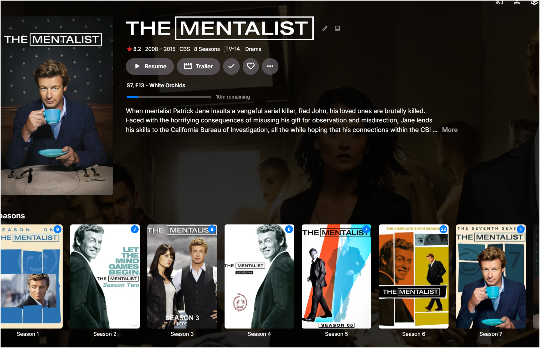

ramseyn 15 Posted November 13, 2025 Author Posted November 13, 2025 (edited) That fixed the duplicate. Unfortunately it also lost all my season images. Here is after and before the move and rescan, move back and rescan... It turns out all the artwork disappeared from the parent folder. I cvopied it across from the other server and it now displays correctly. Why it disappeared is a mystery. Edited November 13, 2025 by ramseyn Added fix
GrimReaper 4893 Posted November 13, 2025 Posted November 13, 2025 (edited) 5 minutes ago, ramseyn said: Unfortunately it also lost all my season images. That didn't, you were literally just scanning, but something else might have, as only you know what other operations you performed. On TV show level, try Refreshing Metadata>Search for missing with Replace existing images ticked. Edit: Also, what Image fetchers you have enabled in your library and in what order? Edited November 13, 2025 by GrimReaper Append
