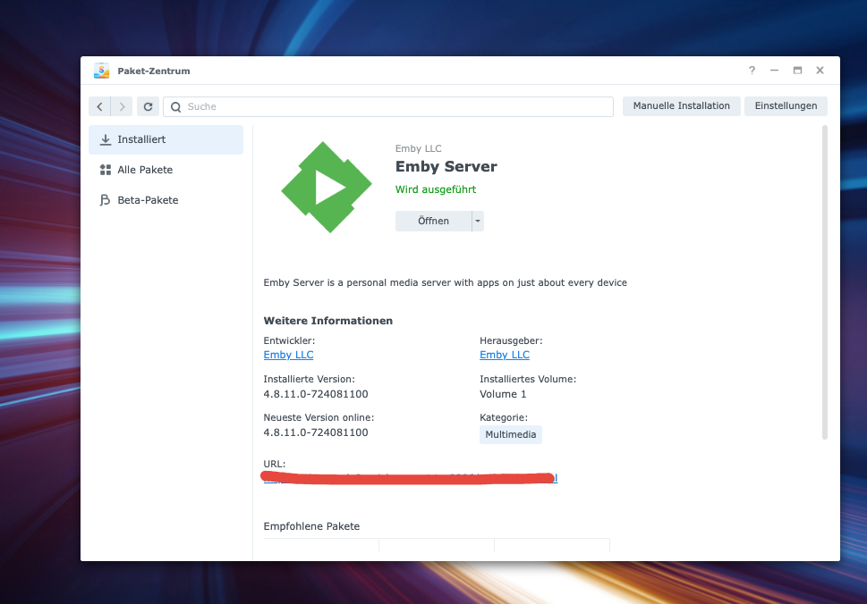

sabayon 10 Posted November 12, 2025 Author Posted November 12, 2025 (edited) 29 minutes ago, GrimReaper said: Are those LAN or WAN connections? Good evening and thanks for your quick reply. It's both, LAN and WAN. I used the link you can see in the screenshot below and it works on all other computers perfectly. Edited November 12, 2025 by GrimReaper WAN IP masked
GrimReaper 4893 Posted November 12, 2025 Posted November 12, 2025 (edited) 13 minutes ago, sabayon said: I used the link you can see in the screenshot below and it works on all other computers perfectly. And when you clicked on it, in your Vivaldi browser address bar, does it still say http:// or it was maybe automatically upgraded to https://? Edit: Is there a particular reason you're still on 4.8.11 0 server version and didn't upgrade to 4.9.1.80 stable? Edited November 12, 2025 by GrimReaper Append
