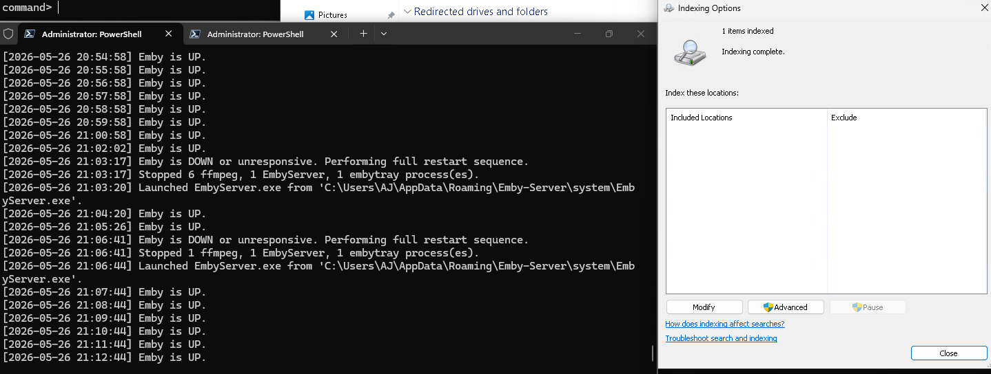

Rumzzz 75 Posted May 26 Author Posted May 26 Hmmm, my indexing on windows 11 is off, at least specifically for the Emby installation folder. Still having the issue.

crash1015 9 Posted May 27 Posted May 27 On 5/25/2026 at 1:22 PM, crash1015 said: That’s a good point. I do remember changing some Windows Indexing settings a while back, though I’m not sure if that lines up with when this started happening. Either way, it’s worth disabling it to test. I’ll report back tomorrow with the results. I can confirm totally disabling indexing did not help, issue still persists :(
