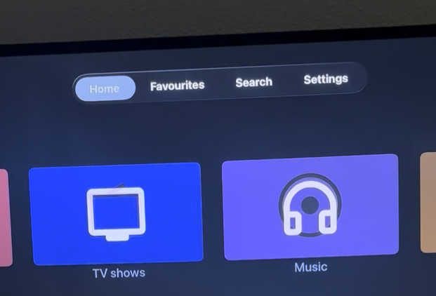

acnp77 69 Posted April 25 Author Posted April 25 @SamESThe last time we looked at the poster images ("flickering" of generic background image), and this got fixed (thanks again). Now I experience the same with the library images. I am not sure if this is new or I just missed to report it last time (sorry). I created some library images, and then I noticed it. It would be great if you could implement the fix also for the library images. Image and video are attached. Emby ATV app version: 2.0.5 (3) Apple TVOS version: 26.3 Thanks a lot ATV_UI_1.mov 1
