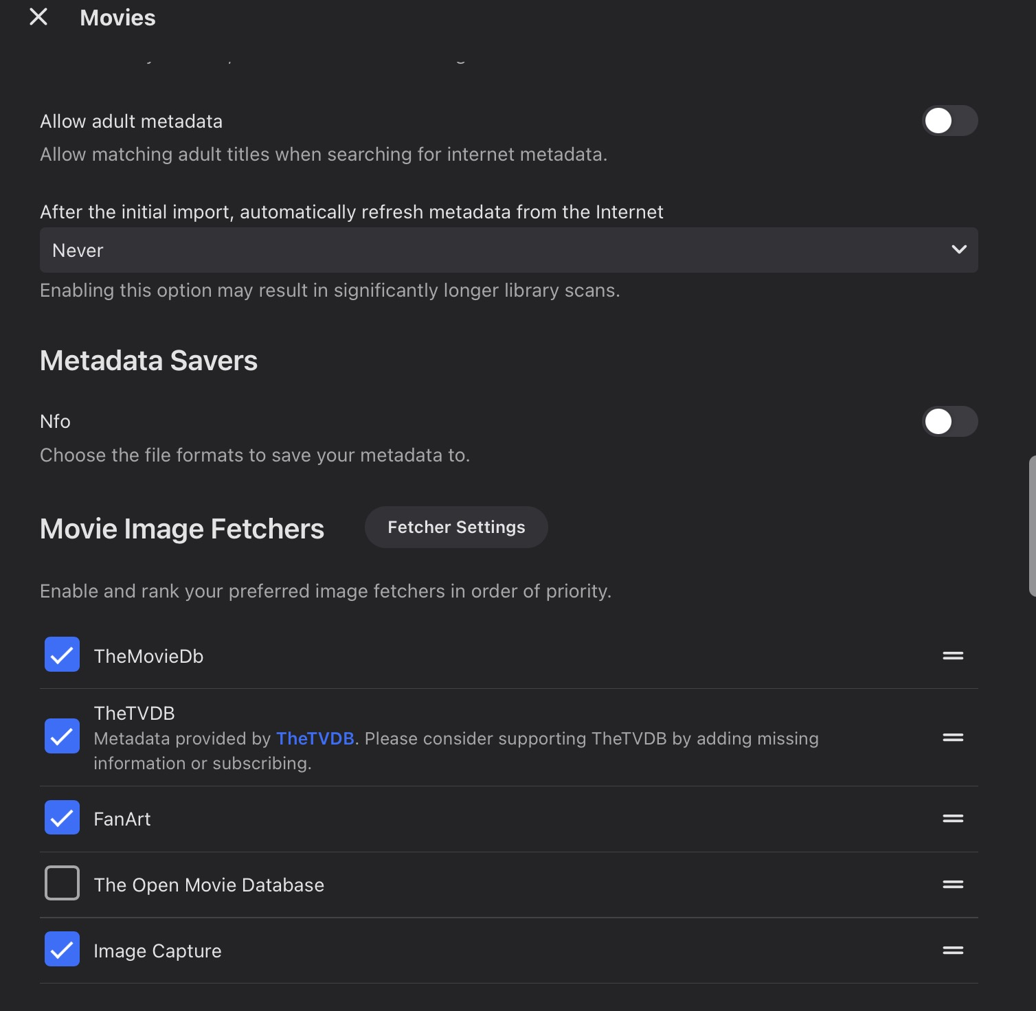

GrimReaper 4926 Posted November 11, 2025 Posted November 11, 2025 What Image fetchers you have enabled in your library settings?
Happy2Play 9814 Posted November 11, 2025 Posted November 11, 2025 (edited) Depends on the image type you are referring to as Thumbs are only available via FanArt per the image type. But other types will use image fetcher order as mentioned. Edited November 11, 2025 by Happy2Play
Blueskies278 43 Posted November 11, 2025 Author Posted November 11, 2025 10 hours ago, GrimReaper said: What Image fetchers you have enabled in your library settings? When I do get artwork, it’s only from FanArt. I find it very limiting. TMDB has way more choice. Jellyfin uses TMDB.

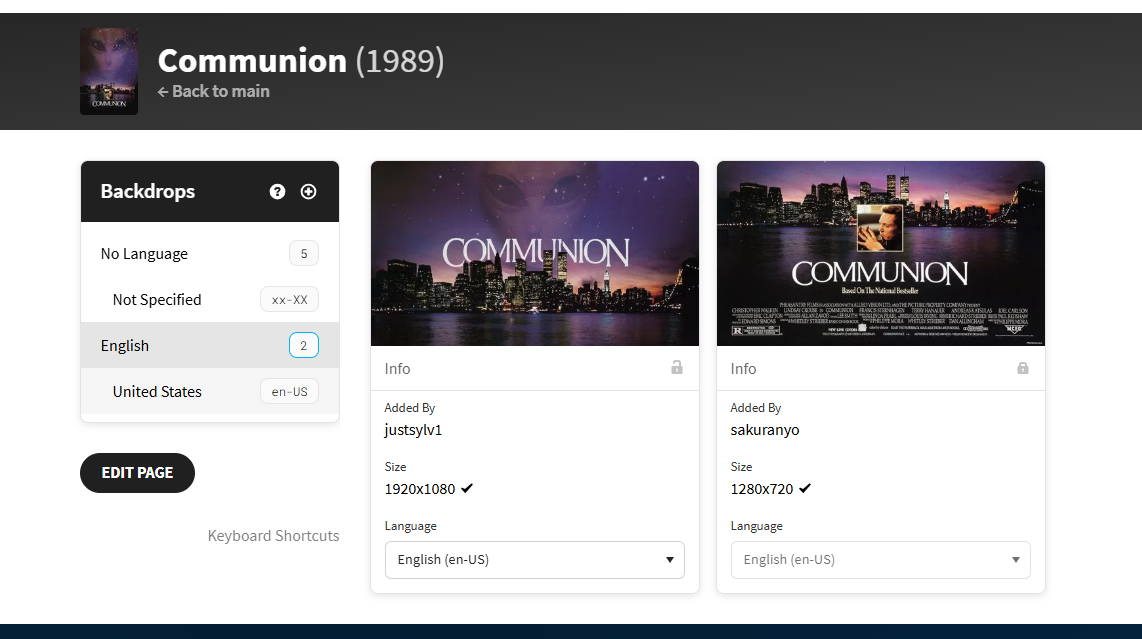

Happy2Play 9814 Posted November 12, 2025 Posted November 12, 2025 6 hours ago, Blueskies278 said: 99% of the time Thumbs do not show. FanArt is the only place that technically has Thumb images. As TMDB sort of does but are Backdrops with text ie language backdrops and are not collected by Emby or mapped to be used a Thumbs. FanArt only has one image for Communion Communion | Movie fanart | fanart.tv Can only get TMDB url from their site to use within Emby 1 1

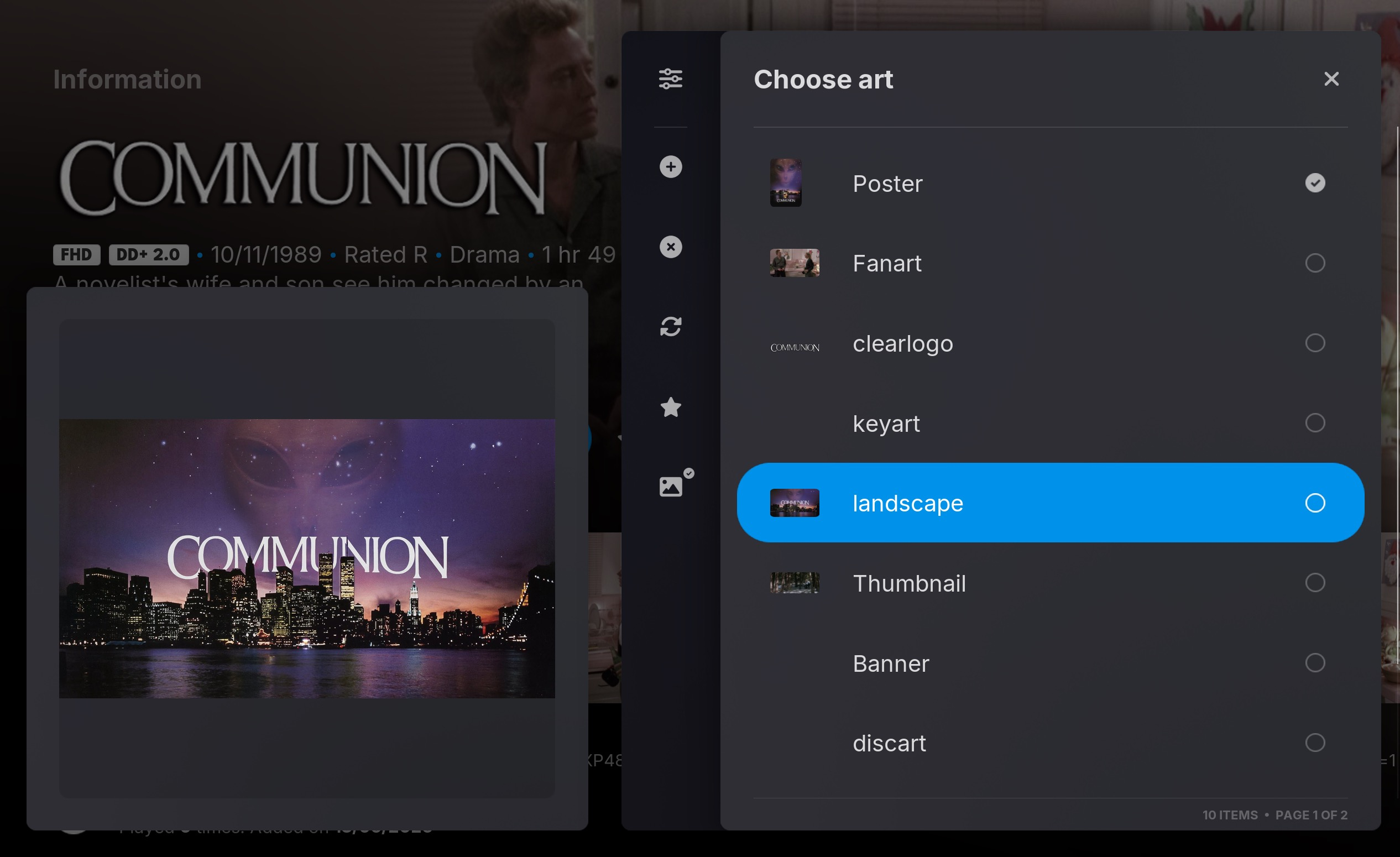

Blueskies278 43 Posted November 12, 2025 Author Posted November 12, 2025 (edited) 59 minutes ago, Happy2Play said: FanArt is the only place that technically has Thumb images. As TMDB sort of does but are Backdrops with text ie language backdrops and are not collected by Emby or mapped to be used a Thumbs. FanArt only has one image for Communion Communion | Movie fanart | fanart.tv Can only get TMDB url from their site to use within Emby That's a shame, as Jellyfin works great. Emby is somewhat limiting regarding FanArt. I hope the developers reconsider adding TMDB for thumb, making Emby a bit more flexible. jellyfin using TMDB for thumb Edited November 12, 2025 by Blueskies278

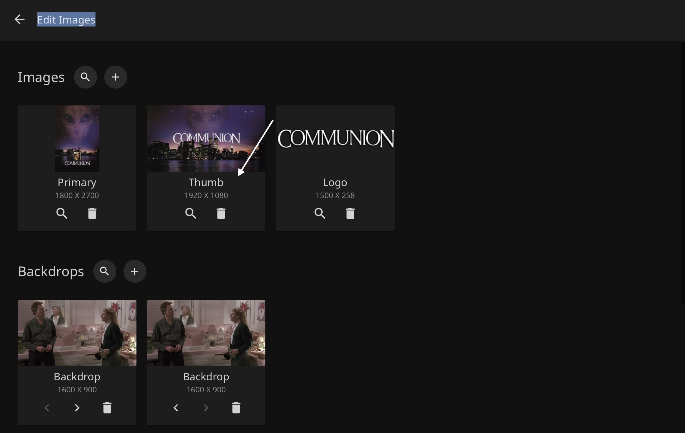

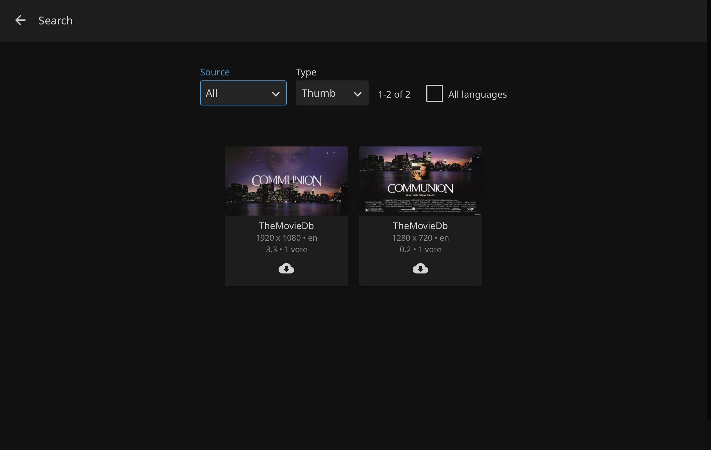

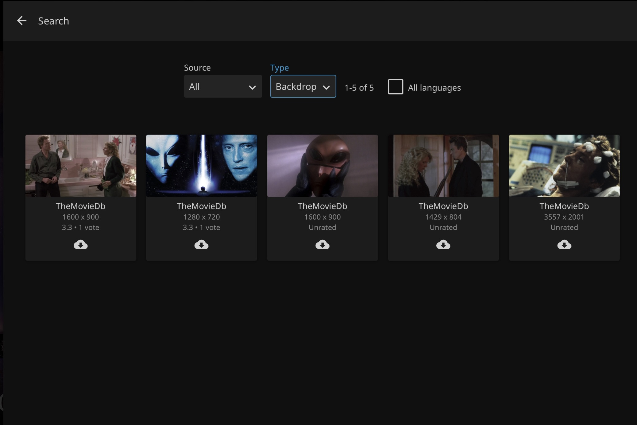

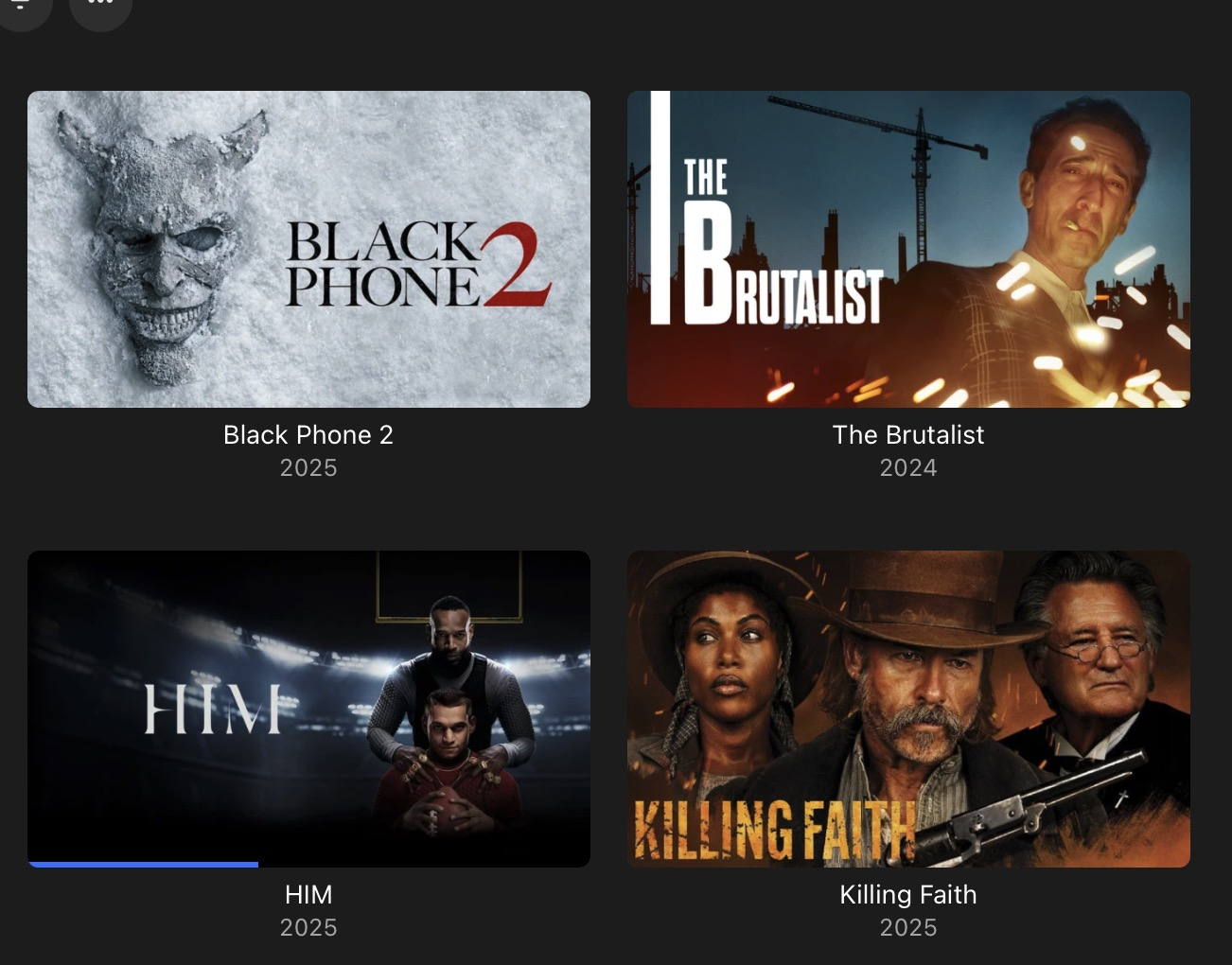

Blueskies278 43 Posted November 13, 2025 Author Posted November 13, 2025 (edited) 5 hours ago, Luke said: How do we know if it has text? if it has a language filled out that isn't xx ? The downside of this is that these images really are inferior to fanart. When you prioritize your image providers, it can only be done for all images, not for each image type specifically. So if we add this then that will become an issue. MovieDb is prioritized higher by default, so all of a sudden this gets enabled, and many users will start getting images that are sometimes junky compared to fanart. No worries, I can understand the quality issues. Personally, I've never had any image quality issues 99% of the time. Really, it's not an issue. I get Kodi or jellyfin to download my desired artwork to the folders. Emby is still the best media player Jellyfin is slightly more advanced by categorising artwork image options with TMDB. menu options Backdrop For me, personally, the thumb view looks good The thumb view is so scaled down to fit, it still looks good on my 65 inch OLED TV. Edited November 13, 2025 by Blueskies278
Happy2Play 9814 Posted November 13, 2025 Posted November 13, 2025 (edited) 10 hours ago, Luke said: How do we know if it has text? if it has a language filled out that isn't xx ? The downside of this is that these images really are inferior to fanart. When you prioritize your image providers, it can only be done for all images, not for each image type specifically. So if we add this then that will become an issue. MovieDb is prioritized higher by default, so all of a sudden this gets enabled, and many users will start getting images that are sometimes junky compared to fanart. Was thinking maybe the all language switch to show them but that could be a mess also. Not sure on quality as they will be 720/1080, but really will only apply to something older anyways. Newer ones will/can end up being the same image as fanart. Edited November 13, 2025 by Happy2Play 1
Luke 42287 Posted November 13, 2025 Posted November 13, 2025 Our image editor has those same options. In fact, they got it from us.
Blueskies278 43 Posted November 13, 2025 Author Posted November 13, 2025 (edited) 3 hours ago, Luke said: Our image editor has those same options. In fact, they got it from us. Ah, so only difference is that Jellyfin is a bit more advanced/flexible? Kodi also shares the same flexibility. Edited November 13, 2025 by Blueskies278
