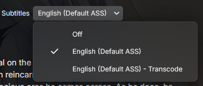

Hmm - then could something like the following be implemented?
Then people can select if they want to use the default handling or if they want to force transcoding.
Or maybe read the tags and if there is a specific tag (e.g. force-subtitle-transcode) then force transcoding of the subtitles?
