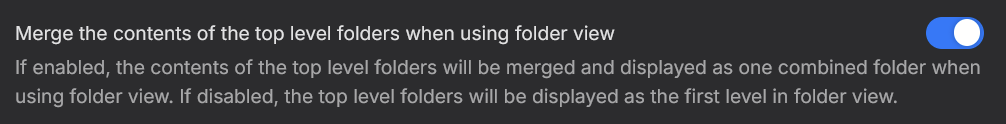

tedfroop21 89 Posted November 9, 2025 Posted November 9, 2025 When this is off and there are multiple folders in the top level of the library, "are you still watching?" does not function normally. Once I turned it on - "are you still watching?" resumed normal functioning. Played 6 episodes of one show with no prompts, turned it on and played three of another and was prompted. embyserver-63898243199.txt
ebr 16332 Posted November 9, 2025 Posted November 9, 2025 That has to be a coincidence... Can you repeat the problem? That setting would have no impact on TV Series.

tedfroop21 89 Posted November 10, 2025 Author Posted November 10, 2025 (edited) On 09/11/2025 at 09:52, speechles said: When you initially make the playback request or when you press a key on the remote the time since last keypress is updated. Once the next item has started and 3500 seconds has passed since that time since last keypress it will spawn the are you still watching dialog. Perhaps you were pressing keys all the time on the remote this time? Half asleep, started playing episode 1, stopped it during episode 6 when I woke up. These are 1965 episodes with 25-26 min. run time. Tried it with a different series with the same result. On 09/11/2025 at 09:26, ebr said: That has to be a coincidence... Can you repeat the problem? That setting would have no impact on TV Series. The TV library is split across 2 disks, so there are 2 folders, on 2 disks that make up the library. With the switch off and two library folders showing (TV and TV2), it plays on well past the usual 3-4 episodes. With the library showing as one folder, it behaves normally. Edited November 10, 2025 by tedfroop21
