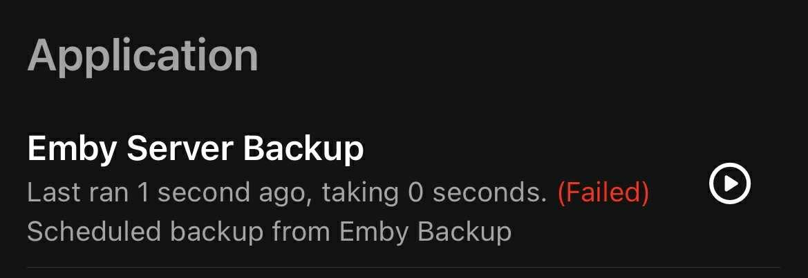

will_i_am_small 0 Posted November 11, 2025 Author Posted November 11, 2025 2 minutes ago, Luke said: Hi, have you checked out our backup guide? Backup & Restore I have tried but the plugin has never worked for me. Always immediately hitting and error - Hence why I was manually downloading metadata a29be40c-9875-4ba1-92a7-edad6501ab19.jfif fad8eb72-c095-4648-a16d-3da05b9e0a72.jfif
Happy2Play 9811 Posted November 11, 2025 Posted November 11, 2025 12 hours ago, will_i_am_small said: I have tried but the plugin has never worked for me. Always immediately hitting and error - Hence why I was manually downloading metadata a29be40c-9875-4ba1-92a7-edad6501ab19.jfif 98.38 kB · 0 downloads fad8eb72-c095-4648-a16d-3da05b9e0a72.jfif 25.38 kB · 0 downloads Would need to see the server log to see why it failed.
Luke 42239 Posted November 11, 2025 Posted November 11, 2025 17 hours ago, will_i_am_small said: I have tried but the plugin has never worked for me. Always immediately hitting and error - Hence why I was manually downloading metadata a29be40c-9875-4ba1-92a7-edad6501ab19.jfif 98.38 kB · 1 download fad8eb72-c095-4648-a16d-3da05b9e0a72.jfif 25.38 kB · 1 download Hi there, please attach the Emby server log from when the problem occurred: How to Report a Problem Thanks!
will_i_am_small 0 Posted November 12, 2025 Author Posted November 12, 2025 embyserver.txt I attempted to run the backup and then downloaded the log
Neminem 1621 Posted November 12, 2025 Posted November 12, 2025 It looks like permission issues. System.UnauthorizedAccessException: System.UnauthorizedAccessException: Access to the path '/volume1/Stuff/Emby/Backup/embyserver-backup-full' is denied. ---> System.IO.IOException: Permission denied 1
