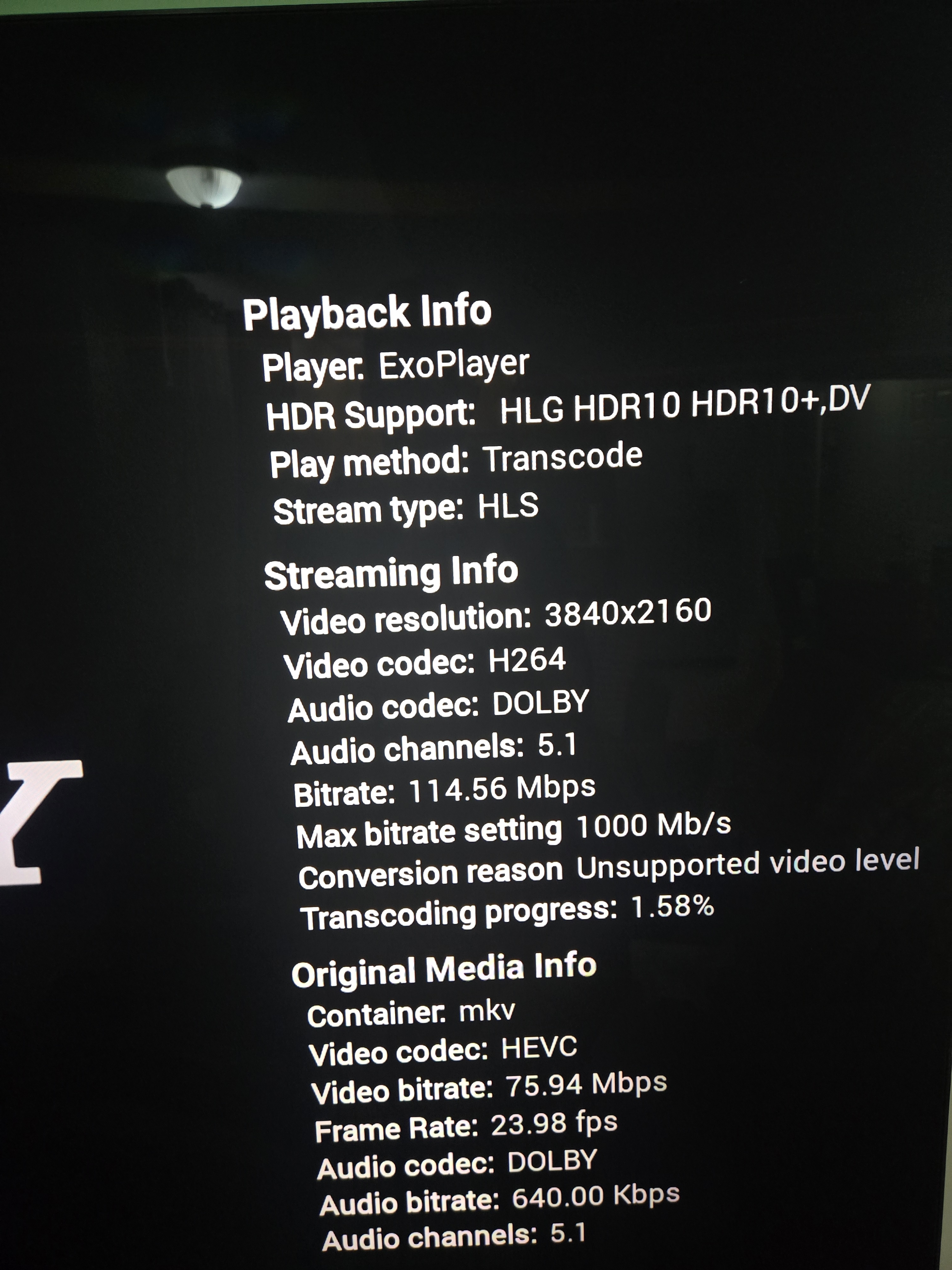

i_singh1 0 Posted November 9, 2025 Author Posted November 9, 2025 Hey, I found the problem! When I try to play movies through the Android TV app, it works better, but some movies say "video level not supported" and transcode. But when I use the Emby for Android app and play the same file, it direct plays but pauses every few moments.

FrostByte 5454 Posted November 9, 2025 Posted November 9, 2025 (edited) The Firestik doesn't support HEVC Main 10 Level 5.2 which is why it's being transcoded and playing better in the one. https://developer.amazon.com/docs/device-specs/device-specifications-fire-tv-streaming-media-player.html Edited November 9, 2025 by FrostByte

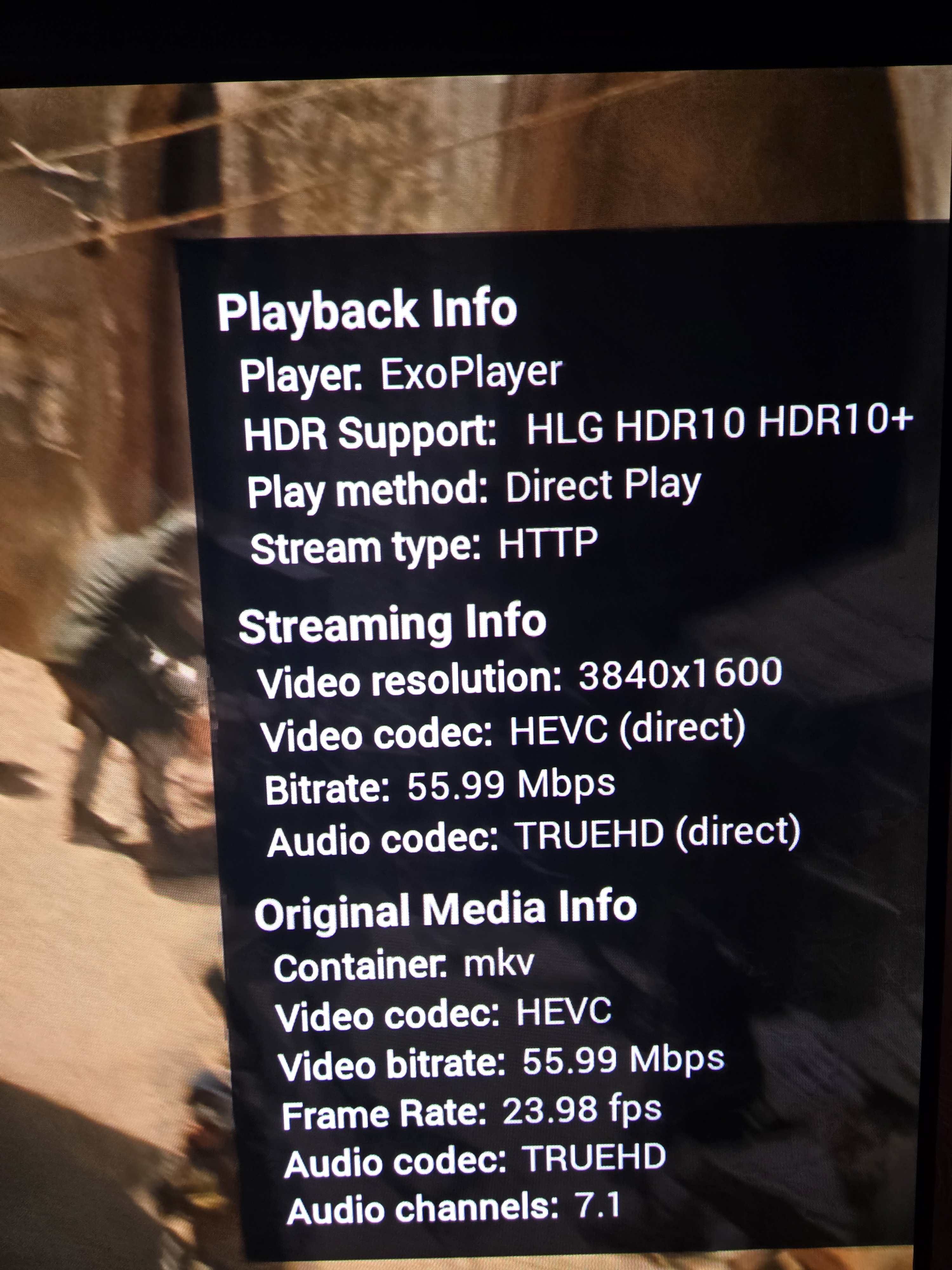

i_singh1 0 Posted November 9, 2025 Author Posted November 9, 2025 The screenshots I sent are from my Google TV. My Firestick is direct playing movies, but it keeps buffering.
FrostByte 5454 Posted November 9, 2025 Posted November 9, 2025 (edited) Correct, but it probably should be transcoded on the Firestik as 5.2 isn't supported and could be why it's choppy. Edited November 9, 2025 by FrostByte

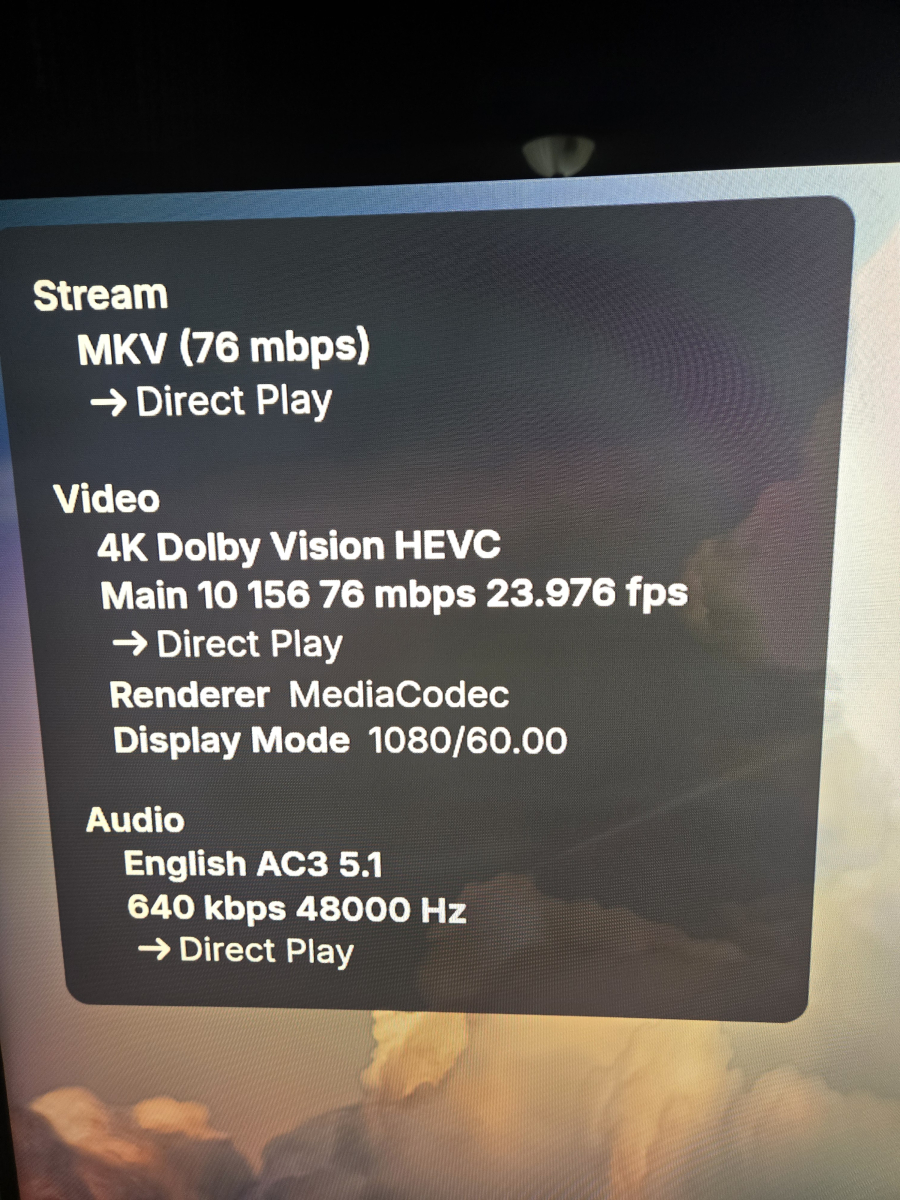

i_singh1 0 Posted November 9, 2025 Author Posted November 9, 2025 Here is a picture of file being played at firestick.
ebr 16336 Posted November 9, 2025 Posted November 9, 2025 Those are different items. Can you test with the exact same content? Still, very likely a bandwidth issue. 1
