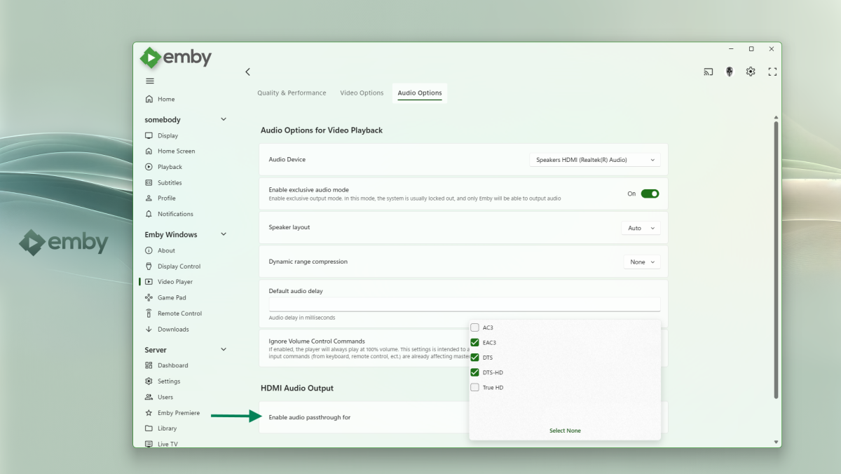

softworkz 5133 Posted November 10, 2025 Posted November 10, 2025 4 hours ago, Bob1969 said: It does indeed have surround sound going to the receiver, I have not been using my surround set up for 18 months, i am now discovering the ideal option of passthrough has gone in this newer version. It hasn't gone. I was just asking about your use cases because everybody has learned in the past that passthrough is the best option - because it was like that indeed. In earlier days, it wasn't possible to transport uncompressed multi-channel PCM audio over HDMI, so the only choices were: either compressed or just 2-channel audio. When the audio in your media was compressed in a format that your receiver can decode, then it was obviously the best option to the reicver decode it, because the compressed signal could go through HDMI, while uncompressed couldn't, so it didn't make sense to let the player decode it in the first place. But many videos have AAC encoded multi-channel audio and hardly any receiver can decode that, so the video player had to decode it. But then, in order to send it over HDMI, the player had to re-compress it as AC-3. And that's bad, even through people were often thinking that it would be a good thing when they are getting AC-3 audio in "passtrhough" mode - which it isn't. AC-3 highly compressed and much worse than AAC. Nowadays, where uncompressed multichannel PCM can be sent over HDMI, this is clearly the better way. 4 hours ago, Bob1969 said: Isn't passthrough the highest quality option and to let my expensive receiver do the decoding? No. The only cases where it makes sense (at the moment) are Atmos and DTS:X - but only because software implementations are incomplete due to the specs being kept private and not everything has been reverse-engineered yet. In these two cases, you better let your receiver or TV do the decoding. But apart from those special cases, it is a misconception that receivers - no matter how expensive - would be better. It's the other way round: Hifi receivers are not computers. They are using discrete chips, asiscs or similar hardware implementations which don't have the same capabilities like a modern CPU which can do floating point operations at high precision with ease, while those hardware implementations always have to make compromises in their implementations. I cannot tell you how big the differences are practically, but what is very clear is that when the algorithms are known and you implement them both, in software and then for hardware, the hardware implementation can NEVER BE BETTER. The best possible achievement is to be equal - which is even rather unlikely. The important capabilities of a Hifi reeiver are rather in D/A conversion and all the analog circuits. On the digital side, there's nothing to be excited about in case of those receivers. 4 hours ago, Bob1969 said: This is a nightmare as i cant tell what format is being received as there are many different surround formats. Emby used to have passthrough. During playback, press the gear icon and choose "stats for nerds", this shows you exactly what you want to know. Finally, passthrough is still there, but it shows only when an HDMI audio output is selected: 1

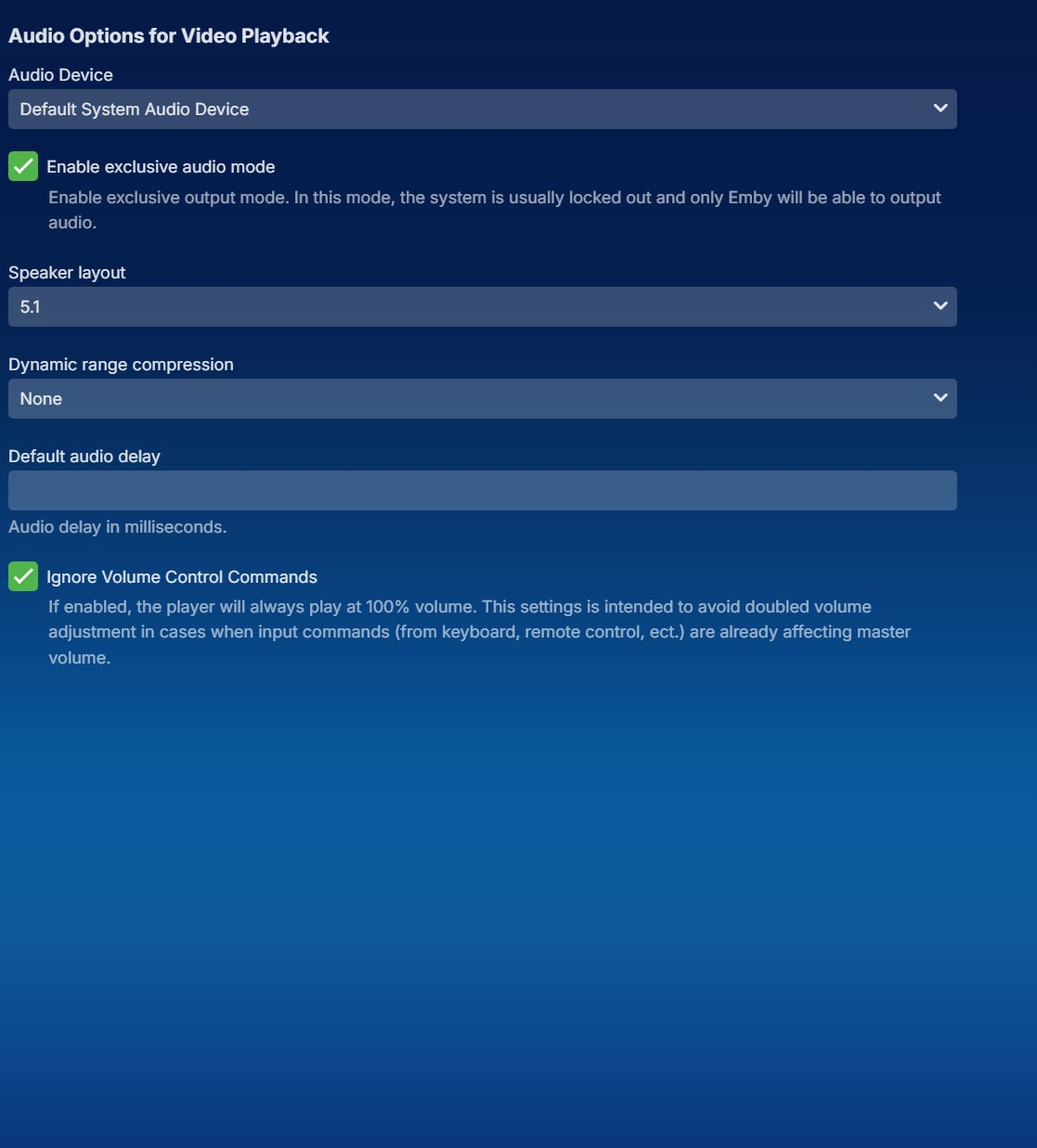

Bob1969 6 Posted November 11, 2025 Author Posted November 11, 2025 @softworkzmany thanks indeed for your very interesting post, i read it all however some of it was over my head. Im using a gaming pc / htpc. As i mentioned the HDMI audio output is not there and as a result no passthrough options, see below.
Solution Lessaj 484 Posted November 11, 2025 Solution Posted November 11, 2025 What devices are available in the drop down? If the HDMI is there you can select it and that should enable the options to appear. 1 1

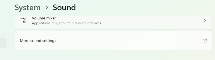

softworkz 5133 Posted November 11, 2025 Posted November 11, 2025 6 minutes ago, Bob1969 said: As i mentioned the HDMI audio output is not there What do you mean by "not there"? What does the list show when opening? Also, at Windows settings, what do you see when you clilck on "More sound settings" in the playback list that you will see then? When you rtight-click your hdmi output there, do you see a "Configure Speakers" item? Also, double-click and show the 1s and 2nd tab pages. 1
Bob1969 6 Posted November 11, 2025 Author Posted November 11, 2025 @LessajIs spot on i need to select a device to get the passthrough options, now its working fine and my receiver is displaying the correct surround formats . Having it set at default sound device means this setting is hidden. 1

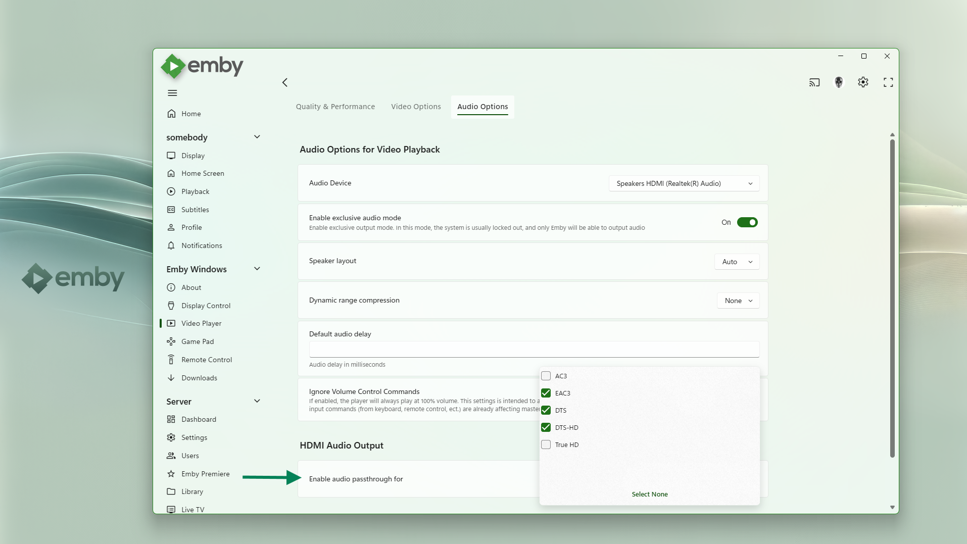

softworkz 5133 Posted November 11, 2025 Posted November 11, 2025 (edited) 7 minutes ago, Bob1969 said: i need to select a device to get the passthrough options, now its working fine and my receiver is displaying the correct surround formats . Having it set at default sound device means this setting is hidden. Which is what I had said above already: On 11/10/2025 at 1:55 AM, softworkz said: Finally, passthrough is still there, but it shows only when an HDMI audio output is selected: But I'm glad to hear that it's resolved for you! Edited November 11, 2025 by softworkz 1 1
