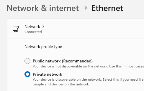

Pomah 2 Posted November 9, 2025 Author Posted November 9, 2025 When I go to "Network & internet > Ethernet" screen, it states I am not connected. I also do not see how to "connect" it. I am attaching a sceenshot of that screen to show you. I am not super tech-savvy, so I may have missed obvious things. I do really appreciate the help you are providing! Pomah L. Ethernet Screen.pdf
Lessaj 477 Posted November 9, 2025 Posted November 9, 2025 (edited) You mentioned it's a desktop but you're not using ethernet? Are you using wifi instead? While not ideal since ethernet is best for a server it will still work, and it has a similar network type setting. Edited November 9, 2025 by Lessaj
Pomah 2 Posted November 10, 2025 Author Posted November 10, 2025 Sorry, I didn't mention that I was connecting via Wi-Fi. I didn't think it was important (now I know). When I went to the "Network & internet > Wi-Fi" screen and checked the network type, it was set to Public. I changed it to Private, my client app instantly connected! Thanks pwhodges and Lessaj for your assistance. It is much appreciated! Pomah L. 2
