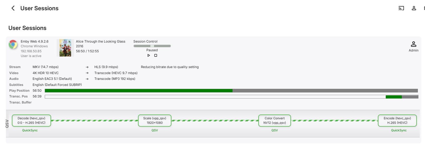

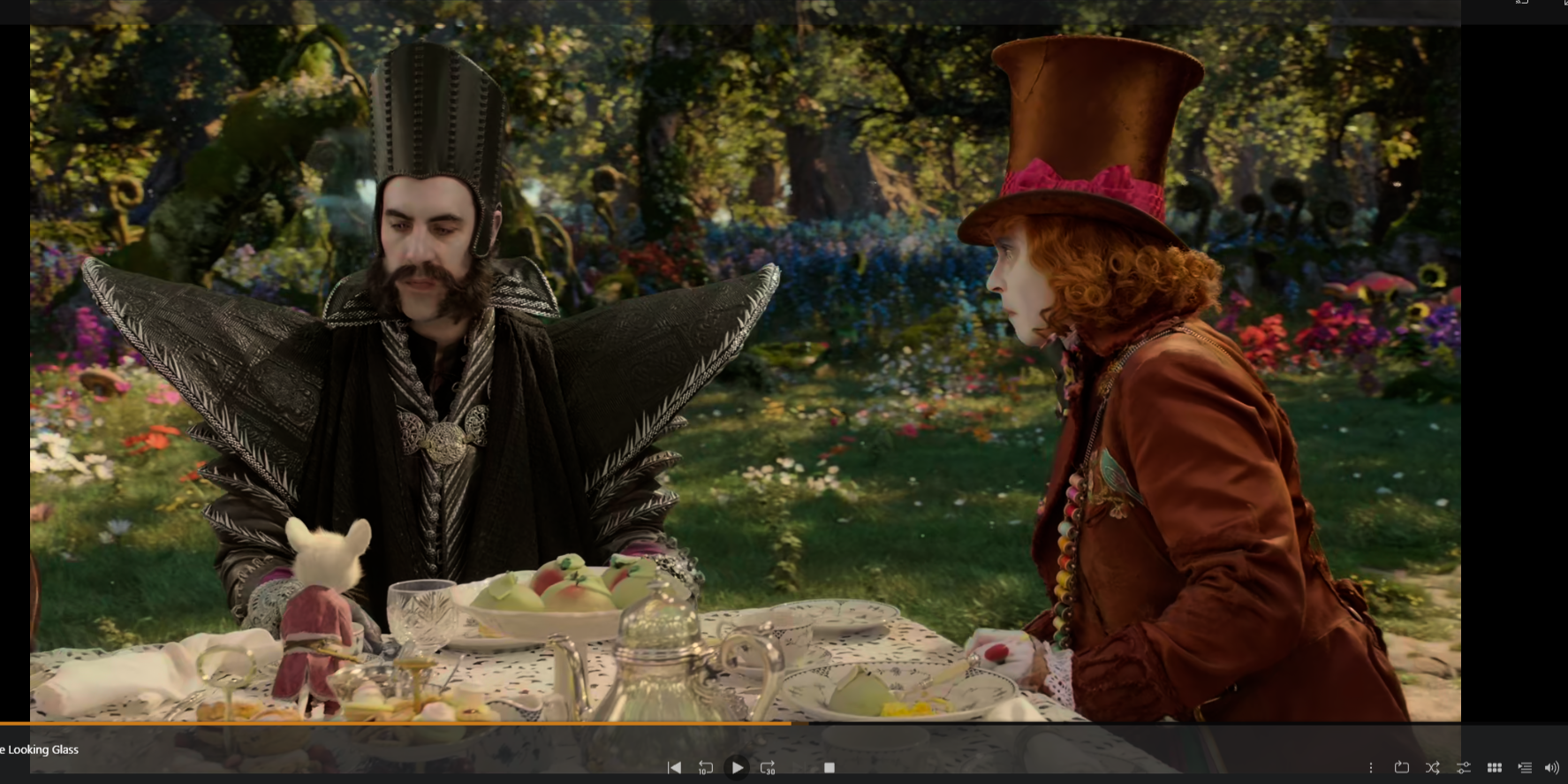

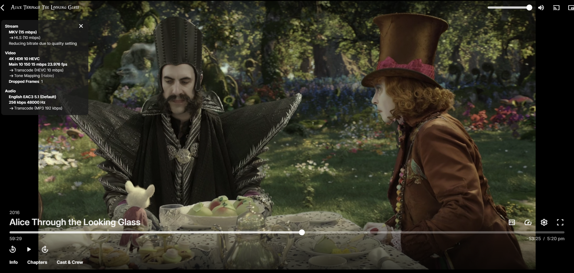

Emby: Set as 10 Mbps (No Direct Play)image.thumb.png.1fa696bf2689c348d0dbafb5e729f5f5.png
Plex: Set as 10 Mbps (No Direct Play)image.thumb.png.a86bc37a7e0b2c1a0d9e67cdb2bd772d.png

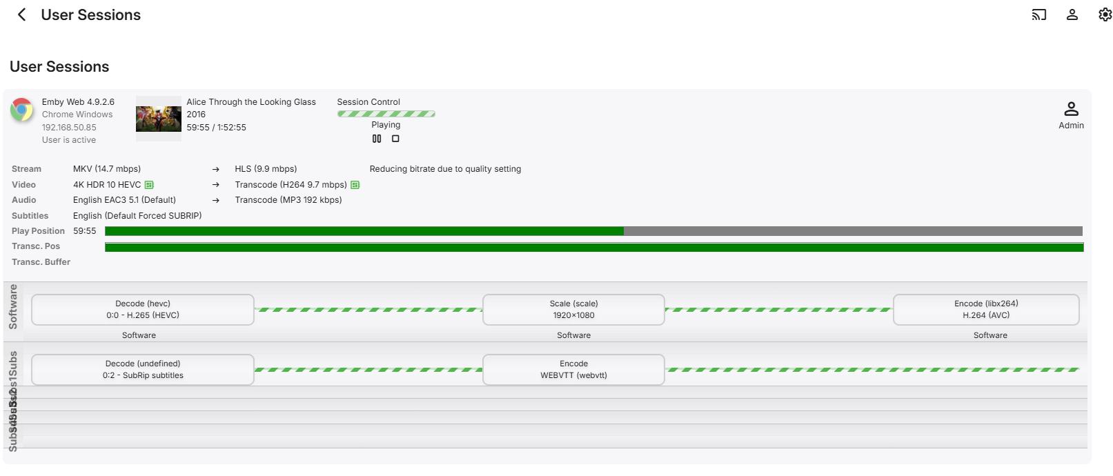

Have you tried using difefrent algorithm, i.e. Mobius and see how does it compare?
Edit: Also, if you disable experimental HEVC encoding and transcode to AVC, are you getting same results?

I've disabled experimental HEVC encoding and tried changing the tone mapping algorithm from Hable to Mobius - still washed out colors. Then I tried Reinhard and still no improvement.

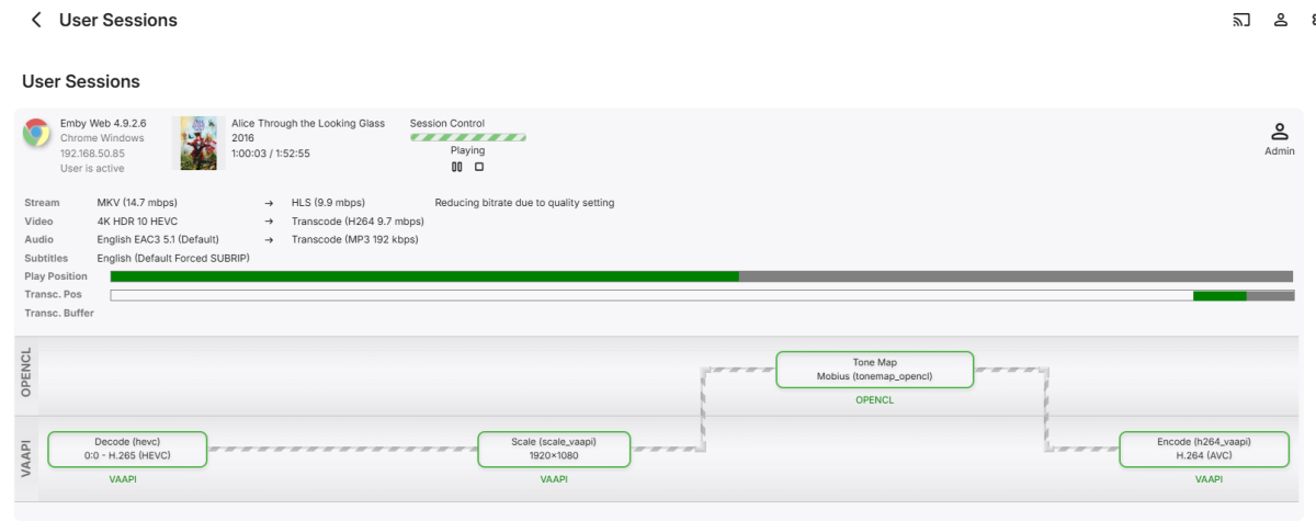

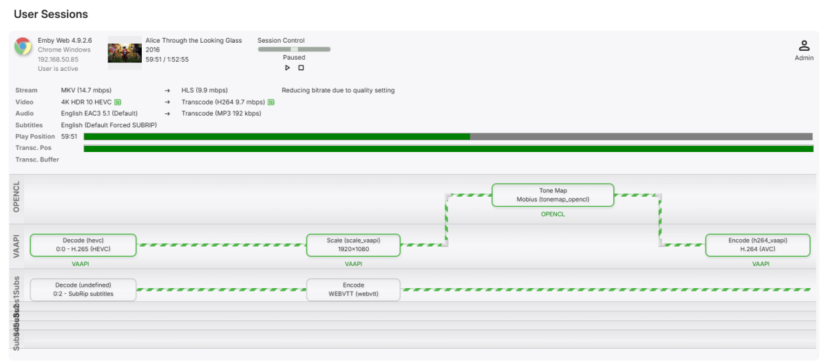

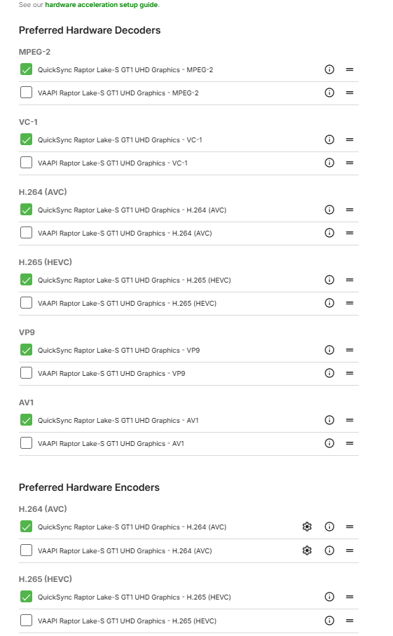

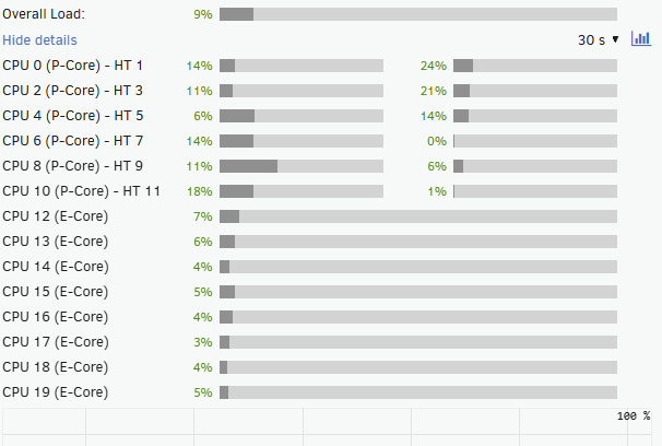

Update 2:

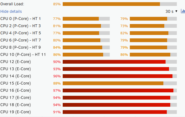

I tried moving VAAPI to the top of the hardware acceleration list and enabled "VAAPI HW Tone Mapping." This fixed the color issues, but the video looked blocky/pixelated and my CPU would spike to 100%.

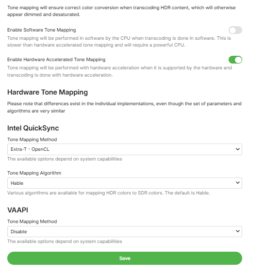

Then I changed it to "Extra-T - OpenCL" which didn't use any CPU power, but the colors are still washed out.
VAAPI HW Tone Mapping: ON
VAAPI HW Tone Mapping: Extra-T - OpenCL
VAAPI HW Tone Mapping: Extra-T - OpenCLimage.thumb.png.1360a857aef3057e49b104c4f7011176.png

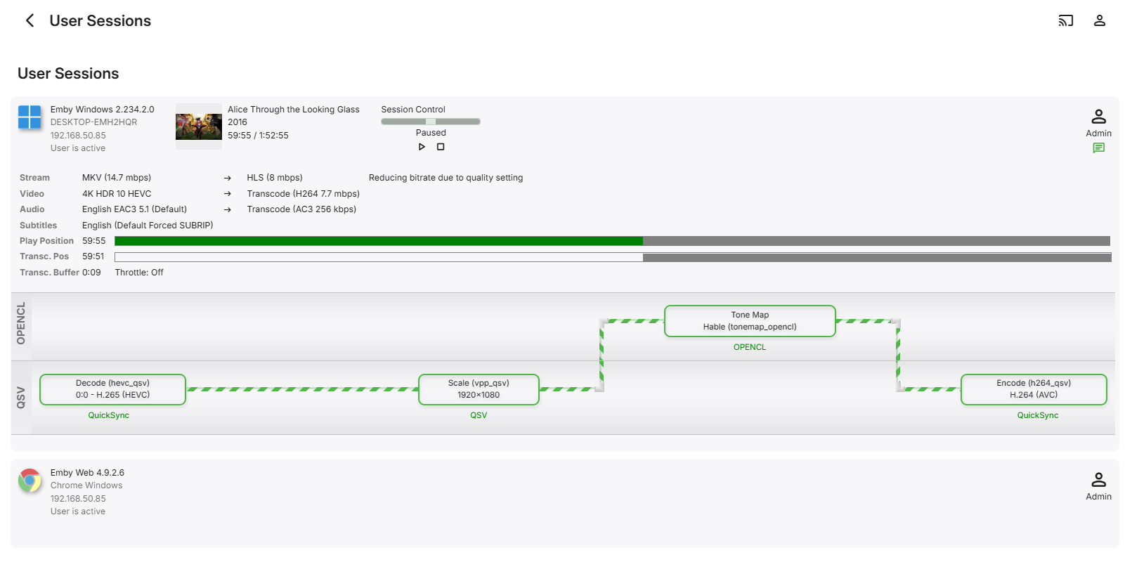

Update 3:
I tried playing the same video in the Emby app from the Windows Store, and the colors are working correctly! Plex still looks slightly better due to darker/richer colors, but the Emby Windows app is manageable and much better than Chrome.
I'm not sure why Chrome is washing out the colors when the Windows app displays them properly?
For my settings, I'm only using QuickSync (not VAAPI) with the Hable tone mapping algorithm. I tried the other algorithms ( mobius, reinhard) but they're all too bright.
