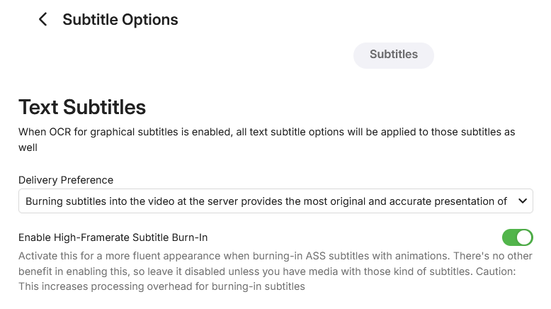

guunter 49 Posted November 8, 2025 Posted November 8, 2025 7 hours ago, redybr said: Hi everyone, my Emby server is on TrueNAS Scale, and it's generally working well, but I'm having trouble with ASS subtitles; they don't play in the browser, only in the Android app, for example. I'll attach the log. ffmpeg-transcode-e6673968-3c9e-424b-a1d0-27f24ee832db_1.txt 51.54 kB · 1 download embyserver.txt 434.82 kB · 2 downloads In transcoding turn off subtitle extraction on the fly. This should force the server to burn the subtitles. You may also need to install the diagnostic plugin to get the Subtitle Options in the admin menu. I'd set it to this.

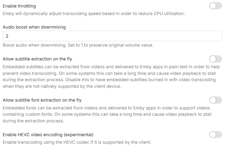

MediaEmby1968 54 Posted November 10, 2025 Posted November 10, 2025 I also had problems with ASS subtitles (which are the ones I use). These days they work fine without transcoding. I have them set up as external subtitles, not embedded in the file (I think, but I'm not entirely sure, that's what was causing the transcoding and the freeze). In the settings, under the transcoding section, there's a link that says something like "Allow subtitle extraction on the fly." I have it unchecked.

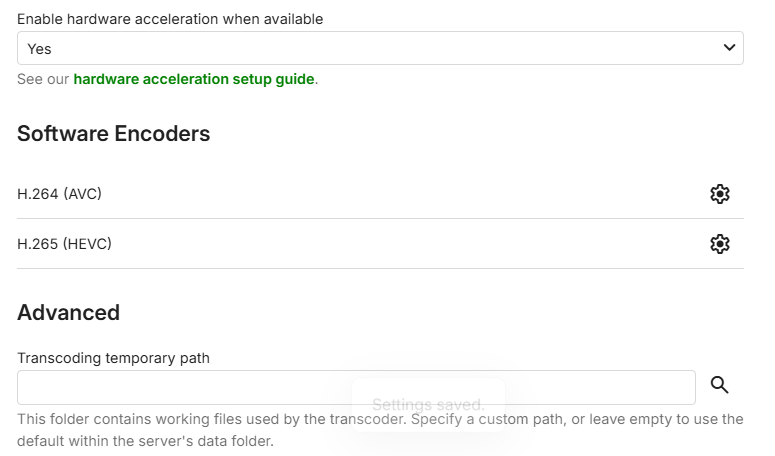

redybr 0 Posted November 10, 2025 Author Posted November 10, 2025 2 minutes ago, MediaEmby1968 said: I also had problems with ASS subtitles (which are the ones I use). These days they work fine without transcoding. I have them set up as external subtitles, not embedded in the file (I think, but I'm not entirely sure, that's what was causing the transcoding and the freeze). In the settings, under the transcoding section, there's a link that says something like "Allow subtitle extraction on the fly." I have it unchecked. So, my subtitles are embedded, but I haven't been able to get them to work in the browser yet; they only work in the Android app. Here are some photos of the settings.
MediaEmby1968 54 Posted November 10, 2025 Posted November 10, 2025 I watch the videos on my TV; I've never watched them on my PC. I don't know if it was malfunctioning before because I don't watch anything on my PC. Your settings are the same as mine. It's clearly a subtitle issue. I would try extracting the subtitle file and setting it as an external file to see if that works. Make sure to disable embedded subtitles first.
guunter 49 Posted November 10, 2025 Posted November 10, 2025 8 hours ago, redybr said: So, my subtitles are embedded, but I haven't been able to get them to work in the browser yet; they only work in the Android app. Here are some photos of the settings. Yeah it looks like mine but unsure how it works with out premiere. It should use the CPU anyways (software transocding) for the subs.
