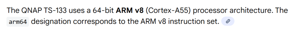

Luke 42239 Posted November 7, 2025 Posted November 7, 2025 What architecture is the TS-133? The arm64 download may not have been the right one.
buky55 2 Posted November 7, 2025 Author Posted November 7, 2025 I don't know what architecture is ts-133. I downloaded armv8 version and installed again. It's working, for now. What das it mean. No digital signature?
sa2000 696 Posted November 7, 2025 Posted November 7, 2025 4 minutes ago, buky55 said: I don't know what architecture is ts-133 You have the correct package 5 minutes ago, buky55 said: What does it mean. No digital signature? That is fine. All QNAP apps not in the QNAP store have no digital signature We are working on getting the store version updated. Meanwhile, it should be ok to manually install the packages available here Emby Server for QNAP NAS Downloads
