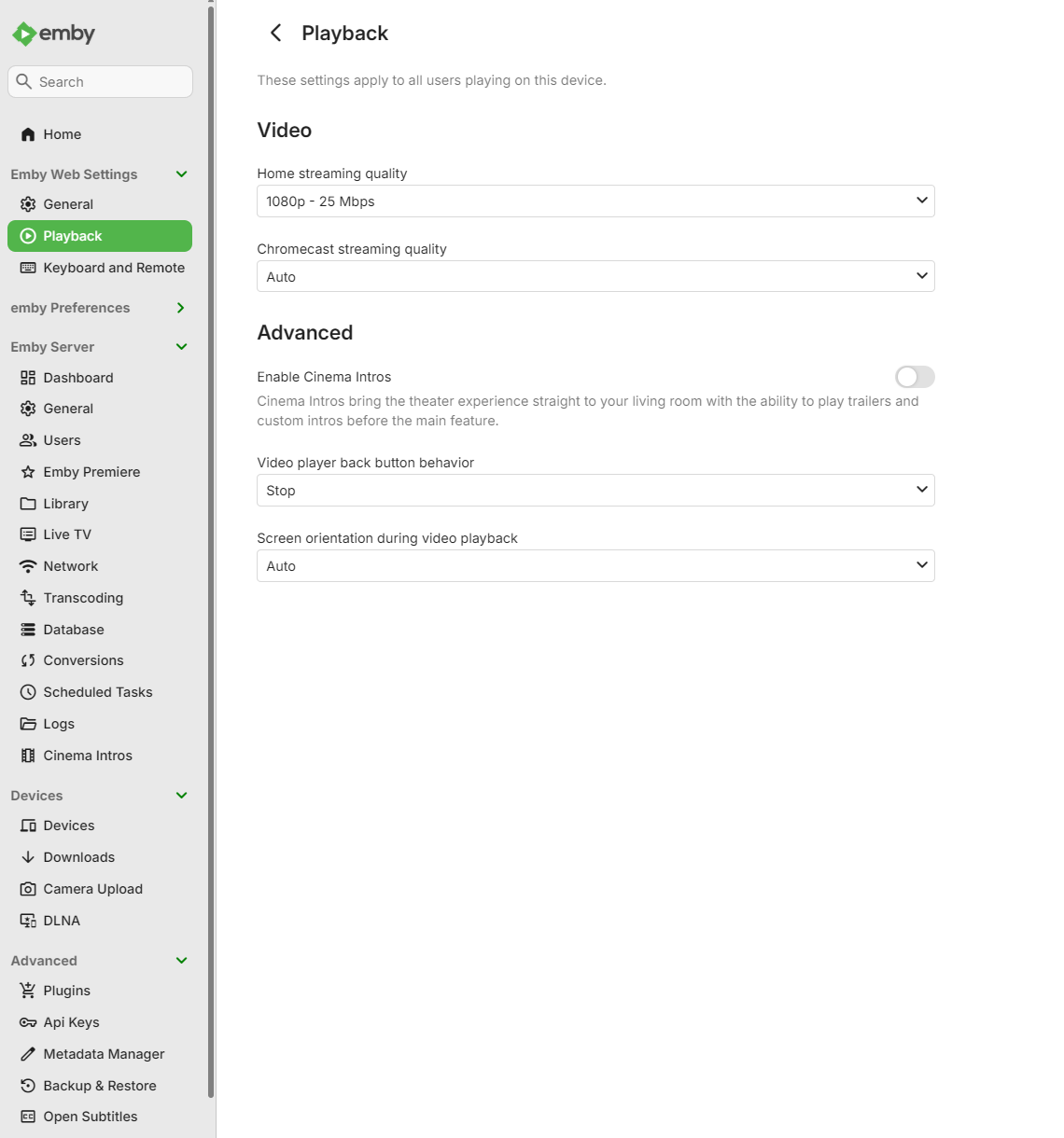

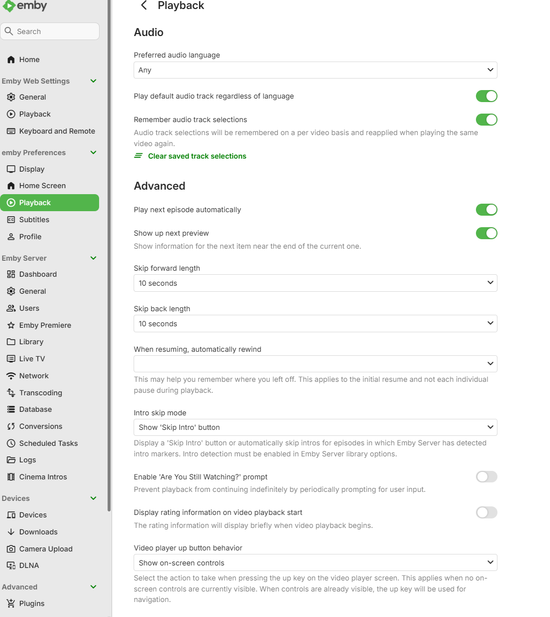

JJKOM 1 Posted November 13, 2025 Author Posted November 13, 2025 I don't find that setting you refer to, there is these two "Playback" items in settings:
Neminem 1619 Posted November 13, 2025 Posted November 13, 2025 2 hours ago, Luke said: Third: Please let us know if this helps. Thanks. This is found in emby admin UI under users. 1
