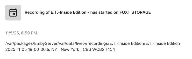

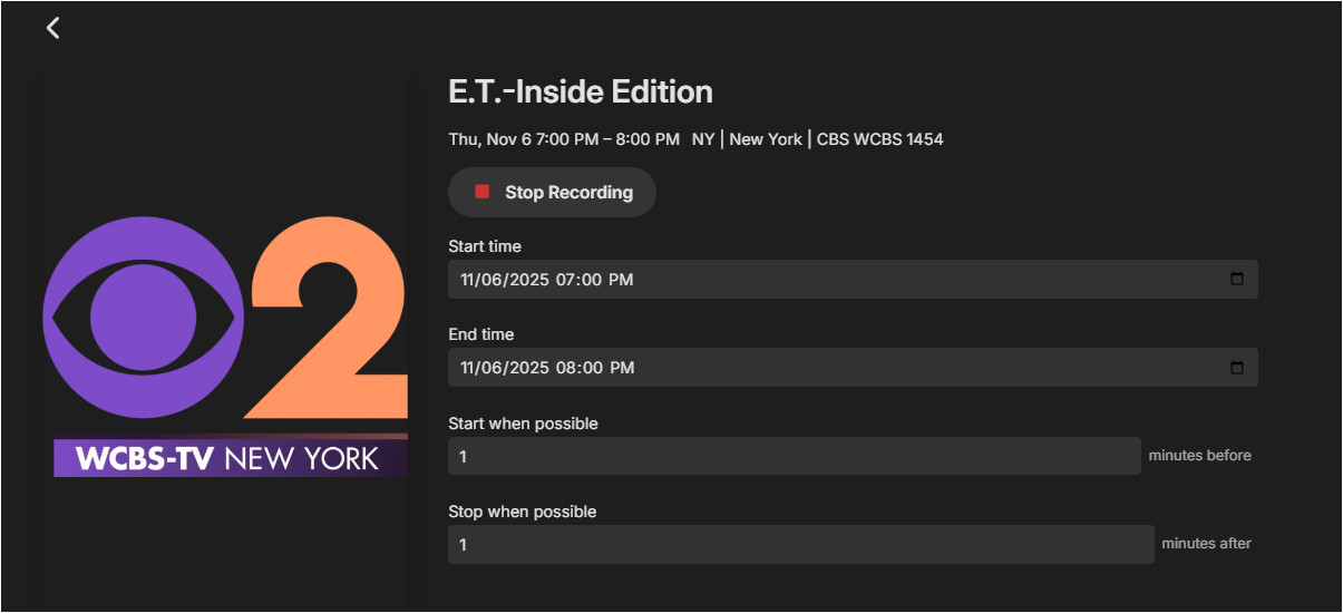

GaryG 5 Posted November 6, 2025 Posted November 6, 2025 (edited) I have a scheduled series recording that should run from 7PM Eastern to 8PM Eastern. For some reason, the recording stops before the scheduled end time. I have deleted and recreated the schedule repeatedley. Ive tried breaking it up into two shows since it is, two shows, and that resulted in one of the recordings being alot shorter (Terminatin earlier) than it should be. Im usually pretty gopod at figuring tech things out, but this has me scratching my head. Attached below are three screenshots and a log excerpt from around the time the recording terminated. Any thoughts on why this may be happening? It seem to happen with these two shows only around the same time every day. I'ts so weird. I suspect it my be an issue with the stream, the provider, but Im not sure. log.txt Edited November 6, 2025 by GaryG Spelling
