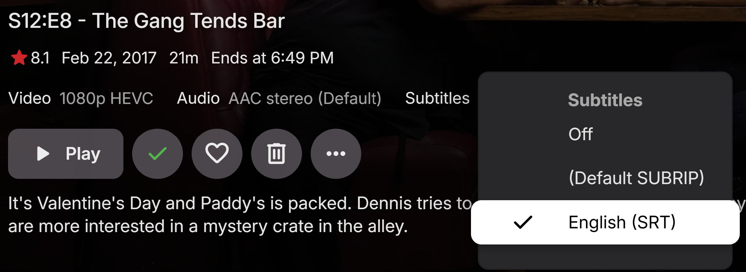

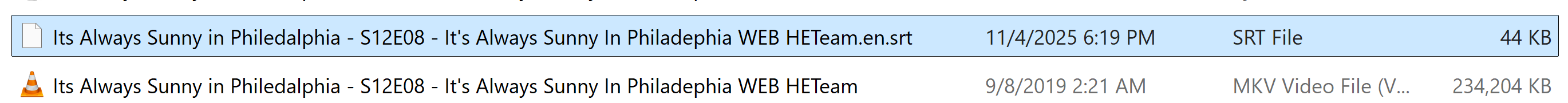

JGelps 0 Posted November 4, 2025 Author Posted November 4, 2025 @GrimReaper there is an edit option for subtitles where you can pick the language, default, forced, ect. For this specific example I am using It's Always Sunny Season 12 Episode 8. You can see the TinyMediaManager pic of it in the OP. As well as my Emby subtitle settings. I went and deleted the .srt that Emby downloaded, image attached. Then under that specific episode in Emby, I went to options -> Refresh Metadata -> Replace All. Which leads to that .srt being created again. Second screenshot shows what is in my subtitle drop down. It always defaults to English (SRT) which is the one that was downloaded. Maybe setting the embedded subtitles to English in TinyMediaManager isn't actually doing what Emby is looking for. Because I'd assume the Emby setting wasn't working originally because they did not have a language marked. But even marking the embedded language as english doesn't seem to work. Log is attached. I did try running the episode with the downloaded subtitles after deleting the .srt which causes an error. If you happen to see those in the log. embyserver.txt
Luke 42289 Posted November 5, 2025 Posted November 5, 2025 There's no language tag set on the subrip track so that's why this is happening. So I think the first step is getting that set right. Does TMM actually update the source video file with that info? I didn't know it had that feature. Maybe it just writes it to the nfo?
GrimReaper 4926 Posted November 5, 2025 Posted November 5, 2025 28 minutes ago, JGelps said: there is an edit option for subtitles where you can pick the language, default, forced, ect. That's why I asked you. That had only changed language tag in TMM db, it doesn't append file header. 1 minute ago, Luke said: Does TMM actually update the source video file with that info? It doesn't. 1
GrimReaper 4926 Posted November 5, 2025 Posted November 5, 2025 1 minute ago, Luke said: Thanks. So that answers that then. Yes. That was my initial suspicion, hence the original question. @JGelps, your embedded subs have no language tag, hence Emby is unaware there's your preferred language subtitles available and downloads them as per your settings. You'll need to edit those files with the tool of your choice (like this one) and tag your subtitles track accordingly.
JGelps 0 Posted November 5, 2025 Author Posted November 5, 2025 Shame TMM doesn't change the file then. I do have it writing nfo files in the format for Emby. But I guess that isn't enough. I'll try that tool. And I'm guessing according to other media I have it should end up saying 'English (SUBRIP)'. Never paid close enough attention to what they were named in the drop down. Will report back if it works. You guys are awesome thanks so much!
Luke 42289 Posted November 5, 2025 Posted November 5, 2025 Right Emby probes the file directly for media info. It does not get that data from the nfo file.
