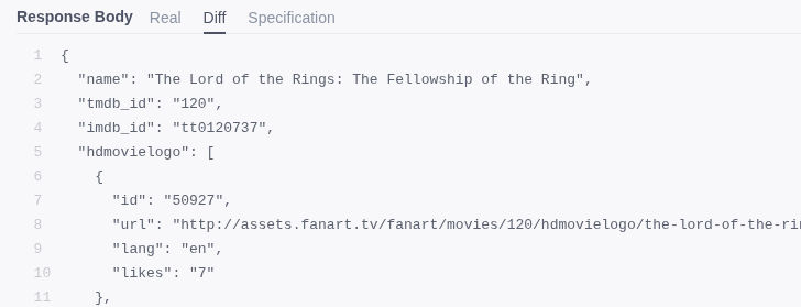

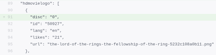

Lessaj 620 Posted November 4, 2025 Author Posted November 4, 2025 (edited) I was also attempting to use their example API calls with the API key in the logs and I can see a clear difference in the response between Production and Mock Server - Mock Server always seems to use this LOTR movie, so I made the same call when I did production. Production: Mock server: Edited November 4, 2025 by Lessaj

Happy2Play 9840 Posted November 4, 2025 Posted November 4, 2025 (edited) For visibility testing again on their new webservice server and back to same issue as shown above with api url Working "hdmovielogo": [ { "id": "439015", "url": "https://assets.fanart.tv/fanart/movies/1234821/hdmovielogo/jurassic-world-rebirth-6718196d2e01c.png", "lang": "en", "likes": "10" } Not Working "hdmovielogo": [{ "disc": "0", "id": "439015", "lang": "en", "likes": "10", "url": "jurassic-world-rebirth-6718196d2e01c.png" } Edited November 4, 2025 by Happy2Play
Happy2Play 9840 Posted November 4, 2025 Posted November 4, 2025 Should be resolved now. If you still have issues, it will most likely be Emby Cache needing to be cleared.

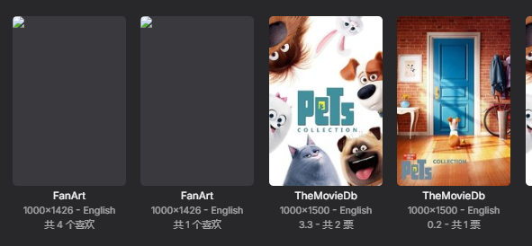

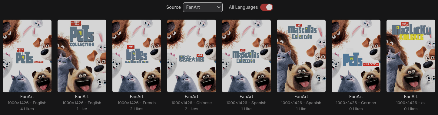

nickqi 1 Posted November 4, 2025 Posted November 4, 2025 Something is still worong but only effected in "Collections" and only part of collections. I tried to clicked the "Open in a new windows" button on the pic's right down corrner and compared the URL with the worked one and found the URL missed Farart address. Like the fowlling: http://xxx.mycloudnas.com:8096/emby/Images/Remote?api_key=xxxxxx&imageUrl=https%3A%2F%2Fassets.fanart.tv%2Ffanart%2Fmovies%2F87096%2Fmovieposter%2Favatar-collection-5d4cc3e258da9.jpg http://xxx.mycloudnas.com:8096/emby/Images/Remote?api_key=xxxxxx&imageUrl=the-secret-life-of-pets-collection-5d677fb25b095.png
nickqi 1 Posted November 4, 2025 Posted November 4, 2025 It showed " Invalid URI: The format of the URI could not be determined. But if I added the missed part in the URL and the picture could be loaded.
Happy2Play 9840 Posted November 4, 2025 Posted November 4, 2025 2 minutes ago, nickqi said: It showed " Invalid URI: The format of the URI could not be determined. But if I added the missed part in the URL and the picture could be loaded. All I can suggest is clearing the cache as I just tested your example without issue Spoiler { "hdmovieclearart": [{ "id": "268385", "lang": "en", "likes": "4", "url": "https://assets.fanart.tv/fanart/the-secret-life-of-pets-collection-5d662f63880c1.png" }, { "id": "295497", "lang": "fr", "likes": "2", "url": "https://assets.fanart.tv/fanart/the-secret-life-of-pets-collection-5e96cb8c380a7.png" }, { "id": "268493", "lang": "en", "likes": "1", "url": "https://assets.fanart.tv/fanart/the-secret-life-of-pets-collection-5d677f92938ef.png" }, { "id": "276574", "lang": "de", "likes": "1", "url": "https://assets.fanart.tv/fanart/the-secret-life-of-pets-collection-5dbf311f7c88a.png" }, { "id": "312863", "lang": "es", "likes": "0", "url": "https://assets.fanart.tv/fanart/the-secret-life-of-pets-collection-5f9427edd417f.png" }, { "id": "312864", "lang": "es", "likes": "0", "url": "https://assets.fanart.tv/fanart/the-secret-life-of-pets-collection-5f9427ef5280b.png" }, { "id": "332706", "lang": "cz", "likes": "0", "url": "https://assets.fanart.tv/fanart/the-secret-life-of-pets-collection-60917d6e4edcc.png" } ], "hdmovieclearart_count": 7, "hdmovielogo": [{ "id": "268384", "lang": "en", "likes": "4", "url": "https://assets.fanart.tv/fanart/the-secret-life-of-pets-collection-5d662087875c3.png" }, { "id": "405122", "lang": "zh", "likes": "2", "url": "https://assets.fanart.tv/fanart/the-secret-life-of-pets-collection-64f8703863e4b.png" }, { "id": "268494", "lang": "en", "likes": "1", "url": "https://assets.fanart.tv/fanart/the-secret-life-of-pets-collection-5d677fb25b095.png" }, { "id": "288096", "lang": "es", "likes": "1", "url": "https://assets.fanart.tv/fanart/the-secret-life-of-pets-collection-5e4ad5930c689.png" }, { "id": "268544", "lang": "fr", "likes": "0", "url": "https://assets.fanart.tv/fanart/the-secret-life-of-pets-collection-5d67eccaa65c4.png" }, { "id": "276627", "lang": "de", "likes": "0", "url": "https://assets.fanart.tv/fanart/the-secret-life-of-pets-collection-5dc066c9aae21.png" }, { "id": "332698", "lang": "cz", "likes": "0", "url": "https://assets.fanart.tv/fanart/the-secret-life-of-pets-collection-6091760896bff.png" } ], "hdmovielogo_count": 7, "imdb_id": "", "moviebackground": [{ "id": "268386", "lang": "", "likes": "6", "url": "https://assets.fanart.tv/fanart/the-secret-life-of-pets-collection-5d66396ea773a.jpg" }, { "id": "268492", "lang": "", "likes": "2", "url": "https://assets.fanart.tv/fanart/the-secret-life-of-pets-collection-5d677f5e338c0.jpg" } ], "moviebackground_count": 2, "moviebanner": [{ "id": "268387", "lang": "en", "likes": "4", "url": "https://assets.fanart.tv/fanart/the-secret-life-of-pets-collection-5d6639788dfc8.jpg" }, { "id": "268491", "lang": "en", "likes": "1", "url": "https://assets.fanart.tv/fanart/the-secret-life-of-pets-collection-5d677cddc28d7.jpg" }, { "id": "276576", "lang": "de", "likes": "1", "url": "https://assets.fanart.tv/fanart/the-secret-life-of-pets-collection-5dbf3429894d7.jpg" }, { "id": "288099", "lang": "es", "likes": "1", "url": "https://assets.fanart.tv/fanart/the-secret-life-of-pets-collection-5e4ad5c9cb80b.jpg" } ], "moviebanner_count": 4, "movieposter": [{ "id": "269086", "lang": "en", "likes": "4", "url": "https://assets.fanart.tv/fanart/the-secret-life-of-pets-collection-5d6f23ffd4d71.jpg" }, { "id": "294758", "lang": "fr", "likes": "2", "url": "https://assets.fanart.tv/fanart/the-secret-life-of-pets-collection-5e90358ae4d17.jpg" }, { "id": "405123", "lang": "zh", "likes": "2", "url": "https://assets.fanart.tv/fanart/the-secret-life-of-pets-collection-64f871b0bc887.jpg" }, { "id": "268495", "lang": "en", "likes": "1", "url": "https://assets.fanart.tv/fanart/the-secret-life-of-pets-collection-5d678071e748f.jpg" }, { "id": "288097", "lang": "es", "likes": "1", "url": "https://assets.fanart.tv/fanart/the-secret-life-of-pets-collection-5e4ad5a700bff.jpg" }, { "id": "288098", "lang": "es", "likes": "1", "url": "https://assets.fanart.tv/fanart/the-secret-life-of-pets-collection-5e4ad5b48cae2.jpg" }, { "id": "275649", "lang": "de", "likes": "0", "url": "https://assets.fanart.tv/fanart/the-secret-life-of-pets-collection-5db4a821072f3.jpg" }, { "id": "332712", "lang": "cz", "likes": "0", "url": "https://assets.fanart.tv/fanart/the-secret-life-of-pets-collection-6091828a9cba5.jpg" } ], "movieposter_count": 8, "moviethumb": [{ "id": "268388", "lang": "en", "likes": "4", "url": "https://assets.fanart.tv/fanart/the-secret-life-of-pets-collection-5d66398546e2b.jpg" }, { "id": "267167", "lang": "en", "likes": "2", "url": "https://assets.fanart.tv/fanart/-5d52cfad8c3e4.jpg" }, { "id": "288100", "lang": "es", "likes": "1", "url": "https://assets.fanart.tv/fanart/the-secret-life-of-pets-collection-5e4ad5da5ceb6.jpg" }, { "id": "276575", "lang": "de", "likes": "0", "url": "https://assets.fanart.tv/fanart/the-secret-life-of-pets-collection-5dbf3263373c1.jpg" }, { "id": "332707", "lang": "cz", "likes": "0", "url": "https://assets.fanart.tv/fanart/the-secret-life-of-pets-collection-60917d94343aa.jpg" }, { "id": "332708", "lang": "cz", "likes": "0", "url": "https://assets.fanart.tv/fanart/the-secret-life-of-pets-collection-60917d95909cd.jpg" } ], "moviethumb_count": 6, "name": "The Secret Life of Pets Collection", "tmdb_id": "427084" }
Lessaj 620 Posted November 4, 2025 Author Posted November 4, 2025 Make sure to remove the cache folders for fanart, seems fine to me.
nickqi 1 Posted November 4, 2025 Posted November 4, 2025 5 minutes ago, Happy2Play said: All I can suggest is clearing the cache as I just tested your example without issue Reveal hidden contents { "hdmovieclearart": [{ "id": "268385", "lang": "en", "likes": "4", "url": "https://assets.fanart.tv/fanart/the-secret-life-of-pets-collection-5d662f63880c1.png" }, { "id": "295497", "lang": "fr", "likes": "2", "url": "https://assets.fanart.tv/fanart/the-secret-life-of-pets-collection-5e96cb8c380a7.png" }, { "id": "268493", "lang": "en", "likes": "1", "url": "https://assets.fanart.tv/fanart/the-secret-life-of-pets-collection-5d677f92938ef.png" }, { "id": "276574", "lang": "de", "likes": "1", "url": "https://assets.fanart.tv/fanart/the-secret-life-of-pets-collection-5dbf311f7c88a.png" }, { "id": "312863", "lang": "es", "likes": "0", "url": "https://assets.fanart.tv/fanart/the-secret-life-of-pets-collection-5f9427edd417f.png" }, { "id": "312864", "lang": "es", "likes": "0", "url": "https://assets.fanart.tv/fanart/the-secret-life-of-pets-collection-5f9427ef5280b.png" }, { "id": "332706", "lang": "cz", "likes": "0", "url": "https://assets.fanart.tv/fanart/the-secret-life-of-pets-collection-60917d6e4edcc.png" } ], "hdmovieclearart_count": 7, "hdmovielogo": [{ "id": "268384", "lang": "en", "likes": "4", "url": "https://assets.fanart.tv/fanart/the-secret-life-of-pets-collection-5d662087875c3.png" }, { "id": "405122", "lang": "zh", "likes": "2", "url": "https://assets.fanart.tv/fanart/the-secret-life-of-pets-collection-64f8703863e4b.png" }, { "id": "268494", "lang": "en", "likes": "1", "url": "https://assets.fanart.tv/fanart/the-secret-life-of-pets-collection-5d677fb25b095.png" }, { "id": "288096", "lang": "es", "likes": "1", "url": "https://assets.fanart.tv/fanart/the-secret-life-of-pets-collection-5e4ad5930c689.png" }, { "id": "268544", "lang": "fr", "likes": "0", "url": "https://assets.fanart.tv/fanart/the-secret-life-of-pets-collection-5d67eccaa65c4.png" }, { "id": "276627", "lang": "de", "likes": "0", "url": "https://assets.fanart.tv/fanart/the-secret-life-of-pets-collection-5dc066c9aae21.png" }, { "id": "332698", "lang": "cz", "likes": "0", "url": "https://assets.fanart.tv/fanart/the-secret-life-of-pets-collection-6091760896bff.png" } ], "hdmovielogo_count": 7, "imdb_id": "", "moviebackground": [{ "id": "268386", "lang": "", "likes": "6", "url": "https://assets.fanart.tv/fanart/the-secret-life-of-pets-collection-5d66396ea773a.jpg" }, { "id": "268492", "lang": "", "likes": "2", "url": "https://assets.fanart.tv/fanart/the-secret-life-of-pets-collection-5d677f5e338c0.jpg" } ], "moviebackground_count": 2, "moviebanner": [{ "id": "268387", "lang": "en", "likes": "4", "url": "https://assets.fanart.tv/fanart/the-secret-life-of-pets-collection-5d6639788dfc8.jpg" }, { "id": "268491", "lang": "en", "likes": "1", "url": "https://assets.fanart.tv/fanart/the-secret-life-of-pets-collection-5d677cddc28d7.jpg" }, { "id": "276576", "lang": "de", "likes": "1", "url": "https://assets.fanart.tv/fanart/the-secret-life-of-pets-collection-5dbf3429894d7.jpg" }, { "id": "288099", "lang": "es", "likes": "1", "url": "https://assets.fanart.tv/fanart/the-secret-life-of-pets-collection-5e4ad5c9cb80b.jpg" } ], "moviebanner_count": 4, "movieposter": [{ "id": "269086", "lang": "en", "likes": "4", "url": "https://assets.fanart.tv/fanart/the-secret-life-of-pets-collection-5d6f23ffd4d71.jpg" }, { "id": "294758", "lang": "fr", "likes": "2", "url": "https://assets.fanart.tv/fanart/the-secret-life-of-pets-collection-5e90358ae4d17.jpg" }, { "id": "405123", "lang": "zh", "likes": "2", "url": "https://assets.fanart.tv/fanart/the-secret-life-of-pets-collection-64f871b0bc887.jpg" }, { "id": "268495", "lang": "en", "likes": "1", "url": "https://assets.fanart.tv/fanart/the-secret-life-of-pets-collection-5d678071e748f.jpg" }, { "id": "288097", "lang": "es", "likes": "1", "url": "https://assets.fanart.tv/fanart/the-secret-life-of-pets-collection-5e4ad5a700bff.jpg" }, { "id": "288098", "lang": "es", "likes": "1", "url": "https://assets.fanart.tv/fanart/the-secret-life-of-pets-collection-5e4ad5b48cae2.jpg" }, { "id": "275649", "lang": "de", "likes": "0", "url": "https://assets.fanart.tv/fanart/the-secret-life-of-pets-collection-5db4a821072f3.jpg" }, { "id": "332712", "lang": "cz", "likes": "0", "url": "https://assets.fanart.tv/fanart/the-secret-life-of-pets-collection-6091828a9cba5.jpg" } ], "movieposter_count": 8, "moviethumb": [{ "id": "268388", "lang": "en", "likes": "4", "url": "https://assets.fanart.tv/fanart/the-secret-life-of-pets-collection-5d66398546e2b.jpg" }, { "id": "267167", "lang": "en", "likes": "2", "url": "https://assets.fanart.tv/fanart/-5d52cfad8c3e4.jpg" }, { "id": "288100", "lang": "es", "likes": "1", "url": "https://assets.fanart.tv/fanart/the-secret-life-of-pets-collection-5e4ad5da5ceb6.jpg" }, { "id": "276575", "lang": "de", "likes": "0", "url": "https://assets.fanart.tv/fanart/the-secret-life-of-pets-collection-5dbf3263373c1.jpg" }, { "id": "332707", "lang": "cz", "likes": "0", "url": "https://assets.fanart.tv/fanart/the-secret-life-of-pets-collection-60917d94343aa.jpg" }, { "id": "332708", "lang": "cz", "likes": "0", "url": "https://assets.fanart.tv/fanart/the-secret-life-of-pets-collection-60917d95909cd.jpg" } ], "moviethumb_count": 6, "name": "The Secret Life of Pets Collection", "tmdb_id": "427084" } Got it and it works. Thanks! 1
JahMark 1 Posted November 5, 2025 Posted November 5, 2025 Can confirm: deleting the fanart cache folders corrects this issue. Seems they fixed it yesterday or the day before, but I had movies/TV that were still failing to pull. Once I deleted the cache folders for fanart and rescanned the metadata, it worked flawlessly Didn't need to restart Emby either. 1

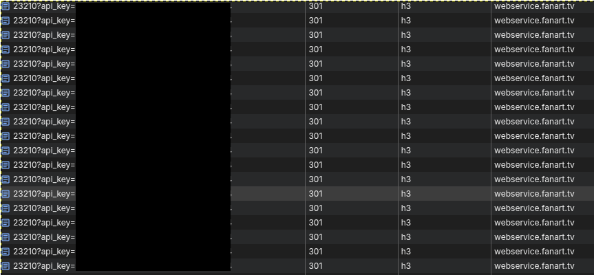

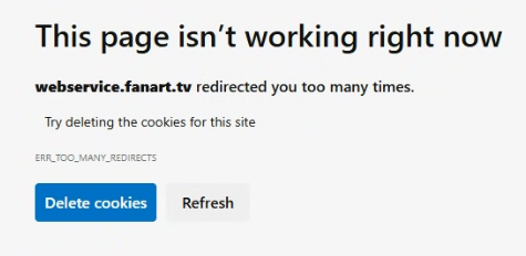

Lessaj 620 Posted November 17, 2025 Author Posted November 17, 2025 (edited) Bumping this again because I noticed today that it keeps querying the same movie over and over again and if I try the same in my browser I'm seeing a constant loop of 301 status codes, which I don't think the plugin handles particularly gracefully. I believe if left long enough it eventually gives up and moves on to another. My library scan is still running, I'll keep an eye on it. If I try to query for images in the image editor, like Thumbs for example, it just has a spinner and I see it keeps querying the title in the log file.This is the movie: https://fanart.tv/movie/23210/six-degrees-of-separation/ Also these but they they say not found. https://fanart.tv/movie/1516660/everything-else-matters/ https://fanart.tv/movie/1462313/sarah-silverman-postmortem/ Just requesting over and over. Quote 2025-11-17 13:05:53.417 Info HttpClient: GET https://webservice.fanart.tv/v3/movies/23210?api_key=123abc 2025-11-17 13:05:53.465 Info HttpClient: GET https://webservice.fanart.tv/v3/movies/1462313?api_key=123abc 2025-11-17 13:05:54.742 Info HttpClient: GET https://webservice.fanart.tv/v3/movies/23210?api_key=123abc 2025-11-17 13:05:54.798 Info HttpClient: GET https://webservice.fanart.tv/v3/movies/1462313?api_key=123abc 2025-11-17 13:05:56.176 Info HttpClient: GET https://webservice.fanart.tv/v3/movies/1462313?api_key=123abc 2025-11-17 13:05:56.380 Info HttpClient: GET https://webservice.fanart.tv/v3/movies/23210?api_key=123abc 2025-11-17 13:05:57.448 Info HttpClient: GET https://webservice.fanart.tv/v3/movies/1462313?api_key=123abc 2025-11-17 13:05:57.659 Info HttpClient: GET https://webservice.fanart.tv/v3/movies/23210?api_key=123abc 2025-11-17 13:05:58.732 Info HttpClient: GET https://webservice.fanart.tv/v3/movies/1462313?api_key=123abc 2025-11-17 13:05:58.959 Info HttpClient: GET https://webservice.fanart.tv/v3/movies/23210?api_key=123abc 2025-11-17 13:06:00.218 Info HttpClient: GET https://webservice.fanart.tv/v3/movies/1462313?api_key=123abc 2025-11-17 13:06:00.335 Info HttpClient: GET https://webservice.fanart.tv/v3/movies/23210?api_key=123abc 2025-11-17 13:06:01.522 Info HttpClient: GET https://webservice.fanart.tv/v3/movies/1462313?api_key=123abc 2025-11-17 13:06:01.655 Info HttpClient: GET https://webservice.fanart.tv/v3/movies/23210?api_key=123abc Edited November 17, 2025 by Lessaj
Happy2Play 9840 Posted November 17, 2025 Posted November 17, 2025 19 minutes ago, Lessaj said: Bumping this again because I noticed today that it keeps querying the same movie over and over again and if I try the same in my browser I'm seeing a constant loop of 301 status codes, which I don't think the plugin handles particularly gracefully. I believe if left long enough it eventually gives up and moves on to another. My library scan is still running, I'll keep an eye on it. If I try to query for images in the image editor, like Thumbs for example, it just has a spinner and I see it keeps querying the title in the log file.This is the movie: https://fanart.tv/movie/23210/six-degrees-of-separation/ Also these but they they say not found. https://fanart.tv/movie/1516660/everything-else-matters/ https://fanart.tv/movie/1462313/sarah-silverman-postmortem/ Just requesting over and over. Looks like they may be having issues again. But am seeing the same/similar in my tests. Not seeing anything on their discord yet. 1
Lessaj 620 Posted November 17, 2025 Author Posted November 17, 2025 Yea almost 30 minutes later and it's still requesting the same 2 movies. My library scan finally finished, I saw a 502 error come up and it stopped trying to query for 1462313 but 23210 since I tried manually to search for images it's still trying. Eventually it might get the same error and stop...
