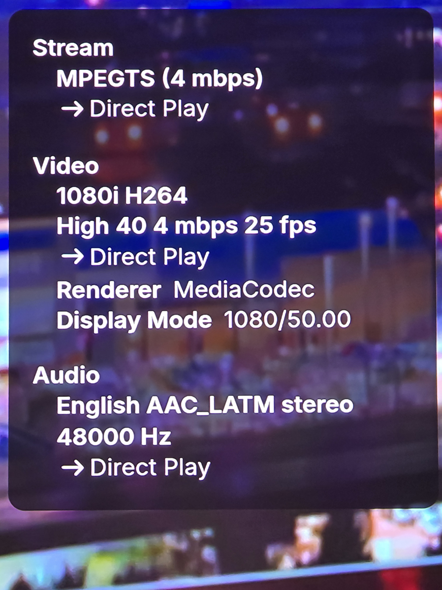

IainB 3 Posted November 3, 2025 Posted November 3, 2025 Regards interlaced video for live TV, I have trouble getting the Android app to use the correct RealFrameRate at 50 It properly detects it's a 1080i stream but sets the RealFrameRate to 25, which looks pretty awful. If I leave and return to the channel a few times, I might get it to display correctly as 50 This is during a continuous 1080i stream, not as if it's changing via ad breaks etc. Are there any recommended server side settings or App settings I can use to fix this? Live TV via HDHomerun, and I'm using Android app 3.5.15 and Server 4.9.2.6 Beta

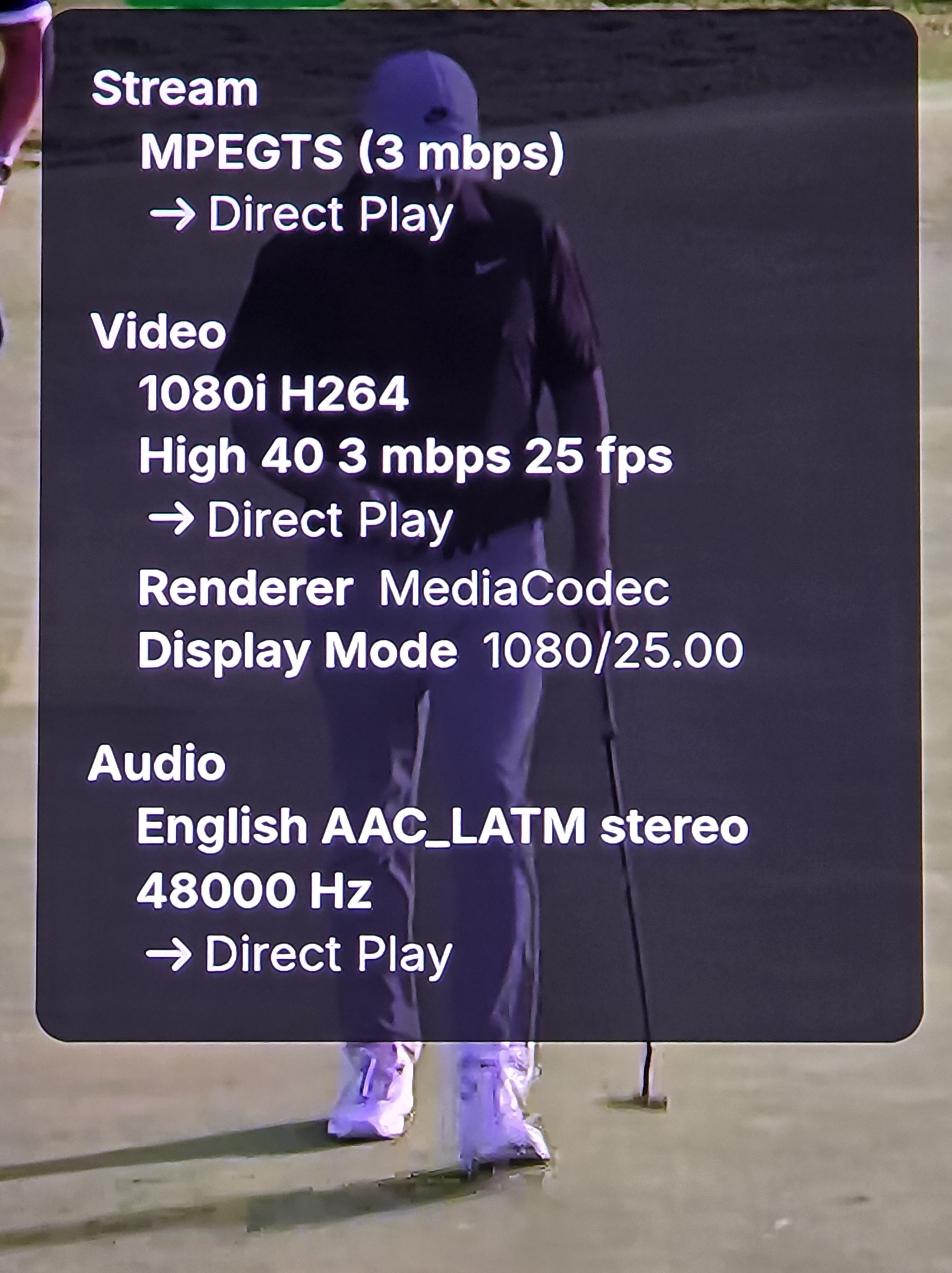

IainB 3 Posted November 3, 2025 Author Posted November 3, 2025 (edited) Screenshot and logs for initial attempt showing @25 and 2nd correct @50 LiveTV log.txt Edited November 3, 2025 by IainB

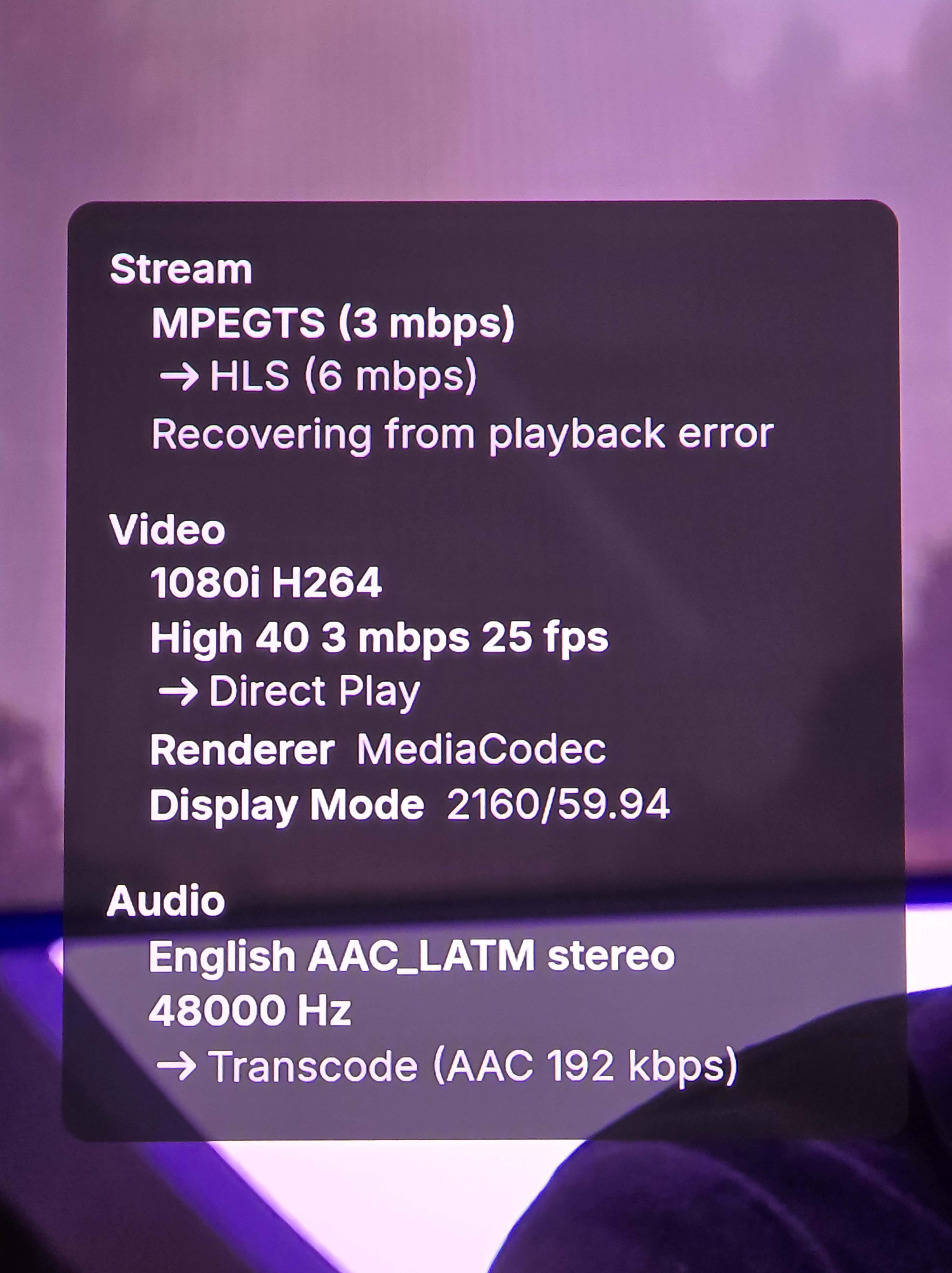

Luke 42239 Posted November 3, 2025 Posted November 3, 2025 HI, if you click playback correction in the video player, how does that compare after that?
IainB 3 Posted November 3, 2025 Author Posted November 3, 2025 Thanks for the quick reply Luke, Screenshot shows after playback correction. Unfortunately, motion still looks bad.

Luke 42239 Posted November 3, 2025 Posted November 3, 2025 15 minutes ago, IainB said: Hi Luke, I included the log in the previous post, shows the stream with RealFrameRate at 25, the at 50 on the second attempt Right but your log was direct play. I would like to see it when transcoding. Thanks.
IainB 3 Posted November 3, 2025 Author Posted November 3, 2025 29 minutes ago, Luke said: Right but your log was direct play. I would like to see it when transcoding. Thanks. Attached are logs that show 1080i direct play RealFrameRate at 25, then playback correction attempt to force transcoding ffmpeg-remux-e2d7049e-bdbd-46fb-b1f3-278cb5b0a77b_1.txt ffmpeg-remux-33bf674f-c46b-4523-bc4f-89816a152712_1.txt LiveTV with transcode log.txt
