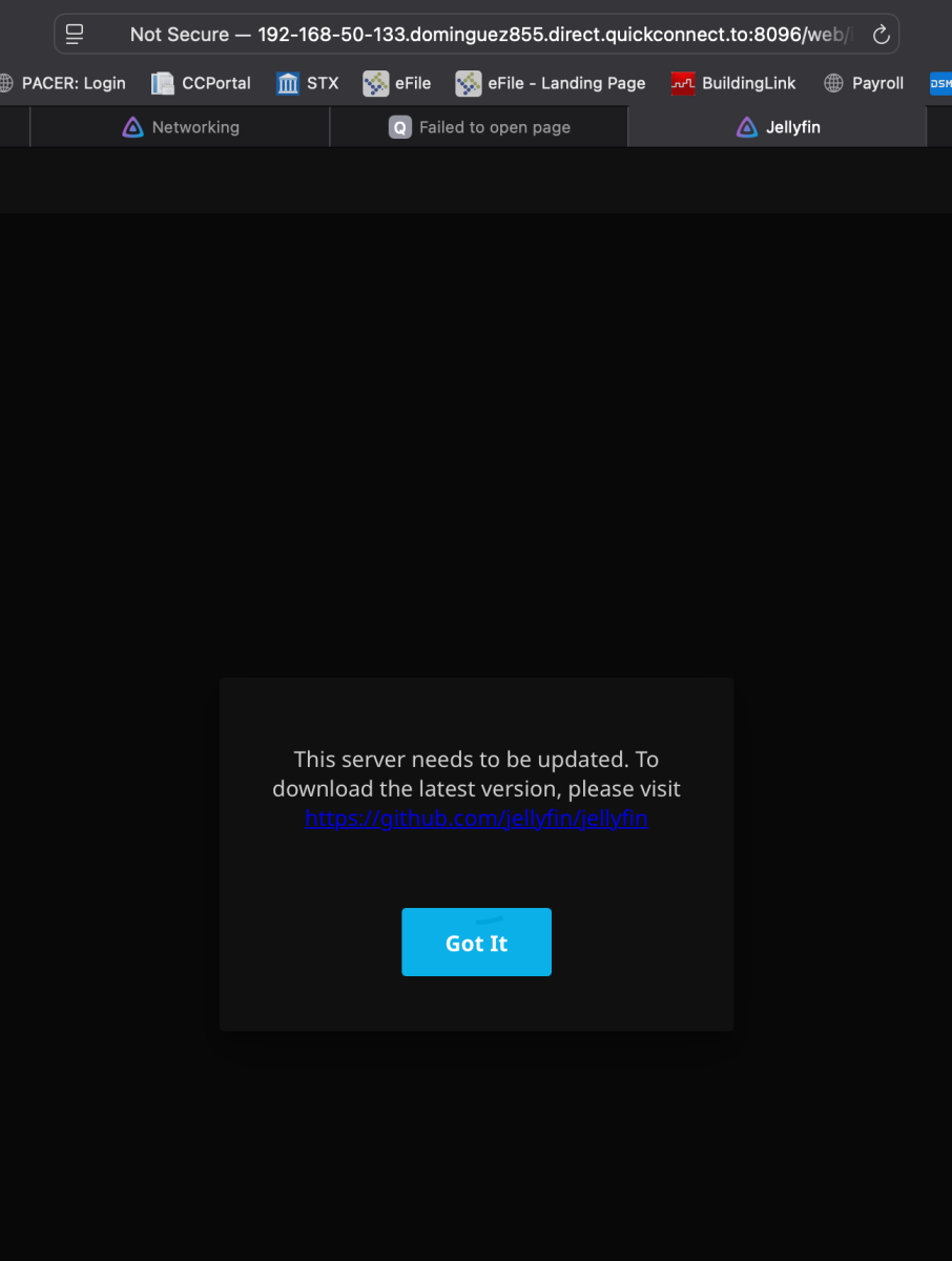

iceman67 0 Posted November 3, 2025 Posted November 3, 2025 Newbie here. Earlier I installed Jellyfin on my DS224+ but did not like it. I uninstalled it. I now manually installed the newest beta of Emby Server. Launching it opens a new webpage but it says This server needs to be updated and gives me the jellyfin github page. Any suggestions on how to get it launch the Emby page?
Neminem 1621 Posted November 3, 2025 Posted November 3, 2025 Shutdown emby and change Jellyfin port to something else. Jellyfin uses the same port as Emby. Since Jellyfin is a fork of Emby years ago, but Jellyfin never bothered to change the port. 1 1
Luke 42239 Posted November 3, 2025 Posted November 3, 2025 16 minutes ago, iceman67 said: Newbie here. Earlier I installed Jellyfin on my DS224+ but did not like it. I uninstalled it. I now manually installed the newest beta of Emby Server. Launching it opens a new webpage but it says This server needs to be updated and gives me the jellyfin github page. Any suggestions on how to get it launch the Emby page? Hi, can you please show a screenshot example? Thanks.

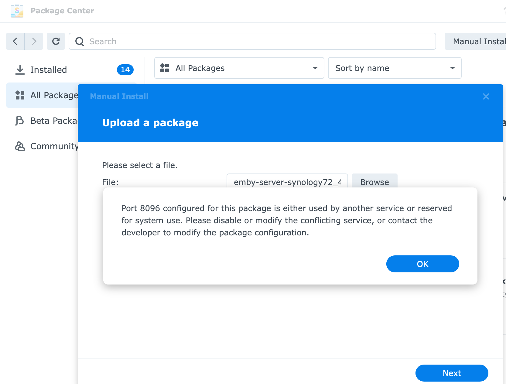

iceman67 0 Posted November 3, 2025 Author Posted November 3, 2025 I reinstalled Jellyfin and changed the ports manually. I double-checked to make sure Jellyfin was launching to the new ports and it did. The Package Center would not let me install Emby due to a conflicting port number (which I had changed), so I uninstalled Jellyfin. Then I re-installed Emby with no errors. But launching Emby again shows the Jellyfin picture below. Is there maybe a setting in Synology where I can manually manage ports or is this something I can do in my router?

Happy2Play 9811 Posted November 3, 2025 Posted November 3, 2025 Both servers are running on the same port as this issue has been mentioned in several topics. By default both product will use the same default ports 8096/8920 so one or the other has to be configured to different ports as mentioned above.
Happy2Play 9811 Posted November 3, 2025 Posted November 3, 2025 (edited) In Emby you have to edit the system.xml in jellyfin it is something like the network.xml. As a basic uninstall does not remove everything on Synology. So if you can get Jellyfin to launch then I would just go to dashboard-networking and change the ports there otherwise you have to edit files mentioned. But file editing in Synology is not the easiest method. Edited November 3, 2025 by Happy2Play
iceman67 0 Posted November 3, 2025 Author Posted November 3, 2025 I was able to change the Jellyfin ports under dashboard/networking. After uninstalling, I was able to access Emby Server by altering the web address in the address bar. I might change the defalt ports of Emby if it keeps giving me issues. Thank you all for your help and ideas. I wold amend the network.xml if I knew where to find it.
