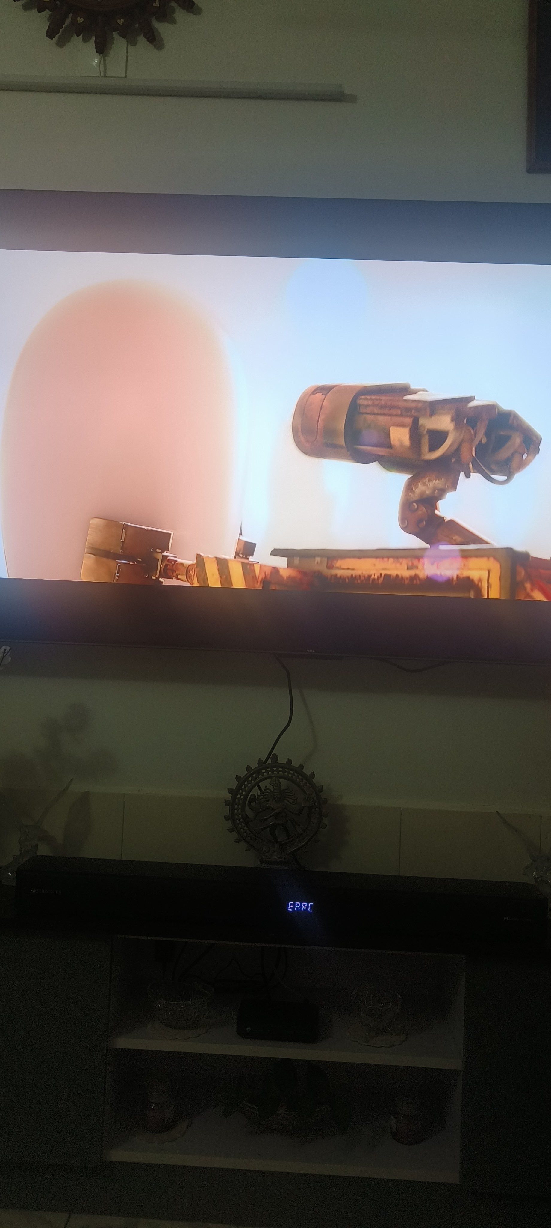

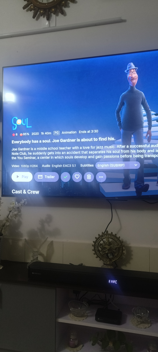

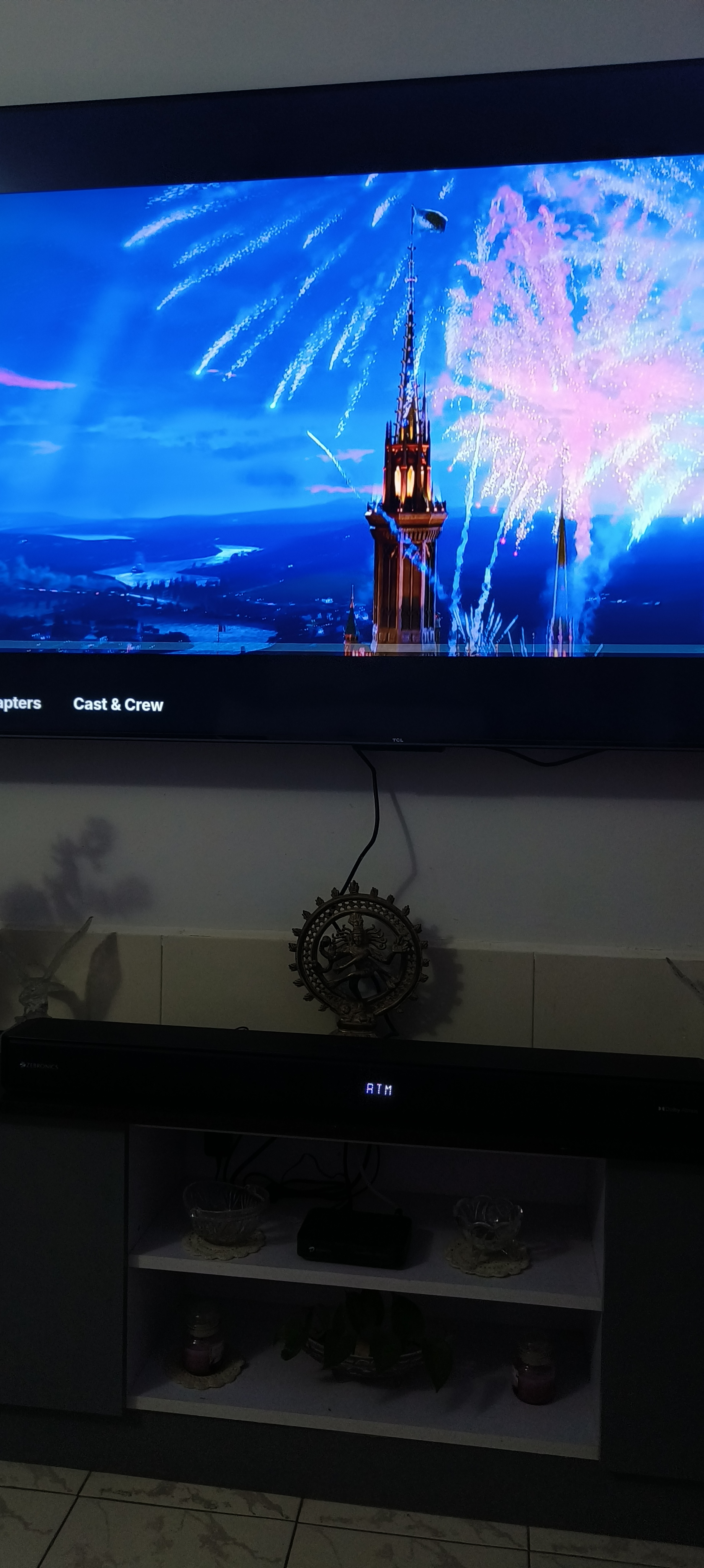

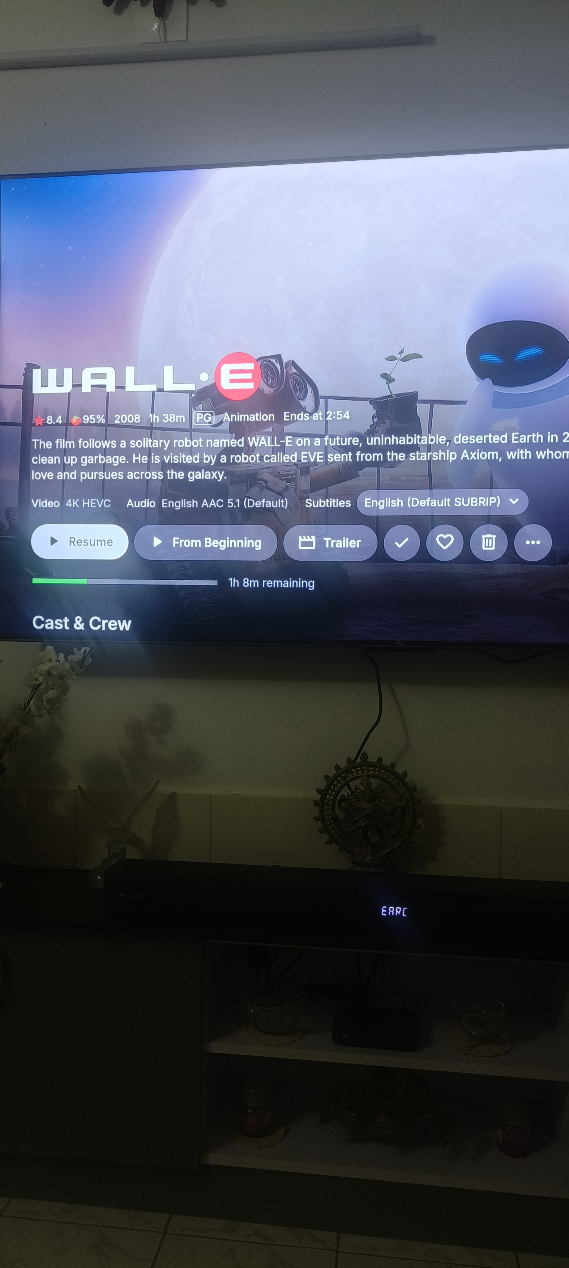

stinger3004 1 Posted November 5, 2025 Author Posted November 5, 2025 Ok so I'm attaching a few pics, one is of the title image (WALL E) showing that Emby detects the title has a AAC 5.1 audio format but the soundbar fails to play it in surround (the soundbar leds continue showing EARC, instead of Dolby Surround) , and similarly for another title (Soul) with EAC3 5.1 (Atmos) , the soundbar recognizes and plays accordingly (it shows Dolby Atmos on the soundbar, you can see ATM written on the soundbar)
yocker 1414 Posted November 5, 2025 Posted November 5, 2025 1 hour ago, stinger3004 said: Ok so I'm attaching a few pics, one is of the title image (WALL E) showing that Emby detects the title has a AAC 5.1 audio format but the soundbar fails to play it in surround (the soundbar leds continue showing EARC, instead of Dolby Surround) , and similarly for another title (Soul) with EAC3 5.1 (Atmos) , the soundbar recognizes and plays accordingly (it shows Dolby Atmos on the soundbar, you can see ATM written on the soundbar) What model TV and Soundbar? It most likely doesn't support AAC formats. Samsung in particular doesn't support that many formats. 1
