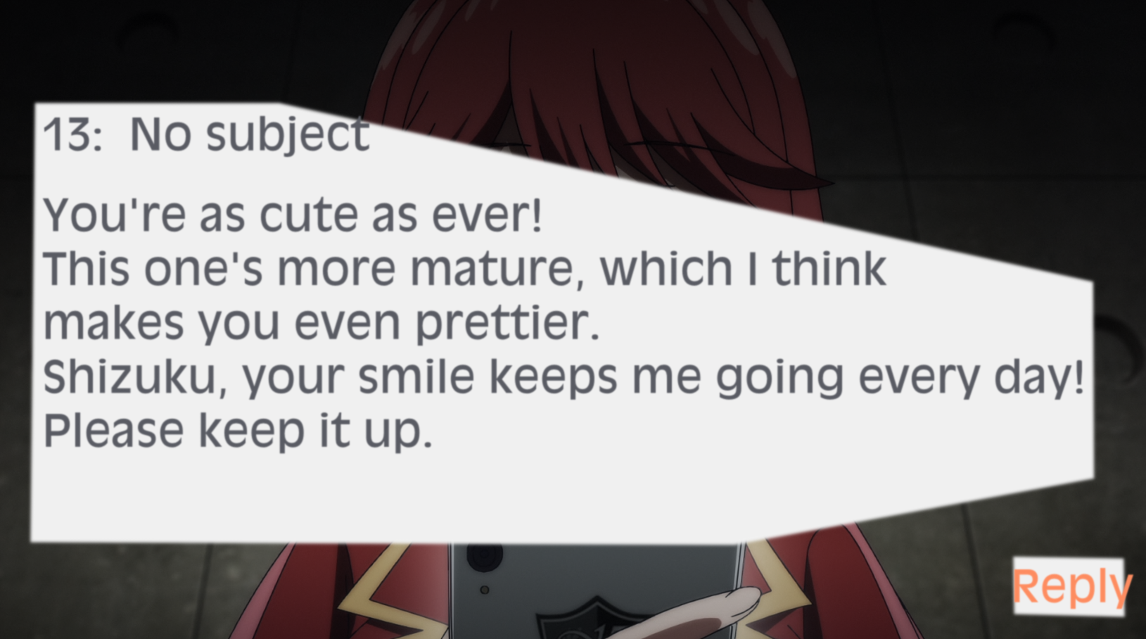

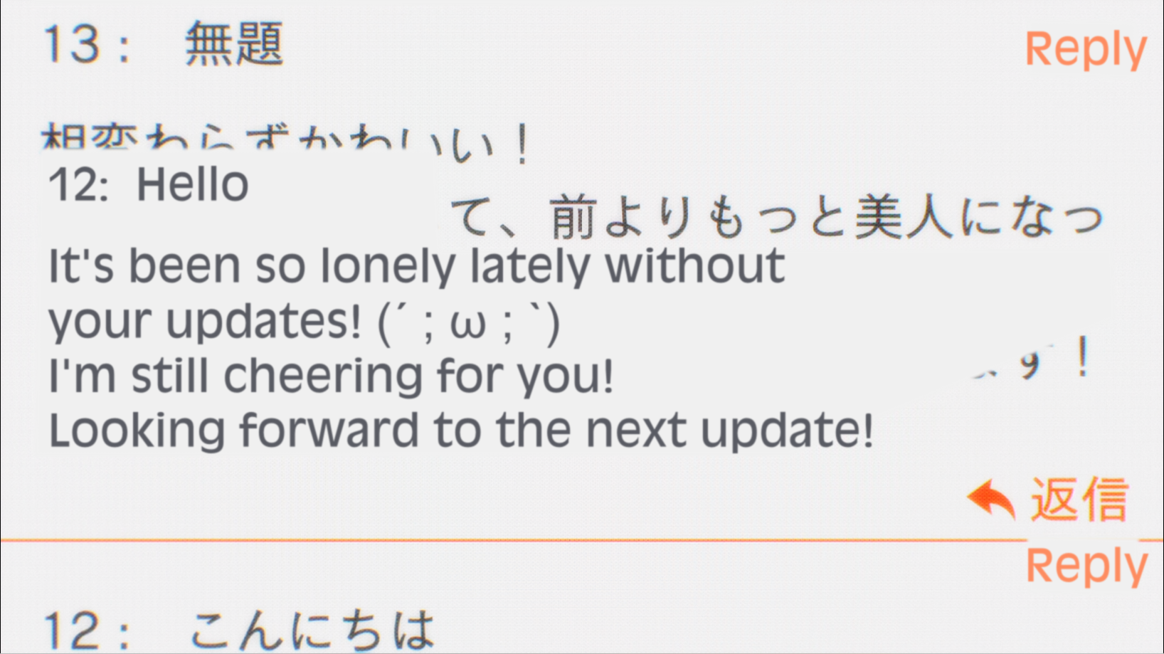

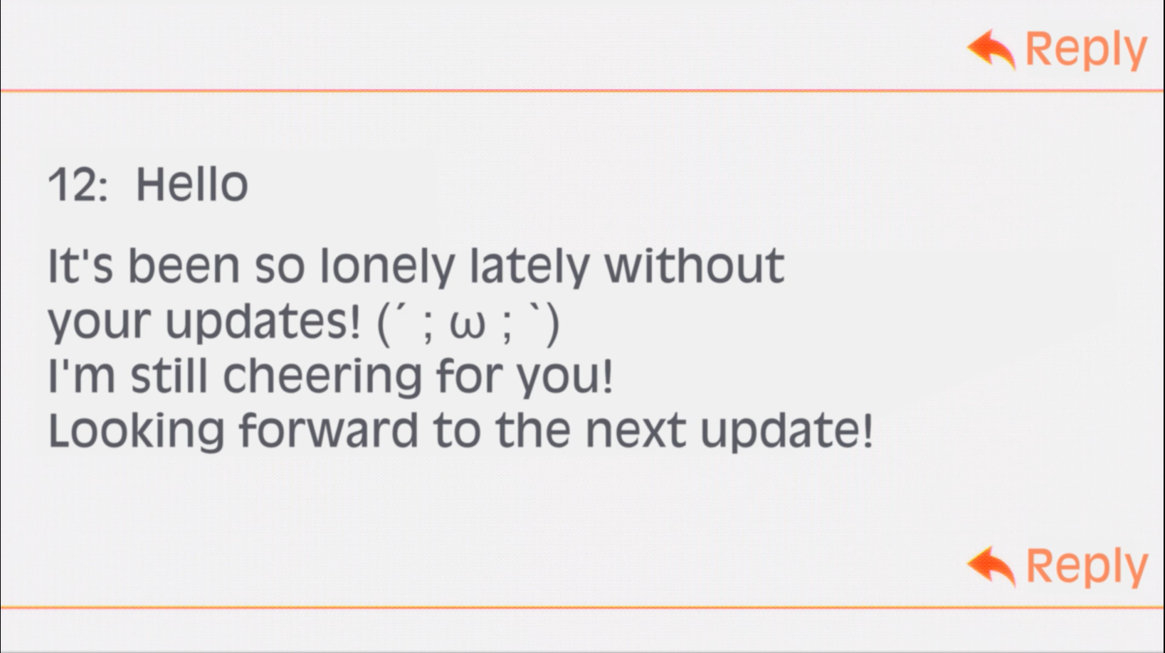

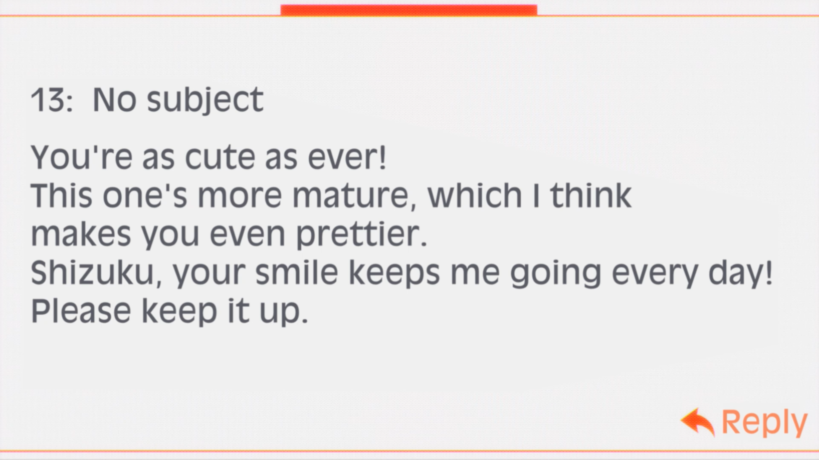

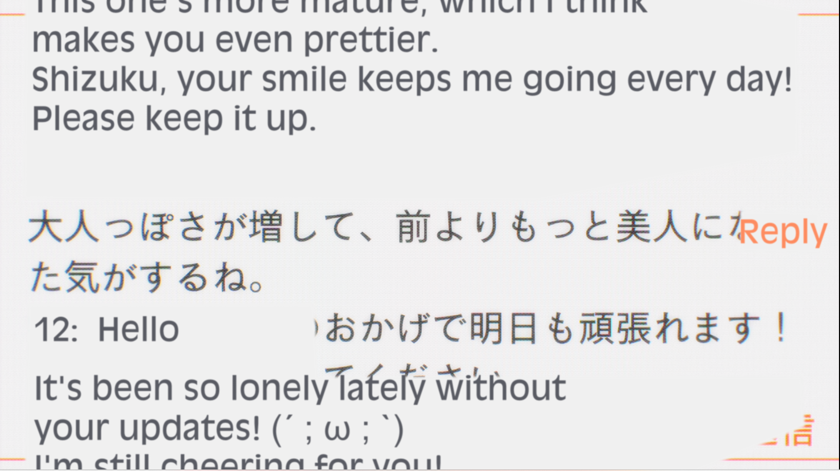

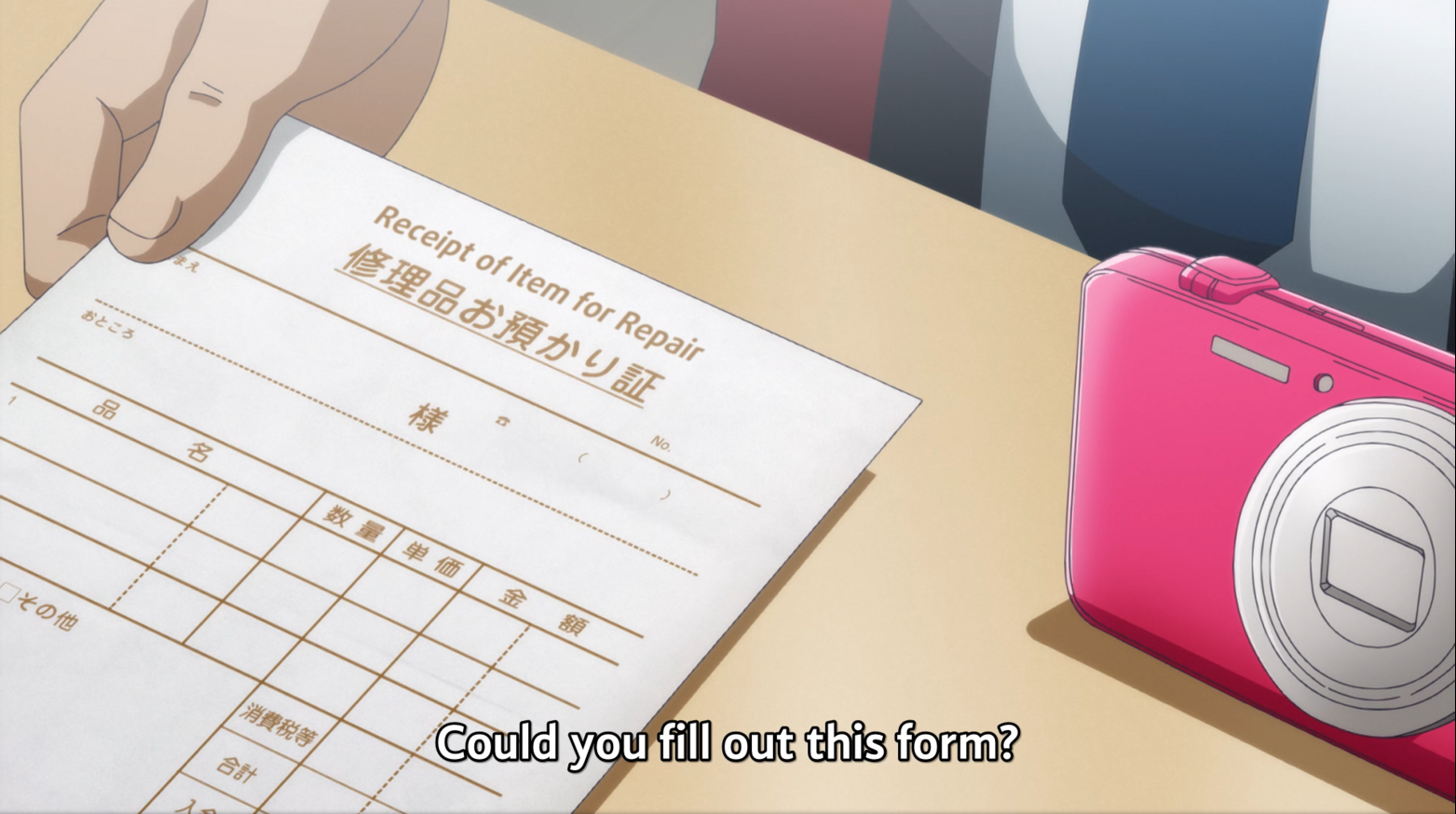

JathTyki 4 Posted November 7, 2025 Author Posted November 7, 2025 2 hours ago, visproduction said: Does that mean in the wrong place on the screen or out of sync? They're out of sync but also it looks like they're displaying funky. For example, I attached six images. Three from Emby, three from Plex, to show a comparison. In Subtitle1Emby, it's showing part of a text over the girl's face, where it doesn't belong. Then it shows them not really showing correctly over the Japanese text well in the first place in 2 and 3. In Subtitle1Plex, you can see that nothing is over the girl's face like it shouldn't be. In 2 and 3, you can see the Japanese text being covered appropriately. Disabling subtitles in Emby doesn't show any issue, and just shows the Japanese text that was originally drawn in the scenes appropriately. This is in a new file as well, the 6th episode of the series.
visproduction 338 Posted November 7, 2025 Posted November 7, 2025 I believe that only .ass or sup PGS graphics can change the backgrounds easily. I thought you only had a test file with .ass subtitles. FYI: You can find converters here: https://subtitletools.com/convert-sup-to-srt-online Can the .ass requesting fonts that are not available cause these results? Why are there also Japanese subtitles? They appear to be behind, so the Japanese subtitles might be burned into the media file and the overlays with .ass might be trying to mask he these burned in subtitles with new subtitles on top with a solid background. Maybe this combination only works for mobile playback and not for TV App, or the mix up mess is caused again because the fonts that will overlay correctly are not available and the TV app player substitutes a default font that has different spacing and therefore looks terrible. Ideally, find media without burned in subtitles and then add in stand alone files in .srt that work. I think you are dealing with burned in Japanese subtitles and .ass embedded files that only look good if you have the original fonts, which is probably only available on the blu-ray disk.
