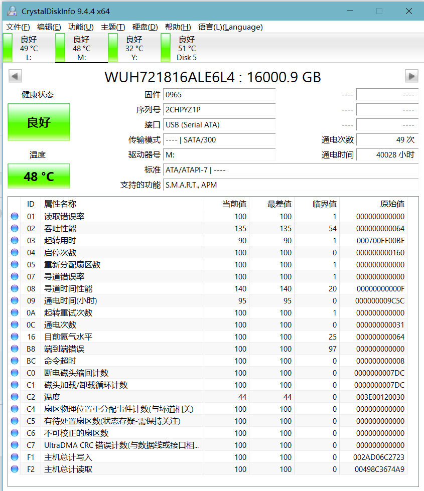

Yra_pril 2 Posted November 4, 2025 Author Posted November 4, 2025 12 minutes ago, Luke said: Is something wrong with your M drive? M盘的健康状况也没有什么问题
