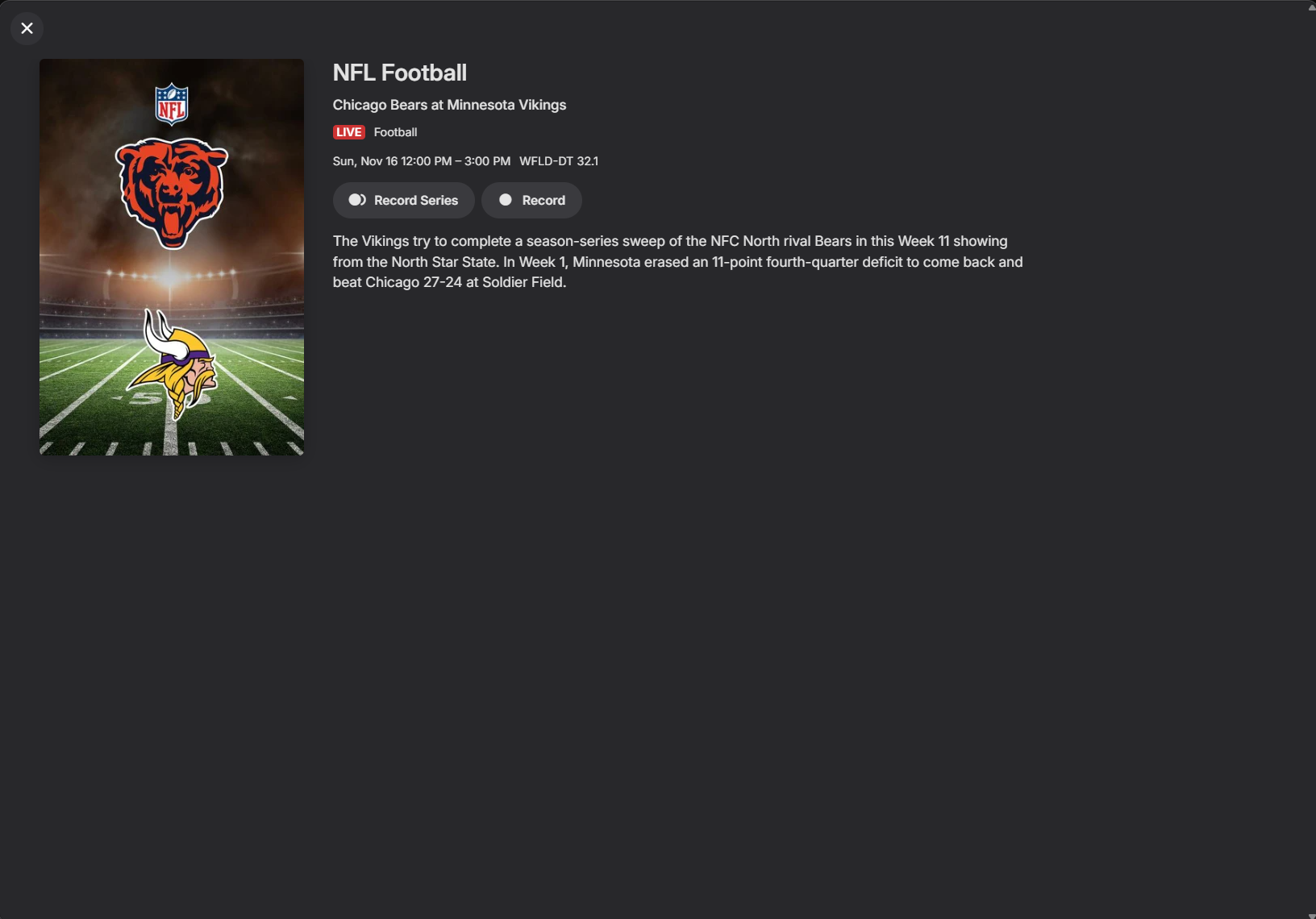

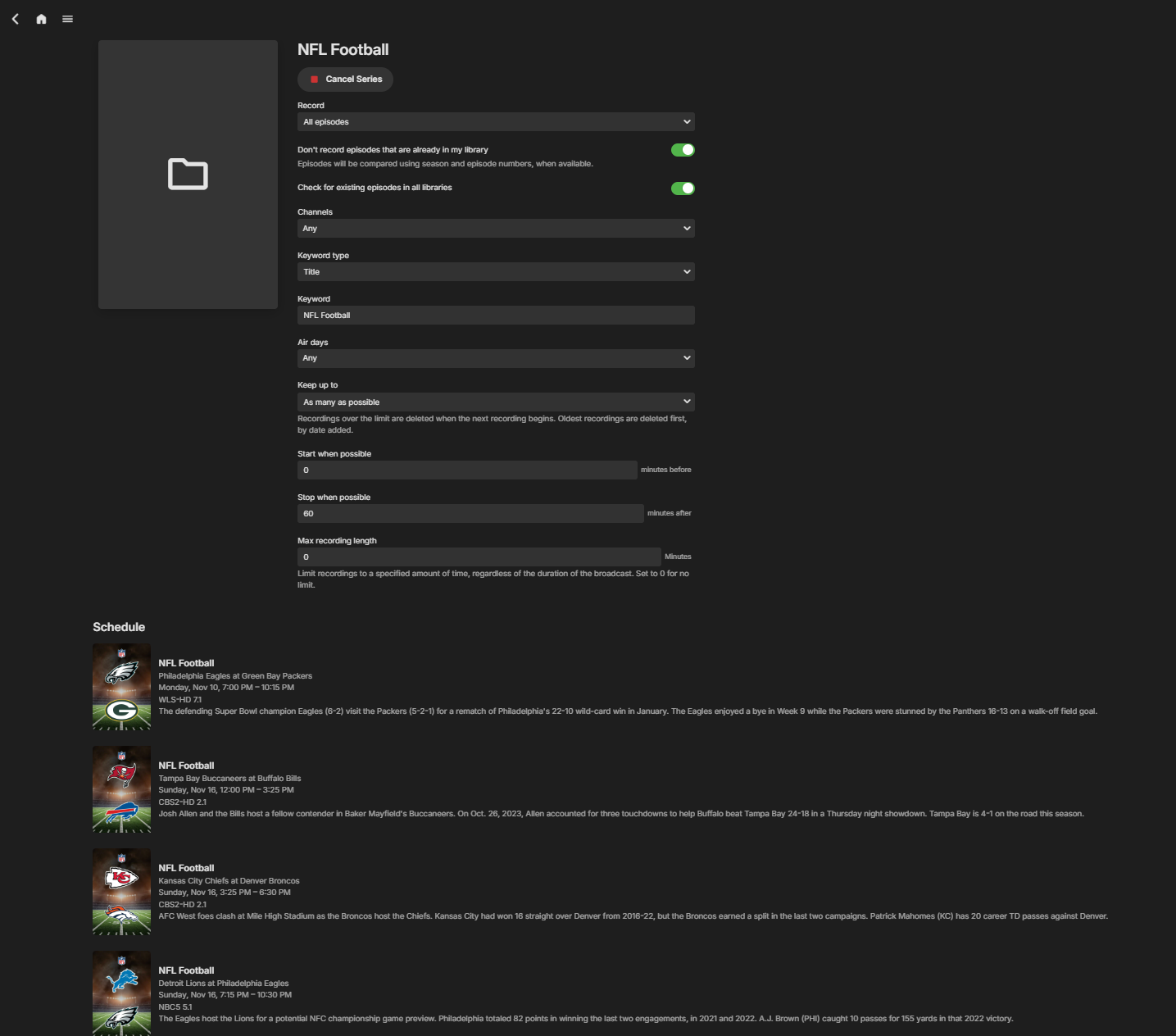

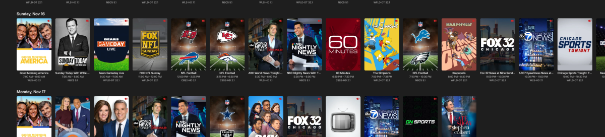

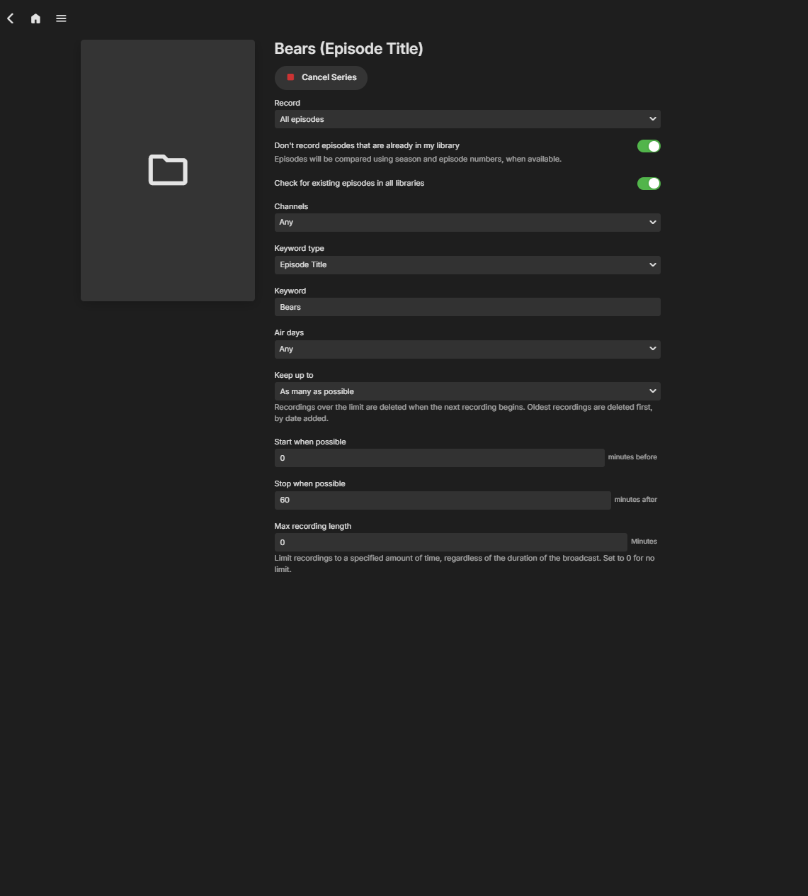

bungee91 133 Posted November 10, 2025 Author Posted November 10, 2025 (edited) On 11/3/2025 at 10:57 AM, Luke said: Yea it's odd, they must have a different series id in the program data. Alright so I have more information, and almost a week to get to the bottom of this! Current Status: The NFL Football Series recording is not recording the Chicago Bears games. Attachments: 1 Showing the NFL Football series recording schedule that is missing the Chicago Bears Game 2 The Scheduled Recording screen with the game not scheduled (likely not needed) 3 The Chicago Bears game listing screen in the guide that is not currently set to record with the title "NFL Football". 4 The "Bears" Episode Title keyword recording screen. This one is interesting because it has no results for anything coming up, which is untrue! I still think having this is causing an error for it to not record under the "NFL Football" Series recording. However (!), I have removed it before and swear the NFL Football series still doesn't record the Chicago Bears games. I think then it sees them in the results, but sets them to not record. I don't want to make any changes to this now, as it will then break the troubleshooting side of this. Also attached is the most recent server log. Uncertain it is needed. Confused! embyserver (2).txt Edited November 10, 2025 by bungee91
Solution Luke 42234 Posted November 11, 2025 Solution Posted November 11, 2025 Hi, if you uncheck the "don't record..." option, does that make a difference?
bungee91 133 Posted November 11, 2025 Author Posted November 11, 2025 2 hours ago, Luke said: Hi, if you uncheck the "don't record..." option, does that make a difference? That did it! Strange, however grateful to know that was causing the issue. I would think that option being selected should still show it in the results, however as not recording (if true, not the case here minus potential bad guide results), but that's just an opinion of my expectation of the setting and the listed results. Either way, thank you!
