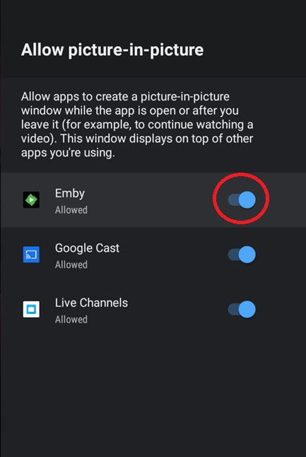

Q-Droid 1011 Posted November 4, 2025 Posted November 4, 2025 (edited) 14 minutes ago, FrostByte said: The ATV app doesn't close either when clicking Home, it just exits. That's the way all apps work on Android. Just tried ATV, Xplore, ABT, etc and they were all active after clicking Home. Maybe ATV closes some threads which the Android app doesn't when clicking Home? I know ATV wasn't PiP compatible, so that needs to be disabled in settings if not used in the new app. The ATV apps stops streaming when you hit the Home button. The console might show the session but no active playback. Does the stable release of the Android app have an option to disable PIP? Edited November 4, 2025 by Q-Droid 2
FrostByte 5453 Posted November 4, 2025 Posted November 4, 2025 2 minutes ago, Q-Droid said: The ATV apps stops streaming when you hit the Home button. The console might show the session but no active playback. Does the stable release of the Android app have an option to disable PIP? Yes, but it's not done within the app. It's an Android setting under special app access. You just deny Emby access to PiP there.

Q-Droid 1011 Posted November 4, 2025 Posted November 4, 2025 6 minutes ago, FrostByte said: Yes, but it's not done within the app. It's an Android setting under special app access. You just deny Emby access to PiP there. So with PIP access disabled then hitting Home on the Android app it pauses playback which could tie up resources. ATV stops the activity and looks like an idle session.

FrostByte 5453 Posted November 4, 2025 Posted November 4, 2025 4 minutes ago, Q-Droid said: So with PIP access disabled then hitting Home on the Android app it pauses playback which could tie up resources. ATV stops the activity and looks like an idle session. I don't know exactly if it stops the stream or just pauses. In the Android app if watching a movie and you click Home the app Exits and the movie you were watching still plays in a little window. This allows you to use other apps and still watch the movie. I just know the PiP window doesn't appear, never thought about checking the dashboard though.

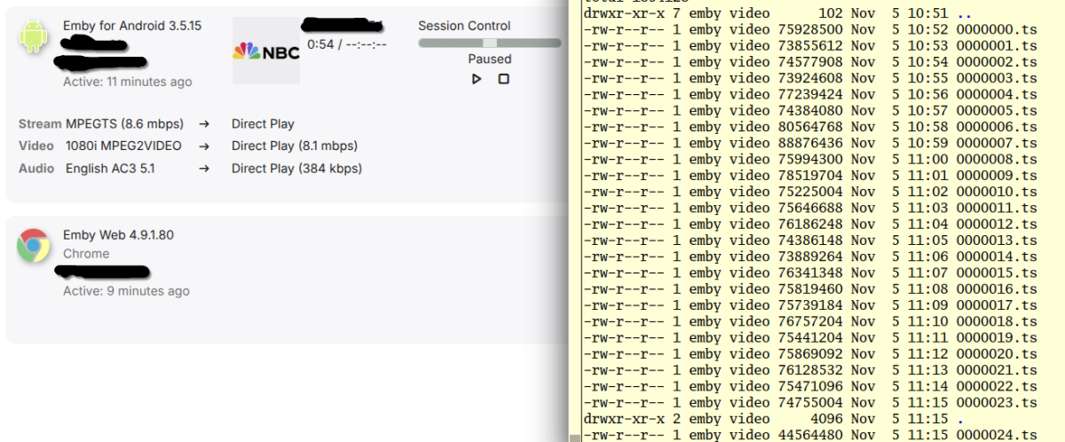

Q-Droid 1011 Posted November 5, 2025 Posted November 5, 2025 I've been lazily following the Android/ATV app parity thread and other related threads from members and don't know if this specific case was covered before. It surprises me that simple things like exiting are to this day so far apart between the two apps. This specific issue needs to be addressed as it's very similar to the Roku "improper exit" problem which left streams running and tying up tuners. Back button from ATV opens confirmation dialog to exit the app. Back button from Android stable opens/closes side-bar. Evidently Android beta opens an Exit menu. Home button from ATV stops playback and exits to ATV home. Home button from Android opens PIP on ATV home when allowed or pauses playback and exits to ATV home when PIP is disabled. But this leaves a streaming session behind and in the case of LiveTV ties up a tuner and builds up the playback buffer. 2
rdhardi 42 Posted November 5, 2025 Author Posted November 5, 2025 1 hour ago, Q-Droid said: Home button from ATV stops playback and exits to ATV home. Home button from Android opens PIP on ATV home when allowed or pauses playback and exits to ATV home when PIP is disabled. But this leaves a streaming session behind and in the case of LiveTV ties up a tuner and builds up the playback buffer. Yes! THANK YOU for the clear and concise explanation of this issue.
Luke 42241 Posted November 5, 2025 Posted November 5, 2025 The server will clean it up pretty quickly after that so shouldn’t be an issue. 1
Q-Droid 1011 Posted November 5, 2025 Posted November 5, 2025 How quickly? This was over 20 minutes after hitting the Home button from the Android app to return to the ATV home screen.

Q-Droid 1011 Posted November 5, 2025 Posted November 5, 2025 My potato PC is just fine, thank you very much. Eventually (after a few more minutes) the session disappeared from the dashboard but continued running and creating TS segments on the server. When I went back into the Android app the screen was black though navigating brought up the OSD on a paused stream, still blank. Hitting OK button resumed the stream then I exited the stream and the app via menu which stopped all activity and cleaned up the files. Let's just say the UX is not at all like the Emby app for ATV. 2
