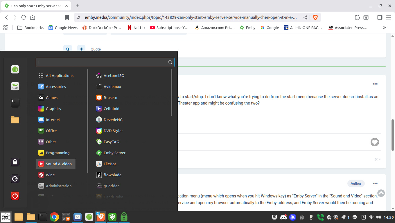

bduares 0 Posted October 31, 2025 Author Posted October 31, 2025 (edited) When I originally installed Emby, it was indeed listed in the application menu (menu which opens when you hit Windows key) as "Emby Server" in the "Sound and Video" section. When I chose this application in the list it would then start the service and open my browser automatically to the Emby address, and Emby Server would then be running and other devices could then connect to it throughout my network. After installing Jellyfin this no longer happened. Even after removal and purging of both Jellyfin and Emby, and reinstallation of Emby this does not happen. It is still now listed in my application menu as it was before, but trying to run it from there does nothing at all. It neither starts the service nor opens a browser to the Emby address. I have to manually open a terminal and start the service in terminal, then open a browser and go to the Emby address before it is up and running for others to see and use on my network. Starting the service in terminal, without opening the browser and going to the local Emby address, also does not allow the Emby Server to be available to others on my network. The browser must be open and at Emby's address for the program to actually be running and available to others. Edited October 31, 2025 by bduares

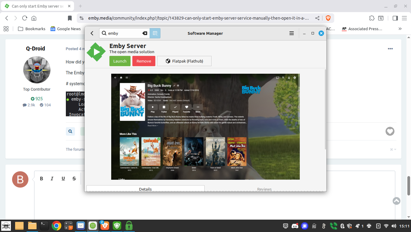

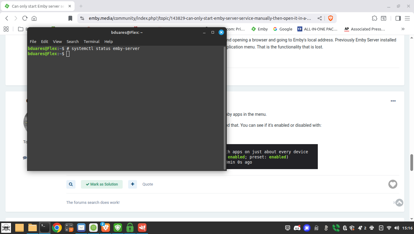

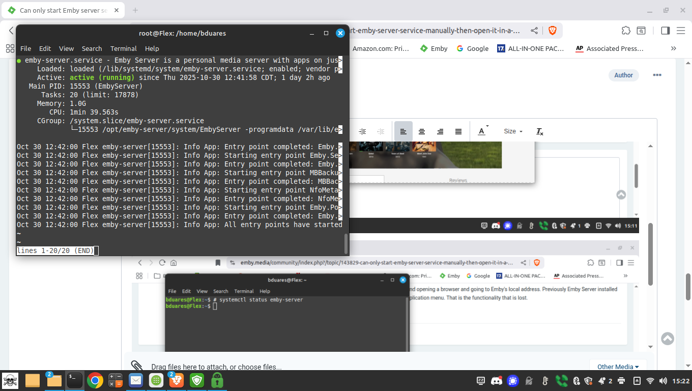

bduares 0 Posted October 31, 2025 Author Posted October 31, 2025 (edited) I installed it via the Software Manager in Linux Mint, which used the flatpak install. Also even trying to launch it from that menu now does nothing, when previously it would also start the server and open the browser and Emby would be available for others on the network. # systemctl status emby-server results in nothing as well, even though my Emby server is up and running right now, unless I do that in a terminal as root, in which case I see this: Edited October 31, 2025 by bduares
Q-Droid 1011 Posted October 31, 2025 Posted October 31, 2025 Flatpak. That makes more sense now though I don't have much to offer on that type of installation.
bduares 0 Posted October 31, 2025 Author Posted October 31, 2025 After yet another reboot, I selected Emby Server in the application menu. There was no apparent activity, but opening a terminal as root I could see the service was now running, and I am able to connect to it with other devices on the network without having to open a browser on the server system and going to the Emby local address. So that part of the functionality seems to have fixed itself somehow, though it did previously open a browser and go to the Emby address in it automatically, which it no longer does. But I can live with that.
Q-Droid 1011 Posted October 31, 2025 Posted October 31, 2025 You might want to check if the Emby service is already running before you try to launch from the menu, after a reboot. If systemd is starting the server then you don't need to do anything manually.
bduares 0 Posted October 31, 2025 Author Posted October 31, 2025 Just rebooted again and checked the server status as root. It is indeed running at startup without my having to run anything from the application menu. Checking on another device I am also able to connect to the server. So that is working, when it was not working previously. The only thing that seems broken now is clicking the Emby Server selection in the application menu no longer opens the server address in a browser automatically. No big issue, I will just just use a bookmark in the browser for that to perform maintenance.
