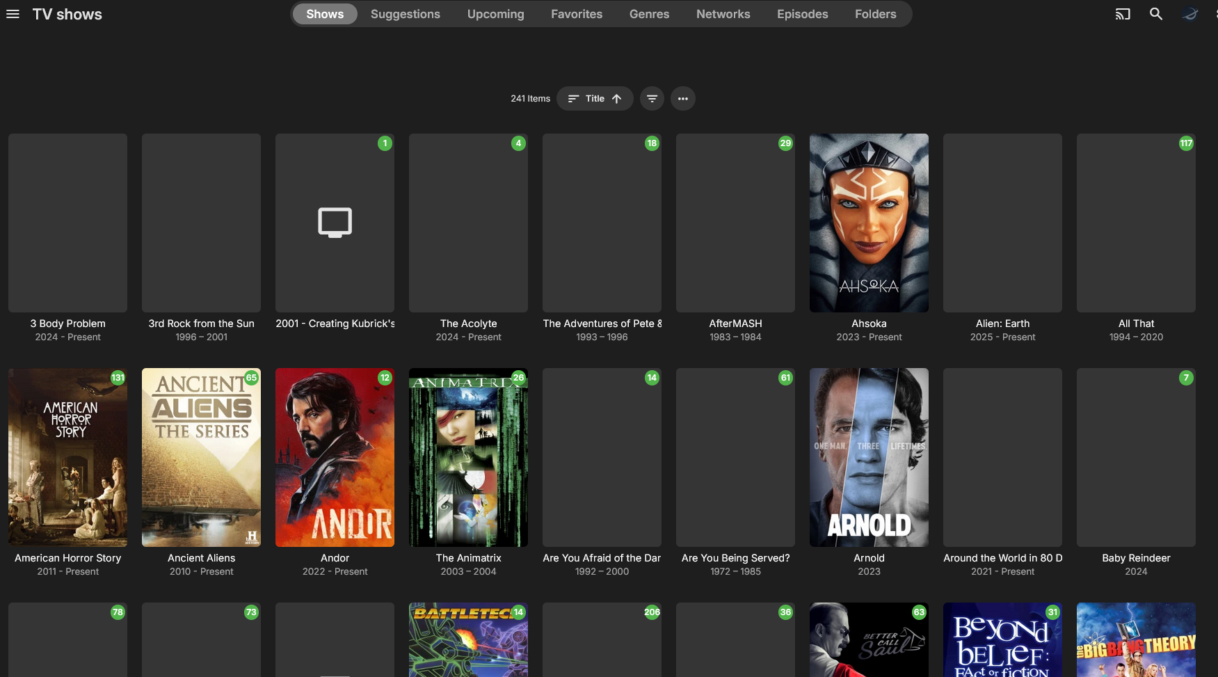

ITGuy1024 18 Posted October 29, 2025 Posted October 29, 2025 2025-10-29 10:38:59.739 Info ImageService-0HNGMV0FML7UG:0000001F: http/1.1 Response 404 to host1. Time: 3ms. GET http://172.30.1.109:38000/emby/Items/691678/Images/Thumb?maxWidth=350&tag=1cea9c89c351b0c839d68f08b27875e6&quality=90. 2025-10-29 10:38:59.739 Error ImageService-0HNGMV0FML7UI:0000001B: Error processing request *** Error Report *** Version: 4.9.1.80 Command line: C:\Users\Administrator\AppData\Roaming\Emby-Server\system\EmbyServer.dll -noautorunwebapp Operating system: Microsoft Windows 10.0.17763 OS/Process: x64/x64 Framework: .NET 8.0.20 Runtime: C:/Users/Administrator/AppData/Roaming/Emby-Server/system/System.Private.CoreLib.dll Processor count: 16 Data path: C:\Users\Administrator\AppData\Roaming\Emby-Server\programdata Application path: C:\Users\Administrator\AppData\Roaming\Emby-Server\system System.IO.DirectoryNotFoundException: System.IO.DirectoryNotFoundException: Could not find a part of the path 'C:\Users\Administrator\AppData\Roaming\metadata\library\43\43297f38de9ca8eda69fc7f4be5ecd72\fanart.jpg'. at System.IO.FileSystem.CopyFile(String sourceFullPath, String destFullPath, Boolean overwrite) at Emby.Drawing.Skia.SkiaEncoder.GetTempFile(String path, Boolean isError) at Emby.Drawing.Skia.SkiaEncoder.GetSKFileStream(String path) at Emby.Drawing.Skia.SkiaEncoder.EncodeImage(String inputPath, String outputPath, Boolean autoOrient, Nullable`1 orientation, Int32 quality, ImageProcessingOptions options, ImageFormat selectedOutputFormat) at Emby.Drawing.ImageProcessor.ProcessImage(ImageProcessingOptions options, CancellationToken cancellationToken) at Emby.Api.Images.ImageService.GetImage(ImageRequest request, Int64 itemId, BaseItem item, Boolean isHeadRequest) at Emby.Server.Implementations.Services.ServiceController.GetTaskResult(Task task) at Emby.Server.Implementations.Services.ServiceHandler.ProcessRequestAsync(HttpListenerHost httpHost, IServerApplicationHost appHost, IRequest httpReq, IResponse httpRes, IStreamHelper streamHelper, RestPath restPath, String responseContentType, CancellationToken cancellationToken) at Emby.Server.Implementations.HttpServer.HttpListenerHost.RequestHandler(IRequest httpReq, RestPath restPath, String urlString, String localPath, String contentTypeInPath, CancellationToken cancellationToken) Source: System.Private.CoreLib TargetSite: Void CopyFile(System.String, System.String, Boolean) Path: C:\Users\Administrator\AppData\Roaming\metadata\library\43\43297f38de9ca8eda69fc7f4be5ecd72\fanart.jpg Latest version of Emby (4.9.1.80) running on Server 2019. I rebooted Emby and when it came back up I am missing a ton of media images.

ITGuy1024 18 Posted October 30, 2025 Author Posted October 30, 2025 13 hours ago, Luke said: Ok I would try refreshing the metadata on an impacted title and see if that helps. I mean we are talking about thousands of broken items. I did a mass refresh / replace images on TV shows and it only fixed about 20% of what's broken. This is going to be a nightmare to fix.

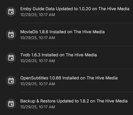

ITGuy1024 18 Posted October 30, 2025 Author Posted October 30, 2025 3 hours ago, Happy2Play said: Only guess would be something happened to your Custom paths as these are not default paths. 2025-10-29 10:33:26.822 Info App: Cache path: C:\Users\Administrator\AppData\Roaming\cache\cache 2025-10-29 10:33:26.822 Info App: Internal metadata path: C:\Users\Administrator\AppData\Roaming\metadata 2025-10-29 10:33:26.822 Info App: Transcoding temporary files path: C:\Users\Administrator\AppData\Roaming\transcoding-temp\transcoding-temp Are these correct custom paths? Normally will reside in Data path: C:\Users\Administrator\AppData\Roaming\Emby-Server\programdata I think I changed those because I was migrating to a new server like 2 years ago and there was a suggestion somewhere to use a different location when migrating. It's been so long I can't recall. Emby had a pending reboot for updates and it updated these items. I can't imagine that would have caused this issue?

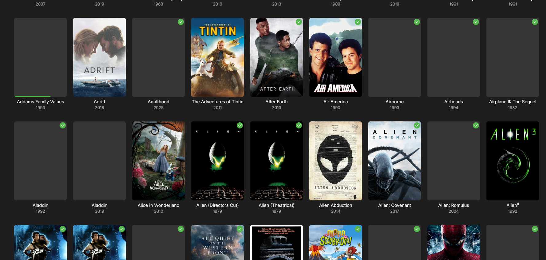

ITGuy1024 18 Posted November 1, 2025 Author Posted November 1, 2025 On 10/30/2025 at 3:52 PM, Luke said: What I think happened is you had files in your custom metadata path that the server was expecting to be there, but are no longer there. So unless you can restore those then you will need to manually refresh metadata. Please note you can also do this at a parent folder level so that you don't have to do it one at a t ime. I did the movie refresh at the parent level - it only fixed about 20% of what was broken. However doing a refresh at the parent level for movies fixed almost everything. So I had a thought. What does emby use for it's database? Is it possible this data was stored in cache and not actually written to the database? I can't image that's the case because it's been running fine for years and I have obviously rebooted emby for all updates. 1
