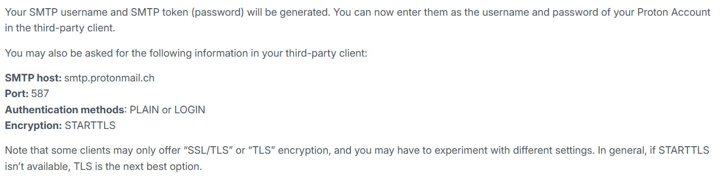

Lun 4 Posted October 31, 2025 Author Posted October 31, 2025 What would you suggest? I tried with 25, 587 and even the legacy 465 (which times out, as it should). These are the instructions from Proton: Am I missing any steps here?

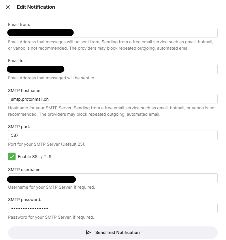

Q-Droid 1054 Posted October 31, 2025 Posted October 31, 2025 (edited) Which email address are you using in the "SMTP username" field? It should be the Proton email account for which you generated the token. You could try entering the same email address in the "email from" field if you haven't already. Edited October 31, 2025 by Q-Droid

Lun 4 Posted October 31, 2025 Author Posted October 31, 2025 @Q-DroidIt is the same on both fields and it is the same that Proton provides. When you are creating the token it allows you to select one of your configured domains and it also has a drop down for the specific email account that would be authorize to use and send the emails. (which is the same I'm filling out in Emby). This instance of Emby is running on a Windows Server.
