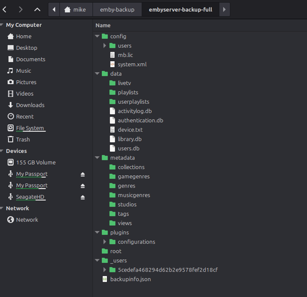

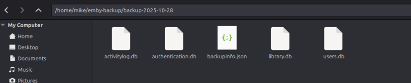

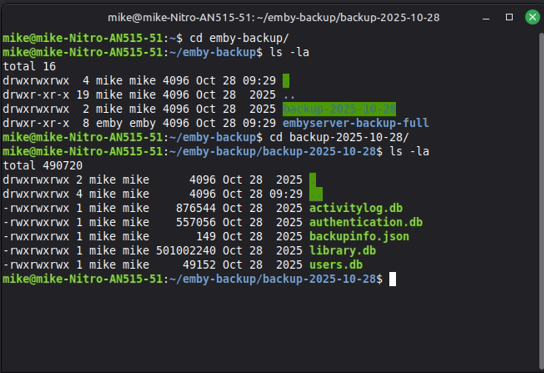

ironcladmerc 2 Posted October 28, 2025 Posted October 28, 2025 I just installed emby on my new Linux mint 22.2 install, and I had a backup from windows 10 that I wanted to import the users and userdata from into this new install. Emby 4.9.1.80 is installed in both Windows 10 and Linux, and the backup plugin version 1.8.2.0 is installed on both as well. I noticed that a full backup from linux results in a radically different folder structure in the backup folder. The one from windows has only 5 files in it, whereas the linux one has a bunch of folders in a complicated structure. Needless to say, Emby is only recognizing the full backup from linux, it doesn't show the windows backup as being available for restore. I have the correct permissions on everything, so I know it's not that. Here are my screenshots for comparison as well as the ls -la for the backup folder Any idea how to get linux to recognize windows backup? I'd rather not have to manually set up the user info with what was watched as we have a large media library and that could take days to do manually.
Solution GrimReaper 4896 Posted October 28, 2025 Solution Posted October 28, 2025 (edited) You're looking at different backups: there's full backup and incremental db backups. You need your Windows full backup if you want to compare them. Edited October 28, 2025 by GrimReaper
