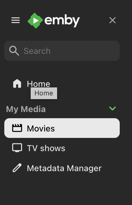

Gandalftw 2 Posted October 28, 2025 Posted October 28, 2025 Hi, I was looking for a good replacement for PLEX and found EMBY. After using PLEX since the first year it was released I decided that I don't like what PLEX has become and its not possible to use it offline anymore. I installed EMBY on linux vm and used my nfs server as a source for Movies/TV shows, just as I use it normally with PLEX. Everything is working very good , I had to make minor change to run the service with another account and this is all working fine. My only small issues which I wanted to ask if its possible to disable this "features". I do not need any users/profiles on this media server, I understand the advantages for people who needs this option, to me it's completely useless. The option to "remember me" is available which is fine, but because there are users/profiles I see the metadata manager which I DON'T WANT TO SEE OR USE this way. Is there a tweak to remove it ? I will not create users or deal with profiles/privileges , it has to be as simple as possible. I have everything automatically configured at home (Raddar/Bazzar/Sonnar etc...) I just want to go to the living room open the TV and run EMBY , no profiles no smart staff , play and done. Thanks in advanced.

Gandalftw 2 Posted October 29, 2025 Author Posted October 29, 2025 Hi, I created a new user (copy from existing user emby which is admin?) Than removed Allow this user to manage the server from emby user, but nothing has changed , the new user Doesn't have the metadata manager and the emby still see it. what I have done wrong(this is exactly what I don't want to deal with), I only watch movies/tv shows, no small children or remotely access the server and no NASA requirements ? Please allow to have the option not to use profiles at all , KEEP IT SIMPLE , but I guess there is no such thing in 2025 , if we can write additional code lets go for it. Do you all need it ? who cares. My apologies for the nagging , 25y in IT , I never hated it more.
GrimReaper 4926 Posted October 29, 2025 Posted October 29, 2025 (edited) 25 minutes ago, Gandalftw said: the new user Doesn't have the metadata manager and the emby still see it. I'm having hard time understanding this: where does new user not have Metadata Manager? Where does Emby see it? 25 minutes ago, Gandalftw said: Please allow to have the option not to use profiles at all That is not feasible, Emby is multi-user environment, there will always be at least a single user (which by default will be a server admin, as you cannot have no server admins in any scenario), unrestricted number of non-admin users can be created in addition. Edited October 29, 2025 by GrimReaper

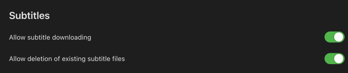

howllor 28 Posted October 29, 2025 Posted October 29, 2025 Yes, from the admin account you can give your usual account the right to download and/or delete subtitles

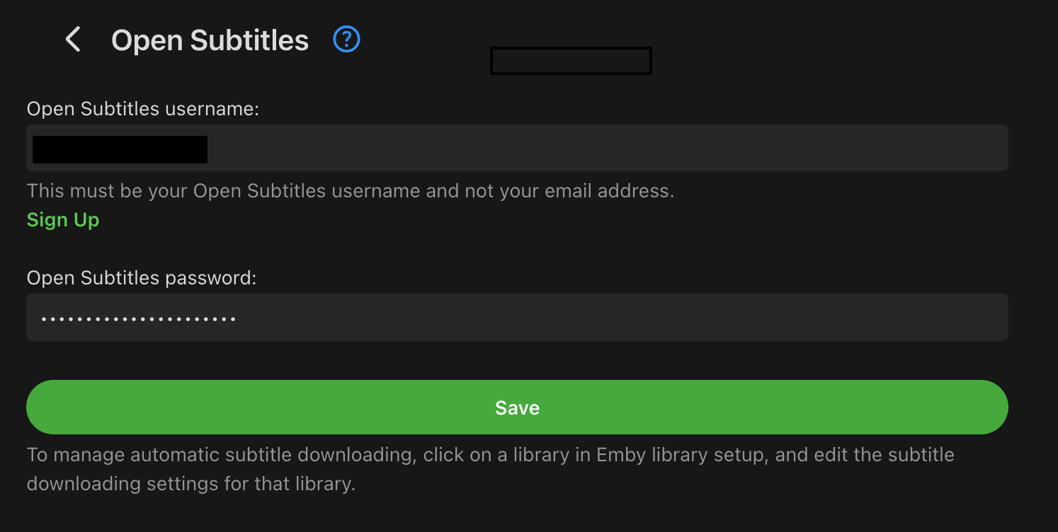

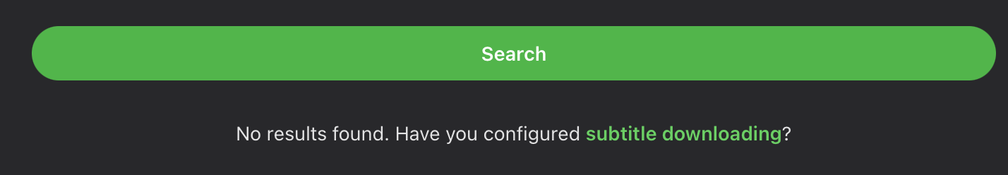

Gandalftw 2 Posted October 29, 2025 Author Posted October 29, 2025 (edited) Its there but I still get an error when searching for subs(the plugin is installed and configured user/password). Edited October 29, 2025 by Gandalftw
Gandalftw 2 Posted October 29, 2025 Author Posted October 29, 2025 (edited) Error SubtitleManager: Error searching for subtitles on Open Subtitles System.ArgumentException: System.ArgumentException: OpenSubtitles authentication failed. Please reconfigure your Open Subtitles username and password Edited October 29, 2025 by Gandalftw
Gandalftw 2 Posted October 29, 2025 Author Posted October 29, 2025 (edited) Solved. only if you move the mouse over the sign up you can see its opensubs.com and not .org, I used the .org creds how about writing it in the plugin ? or add a test button ? Edited October 29, 2025 by Gandalftw

Lessaj 486 Posted October 29, 2025 Posted October 29, 2025 It says .com already on the plugin configuration page where you enter your credentials. But I agree that a test button would be a good idea.
Gandalftw 2 Posted October 29, 2025 Author Posted October 29, 2025 (edited) Sorry ,I don't see it here , honestly I didn't know that there is a .com anyway Edited October 29, 2025 by Gandalftw 1
Lessaj 486 Posted October 29, 2025 Posted October 29, 2025 Interesting, maybe it's because I'm still on the 4.8 server but I do see the same as you on my 4.9 beta server. I'm surprised that it's different based on the server version but I guess it's possible, the plugin is 1.0.66 which is the latest I see for both. Sorry for the confusion. 1
