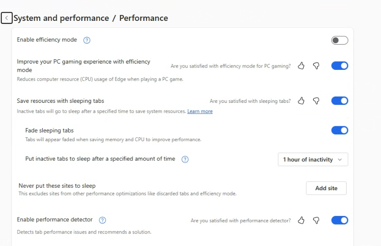

Neminem 1630 Posted October 27, 2025 Posted October 27, 2025 I wonder if this workaround fixes the Emby / Edge issue when sleeping. Enable, Disable Sleeping Tabs; Automatically suspend tabs in Edge But then again why should we have to do this 1
sa2000 703 Posted October 28, 2025 Posted October 28, 2025 19 hours ago, Neminem said: wonder if this workaround fixes the Emby / Edge issue when sleeping. Enable, Disable Sleeping Tabs; Automatically suspend tabs in Edge @Happy2PlayWhat do you have this set on your Microsoft Edge "edge://settings/system" setting For me it appears to be set to "Save resources with sleeping tabs" I am asking because with 3 clients playing media I have only got to 1.4Gb committed memory
Happy2Play 9814 Posted October 28, 2025 Posted October 28, 2025 (edited) 1 hour ago, sa2000 said: @Happy2PlayWhat do you have this set on your Microsoft Edge "edge://settings/system" setting For me it appears to be set to "Save resources with sleeping tabs" I am asking because with 3 clients playing media I have only got to 1.4Gb committed memory It appear to be set but per the last test I would say it did not work. 2025-10-28 05:19:11.013 Info SqliteUserRepository: Initializing PooledDatabaseConnectionManager with pool size: 3 2025-10-28 05:19:11.041 Info SqliteItemRepository: Initializing PooledDatabaseConnectionManager with pool size: 5 2025-10-28 05:19:11.043 Info AuthenticationRepository: Initializing PooledDatabaseConnectionManager with pool size: 5 2025-10-28 05:19:11.102 Info ActivityRepository: Initializing PooledDatabaseConnectionManager with pool size: 3 2025-10-28 05:19:14.659 Info SqliteItemRepository: Init Complete 2025-10-28 05:19:14.661 Info SqliteItemRepository: Opening sqlite connection to A:\Emby-Server\data\library.db. isReadOnly: True 2025-10-28 05:19:14.662 Info SqliteItemRepository: PRAGMA mmap_size=2147418112 2025-10-28 05:19:14.662 Info SqliteItemRepository: PRAGMA cache_size=-1048576 2025-10-28 05:19:14.662 Info SqliteItemRepository: PRAGMA page_size=4096 Edited October 28, 2025 by Happy2Play 1
sa2000 703 Posted October 28, 2025 Posted October 28, 2025 (edited) On 28/10/2025 at 12:23, Happy2Play said: t appear to be set but per the last test I would say it did not work. I can't get it to fail - It seems to remain active. I see in wireshark it is sending periodic requests for activitylog even though it is tabbed and not being displayed I can see what potentially the issue would be - emby server is sending a websocket packet every 1 to 2 seconds and the more sessions the bigger the packet - but for me they are being read by Edge - i have even reduced idle detection to 5 minutes and restarted edge For me it is remaining active as a tabbed browser session Any thoughts how I would make it go dormant ? Edited October 29, 2025 by sa2000

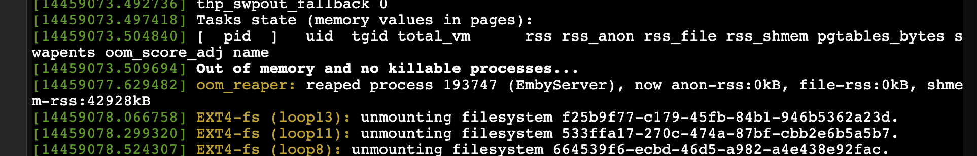

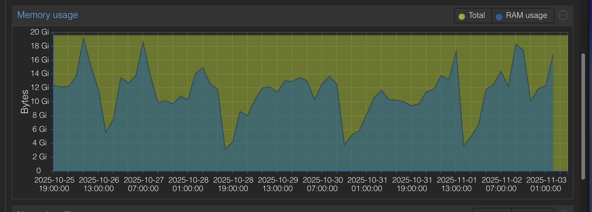

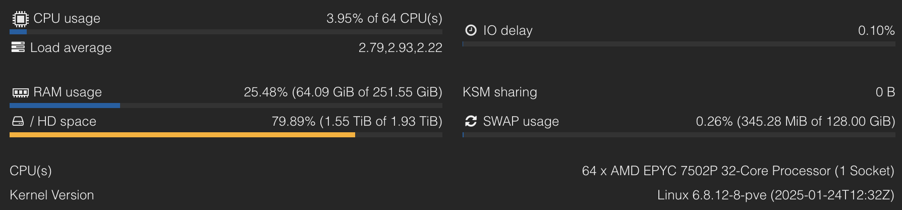

PixelWizard 7 Posted November 3, 2025 Posted November 3, 2025 (edited) I have more than 5 emby servers on 4.9.1.80 and all of them have problems with ram memory... i use Fedora and Ubuntu, I have Proxmox with emby servers with 16gb of ram. Before I used 4.8 and 4.9.1.10 and no have issue but now... is the hell. All of my servers run out of ram, laggy and unnusable and i dont know what more i can do. Not using plugins. First i think is machine problem, but i have 2 proxmox clusters, separetly in different places, different internet, different everything and on both my embys have problem with memory leaks, random stops and super laggy make servers unusable. Since 4.8 i used 16gb of ram and is enough, upgraded to 4.9.1.80 and start problems, i add more ram to my servers, 64gb ... same problem out of memory... my host have 256gb of ram bro, but emby never have enough I have exactly same issues in all my emby servers, start 1 week ago just when i upgrade them to 4.9.1.80. I attach a emby server log, but i think nothing interesting at all there. embyserver-63897724800.txt Edited November 3, 2025 by PixelWizard
sa2000 703 Posted November 3, 2025 Posted November 3, 2025 (edited) 7 hours ago, PixelWizard said: have more than 5 emby servers on 4.9.1.80 and all of them have problems with ram memory... i use Fedora and Ubuntu, I have Proxmox with emby servers with 16gb of ram. Before I used 4.8 and 4.9.1.10 and no have issue but now... is the hell. All of my servers run out of ram, laggy and unnusable and i dont know what more i can do. Not using plugins. First i think is machine problem, but i have 2 proxmox clusters, separetly in different places, different internet, different everything and on both my embys have problem with memory leaks, random stops and super laggy make servers unusable. Since 4.8 i used 16gb of ram and is enough, upgraded to 4.9.1.80 and start problems, i add more ram to my servers, 64gb ... same problem out of memory... my host have 256gb of ram bro, but emby never have enough I have exactly same issues in all my emby servers, start 1 week ago just when i upgrade them to 4.9.1.80. Thanks for the detail We are aware of memory use issues when scanning media libraries - more likely to occur when there are large libraries of TV / Music / Photos and the scanning of all libraries is scheduled to run through Scheduled Tasks - Most of these cases have been reported in this forum topic https://emby.media/community/index.php?/topic/142886-emby-ram-maxing-out/ - Until this is resolved, my advice would be to reduce the frequency of scheduled task "Scan Media Library" or disable it and rely on Library setting "Enable real monitoring" or do individual library scans/refreshes manually The other seen cause of high memory is the one reported in this forum topic relating to tabbed / suspended dashboard and the continuous Now Playing updates I suspect in your case, it is probably the library scans and you could enable debug logging and add logs to the forum topic I linked to confirm that it is to do with scanning. Logs provided would need to cover the period from launch until the time when the memory goes too high Edited November 3, 2025 by sa2000
