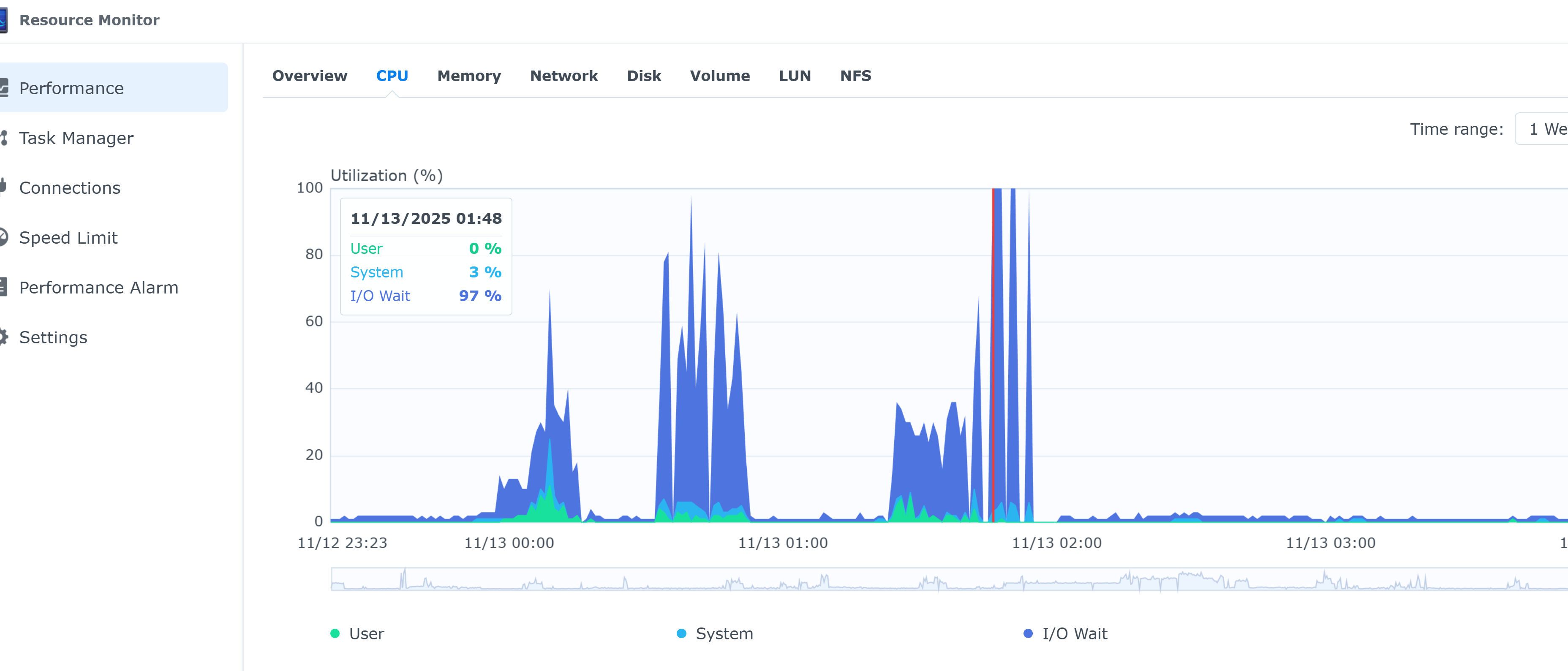

Kiniu 22 Posted November 13, 2025 Author Posted November 13, 2025 Hello there. Unfirtunately problem not solved.... i thiught that when i buy more RAM everything is going to be ok but it isnt, it happened again. i did a little research myself but im not a brainiac like you guys so i use common sense i try to find anything out of the ordinary and this is what i found: when i looked at memory i found nothing, network also in normal state but CPU was alarming: i/o wait cause emby to crash. as far as read about his it is cause by applicatio it self but that all i could understan maybe someone have an idea how to fix this? i want to also add that it happend when server was idle in the middel of the night - everytime, i attach logs as well. embyserver.txt
Luke 42239 Posted November 18, 2025 Posted November 18, 2025 Hi, please try removing these plugins: 2025-11-13 11:55:30.187 Info App: Loading Lastfm, Version=1.0.29.0, Culture=neutral, PublicKeyToken=null from /var/packages/EmbyServer/var/plugins/Lastfm.dll 2025-11-13 11:55:30.187 Info App: Loading statistics, Version=3.4.2.0, Culture=neutral, PublicKeyToken=null from /var/packages/EmbyServer/var/plugins/Statistics.dll 2025-11-13 11:55:30.188 Info App: Loading TvMaze, Version=4.8.12.0, Culture=neutral, PublicKeyToken=null from /var/packages/EmbyServer/var/plugins/TvMaze.dll Then restart the server and see how things compare. Thanks.
