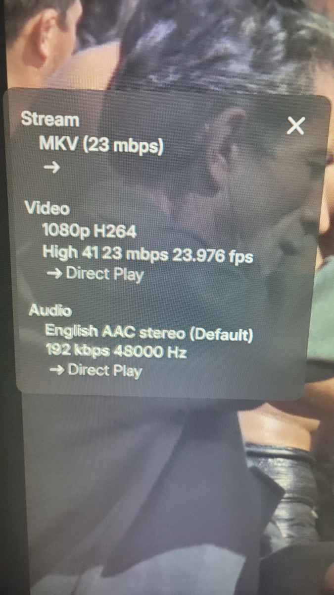

oceanclub 12 Posted October 25, 2025 Author Posted October 25, 2025 It's an MKV with 1080p x264 and AAC audio. One thing I'm confused about is that in the XBox One app's "stats for nerds", it shows as (expected) direct play, so there should be (?) no transcoding happening - see image attachment. But I have transcoding logs being produced. See logs attached, from about the time 15:36 onwards. I'd appreciate if anyone know what is going on here, Cheers, P. embyserver.txt ffmpeg-transcode-397c7ed7-c238-42cc-8f4c-ae235f54abba_1.txt ffmpeg-transcode-f76433a2-a55c-44b1-98c9-6a5545f6d70a_1.txt
