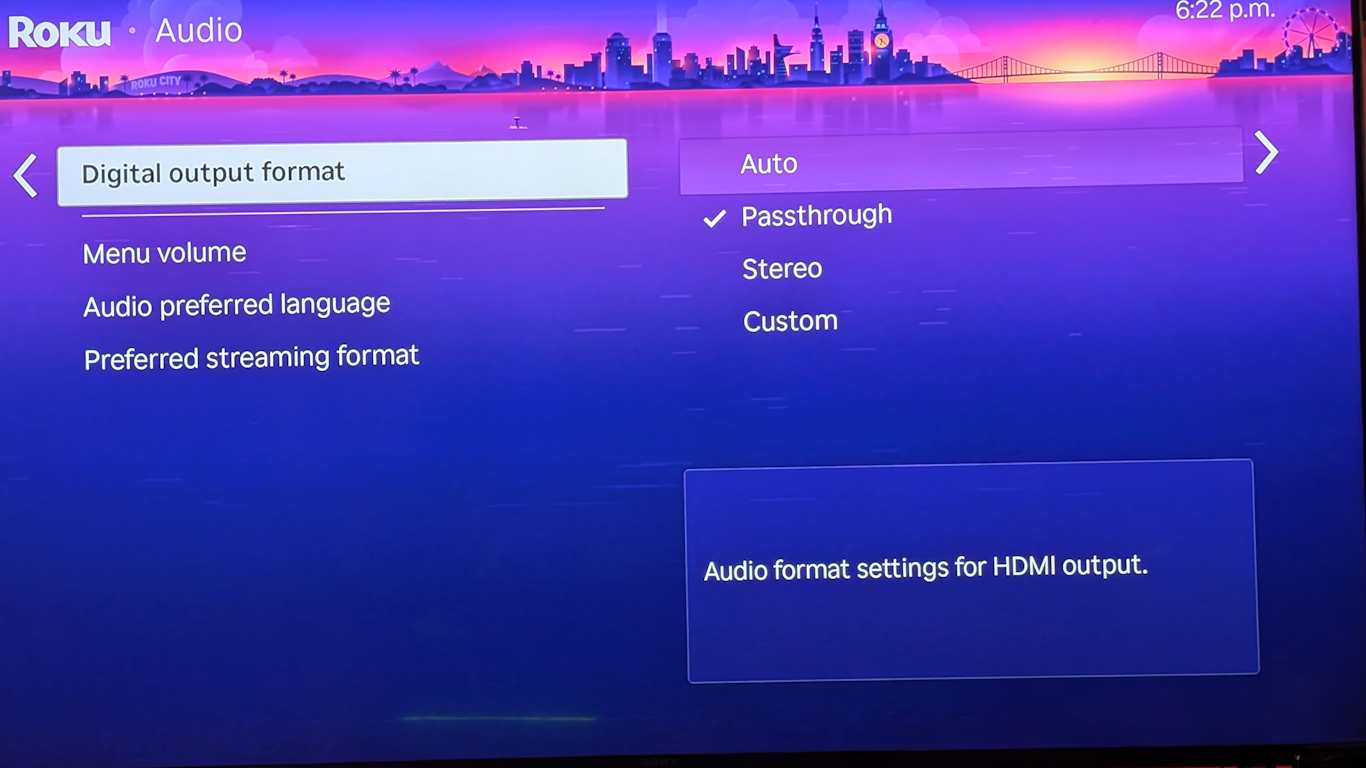

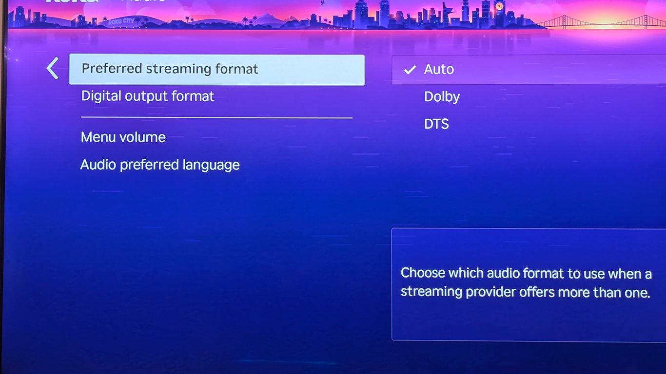

tedfroop21 89 Posted October 26, 2025 Posted October 26, 2025 Setup on my ultra boxes looks like this:
MichaelK79 5 Posted October 26, 2025 Author Posted October 26, 2025 @speechles Thanks for your reply. I want to provide the clearest picture I can. Roku Streaming Stick HD model 3840R plugged into a Denon AVR-S970H. The AVR is fully capable of taking in the audio signal as sent through emby from my miniPC. This problem is only present when flowing through the Roku stick. 14 minutes ago, speechles said: The app won't transcode to AAC in 5.1. Do you mean AC3? No. For this one specific video that has DTS mono emby sends the audio as direct play. The AVR shows DTS and the video is stuttering. However since that video stream is over 8Mbps in total, if I set a playback cap at "1080p FHD - 8 Mbs" it will then transcode. When transcoding in the stats for nerds it shows "Throttling. Reducing bitrate due to quality setting." It also shows "DTS mono (Default) > Transcode (AAC 5.1 192 Kbs)." Now the video plays fine, smooth. But that is still a problem. I will note one caveat though since I dont know if this might affect the behavior here. The mediainfo for this specific video show the audio channel as mono 1 / 6. That could be a problem but I have no idea. I dont really want to fixate on this one single video. My other videos are also having issue unless I restrict the stream to force an audio transcode. That just seems super off to me. 26 minutes ago, speechles said: How did you set up your Roku audio settings? Have you told the Roku you support DTS pass-through? The Emby app for Roku reads the audio capabilities directly from the Roku device. Whatever settings are set in the Roku settings are inherited into the Emby app and considered when transcoding must occur. Sometimes you can set these to AUTO on the Roku settings and everything works. Other times you must choose CUSTOM and pick which codecs will be supported for pass-through. DTS is a pass-through codec. The Roku may notice this is not available and on-the-device it changes this to AAC. Certain Roku models do convert unsupported codecs into AAC 5.1. This is a totally valid question/statement. I did in fact check those and tried in all manor of setting. Obviously it was on Auto to begin with. I have since tried every combination of setting to be deliberate. Using the custom settings to select DD or DD+ or allowing DTS etc. Nothing fixes this issue for me. I will recreate it with debug enabled and see about collecting the log for you now. Thanks! Michael
MichaelK79 5 Posted October 26, 2025 Author Posted October 26, 2025 @tedfroop21 Thanks for trying to help. Neither my Roku Ultra 4670X nor this newer Roku Streaming Stick 3840R have the Passthrough option within the Audio settings menu. I have been through nearly every setting possible at this point. Thanks, Michael
