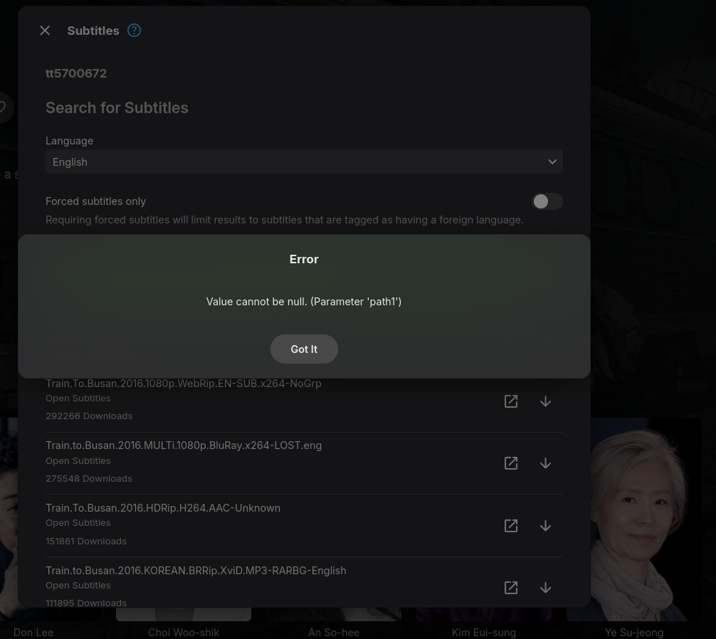

stuffie 1 Posted October 25, 2025 Posted October 25, 2025 When attempting to download subtitles i get the following error logs.txt

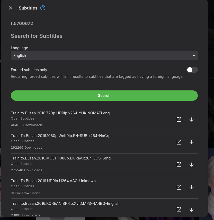

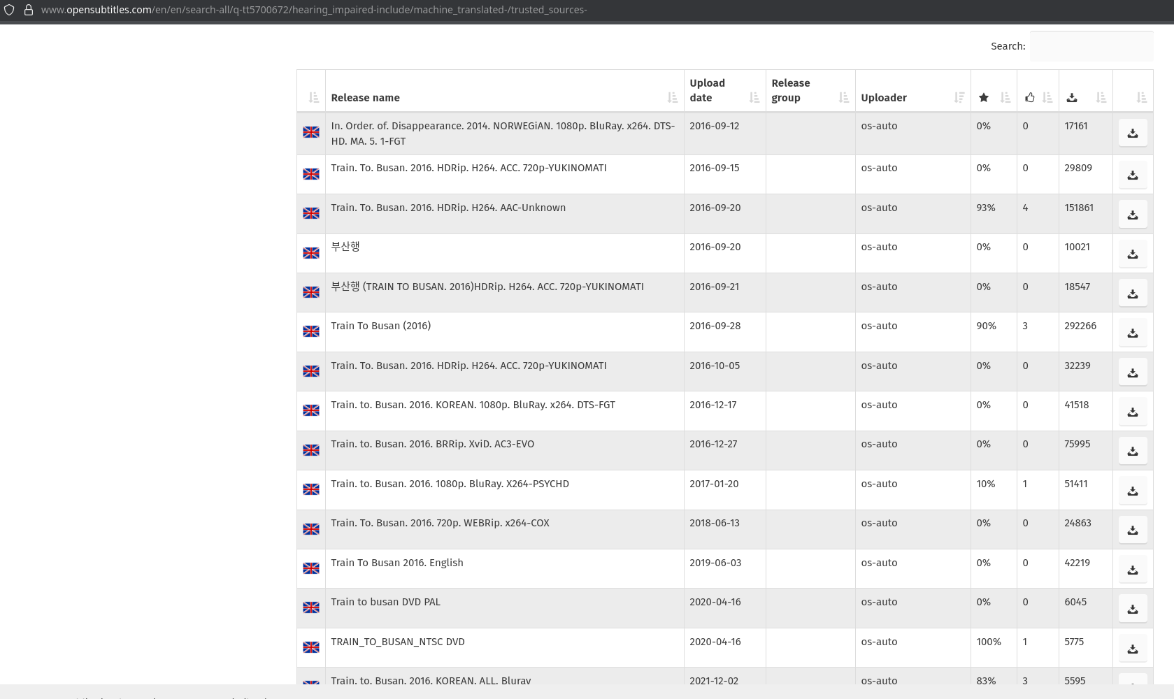

stuffie 1 Posted November 4, 2025 Author Posted November 4, 2025 also seems to be an issue with most of my library i have tried other movies and other subtitles to no avail. screenshots from the search results are attached, On 10/27/2025 at 4:33 PM, Luke said: @stuffiewhat exactly did you check? What did you find? i used tt5700672 to look up the subtitles on opensubtitles.com, also i have VIP so i have increased limit for downloads, for which i am nowhere near my limit.
Luke 42242 Posted November 4, 2025 Posted November 4, 2025 26 minutes ago, stuffie said: also seems to be an issue with most of my library i have tried other movies and other subtitles to no avail. screenshots from the search results are attached, i used tt5700672 to look up the subtitles on opensubtitles.com, also i have VIP so i have increased limit for downloads, for which i am nowhere near my limit. Hi there, please attach the Emby server log from when the problem occurred: How to Report a Problem Thanks!
stuffie 1 Posted November 4, 2025 Author Posted November 4, 2025 37 minutes ago, Luke said: Hi there, please attach the Emby server log from when the problem occurred: How to Report a Problem Thanks! logs attached embyserver(2).txt
stuffie 1 Posted November 4, 2025 Author Posted November 4, 2025 23 minutes ago, Luke said: Are these video files in your library? its a .strm file which points to my iptv provider 1
