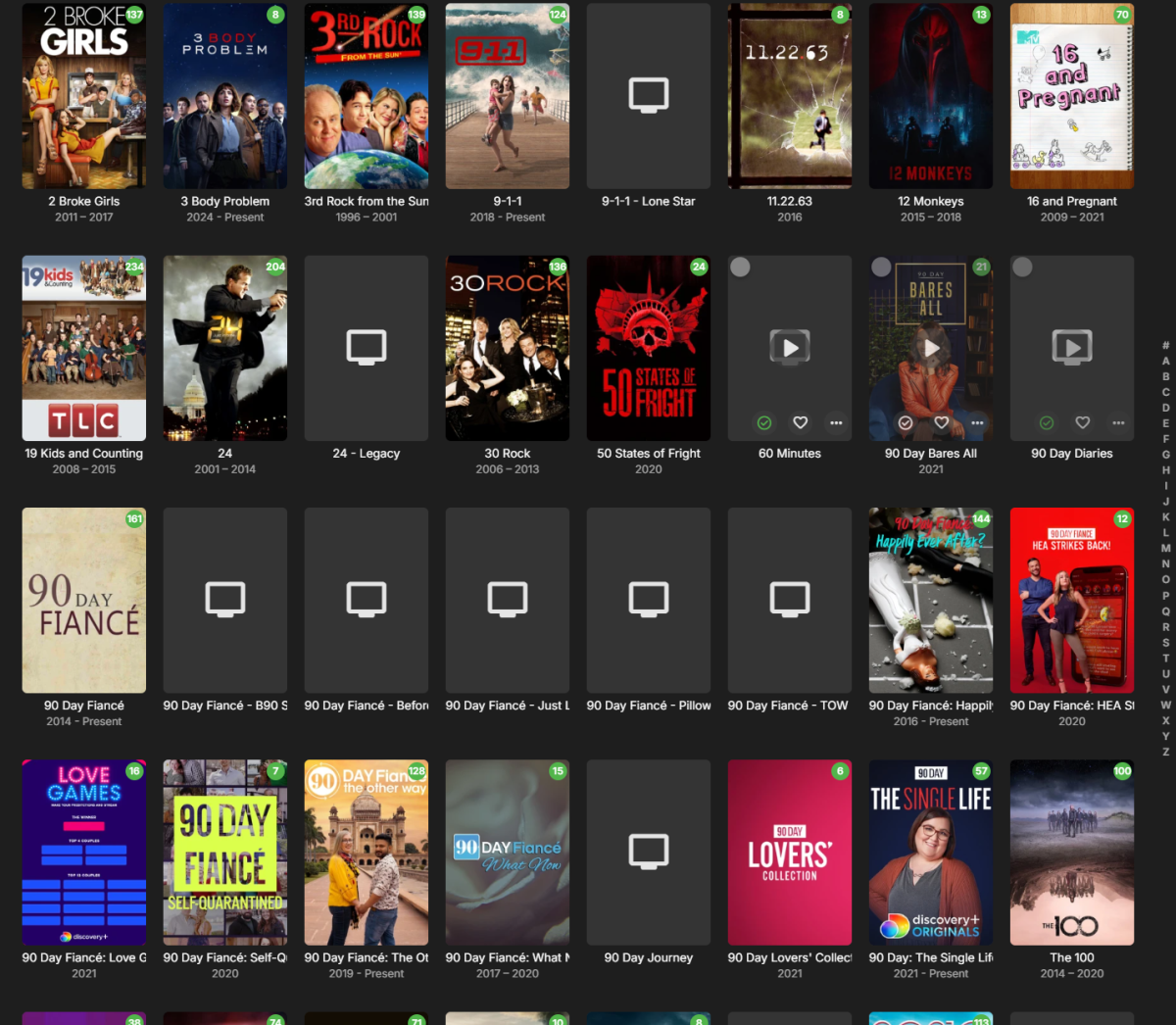

byusinger84 1 Posted October 25, 2025 Posted October 25, 2025 (edited) Hi there. Starting my own thread here, though this was discussed in another topic with no solution. Really strange issue that just started happening out of the blue sometime around the 6th or 7th of October. TV shows appear to be missing even though they've been working perfectly fine for a long time. I have a single folder for all TV shows. My Emby server config really hasn't been touched since I setup this new server in March 2025, however, I have been using Emby since it was MB (Mediabrowser) way back in the mid to late 2000s. Emby has generally always been set it and forget it, so I was surprised when a user on my server showed me the behavior seen in this screenshot: When I try to run a manual library scan, it does not resolve the issue. I did try to remove the library and recreate it, but the behavior persisted. I'd rather not do it again as it takes days and days, and I'm unsure if folks will lose their watched status, though I guess if that was the case it's probably too late. Server logs attached. Server is running Server 2025 Standard. Files are stored on a TrueNAS server and shared via SMB. The server account that runs Emby has full access to the folder/files. I can confirm all files play just fine if I go to the folder and run manually. File structure has not changed in over a decade, but just so we're clear it's D:\Shares\TV\Name of Show\Season X\Episode Name - SxxExx.xyz. embyserver.zip Edited October 25, 2025 by byusinger84

byusinger84 1 Posted October 27, 2025 Author Posted October 27, 2025 (edited) I took the liberty of running my logs (prior logs plus today's) through ChatGPT. It noted that The TVDB appeared to have some kind of issue/outage as it was returning hundreds of "Error App: Error in TheTVDB … MediaBrowser.Model.Net.HttpException: BadRequest" over and over and over as well as "Error ImageService… System.NullReferenceException at Emby.Api.Images.ImageService.GetImage(...)." Moreover it noted looking between the logs: TheTVDB responses switched from frequent 400 errors to almost all 200 OKs, meaning their API endpoint recovered. The same image fetches (api4.thetvdb.com/v4/series/...) are now returning successfully with valid JPEGs being saved Not sure what to make of all this as it's over my head other than maybe there has been some issues with The TVDB causing this behavior? But then again, why would this have occurred with all my metadata saved to the folders where my media is stored? I would assume it would just cache what's there first and then fill in missing data? Very strange. Edited October 27, 2025 by byusinger84

Luke 42288 Posted November 13, 2025 Posted November 13, 2025 @byusinger84and what exactly is missing from the big bang theory?
Solution byusinger84 1 Posted November 13, 2025 Author Solution Posted November 13, 2025 Hi @Luke. Nothing is missing. The files play just fine when I go direct to the source. That said, I found out the issue. Turns out, TrueNAS, which is where I host my data, has a major bug on the latest 25.10.0 release. (see this forum post: https://forums.truenas.com/t/nfs-and-smb-share-lag-on-connect-since-25-10-upgrade-from-linux-windows-clients/57692/76) They are working on a fix, but by downgrading I was able to resolve my issue. This is NOT an Emby problem. And I will now mark this as resolved. Thank you!
