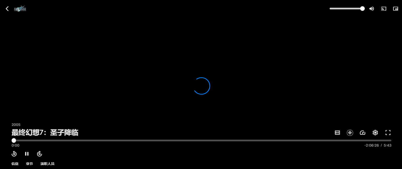

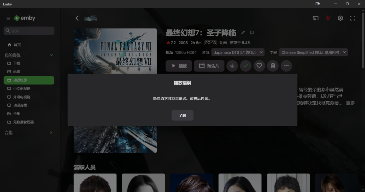

       Recently, my Emby program has integrated the STRM+HTTP 302 Redirect functionality. This feature primarily utilizes relevant software to generate STRM files for video files stored on network drives, then downloads them to the Emby server. The client then uses HTTP 302 Redirect technology to directly access the video files stored on the network drive. This significantly reduces server read/write load. However, we've encountered an issue: while this technology works flawlessly on Emby clients for Android and iOS systems, it fails to play videos properly on Windows 10 and Windows 11 systems using Chrome, Microsoft Edge, or the Emby for Windows client. We hope you can provide an effective solution.

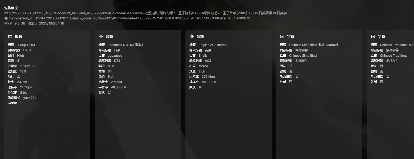

This image contains STRM file information; Emby can successfully extract the video's media information.
When playing videos, Microsoft Edge just keeps loading like this.
Emby for Windows cannot play videos.

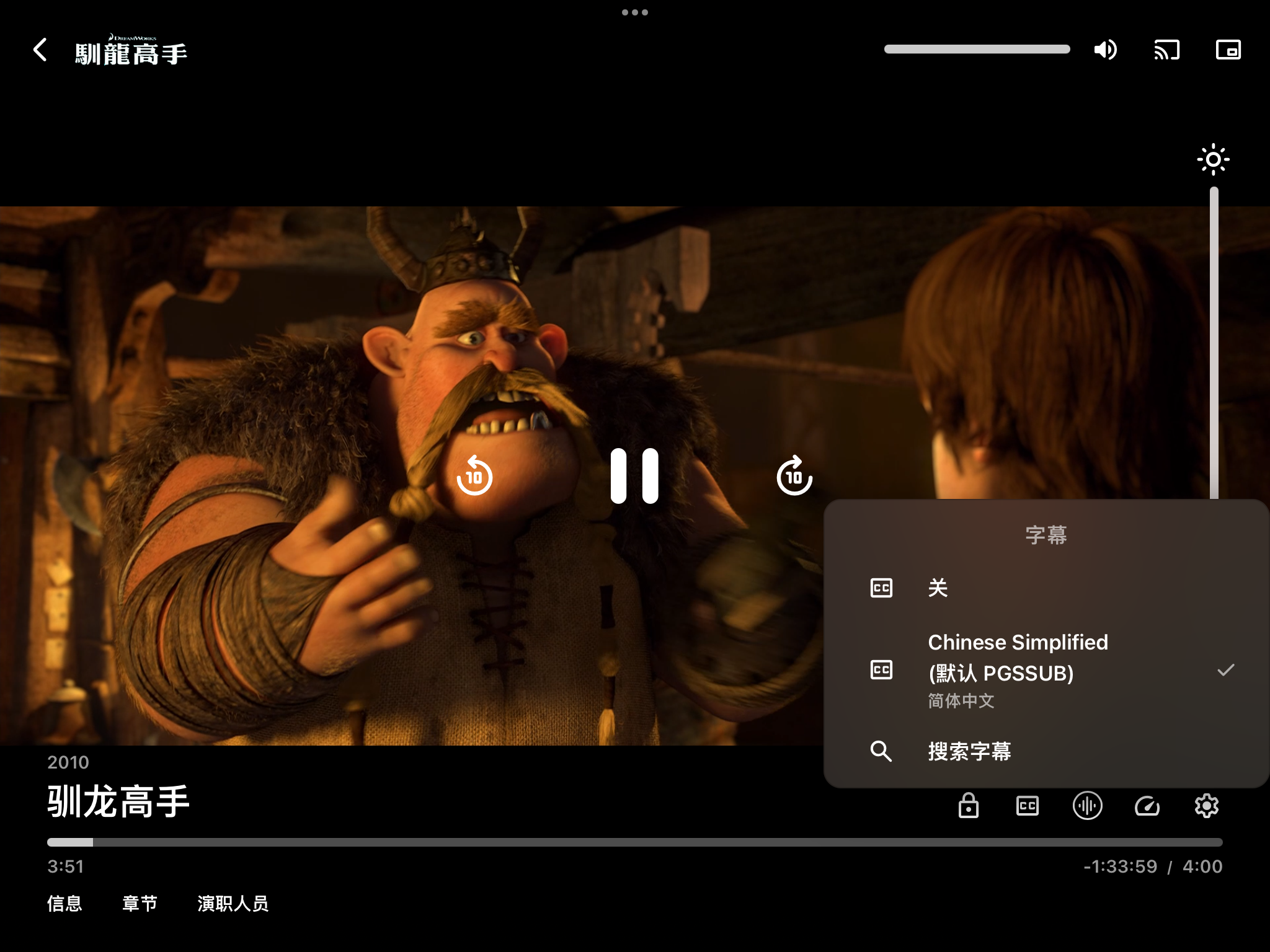

1. Apple iPad
1.1 Playback is normal, but it automatically exits once when switching audio languages.
1.2 Subtitles display correctly during playback sometimes, but fail to appear at other times.

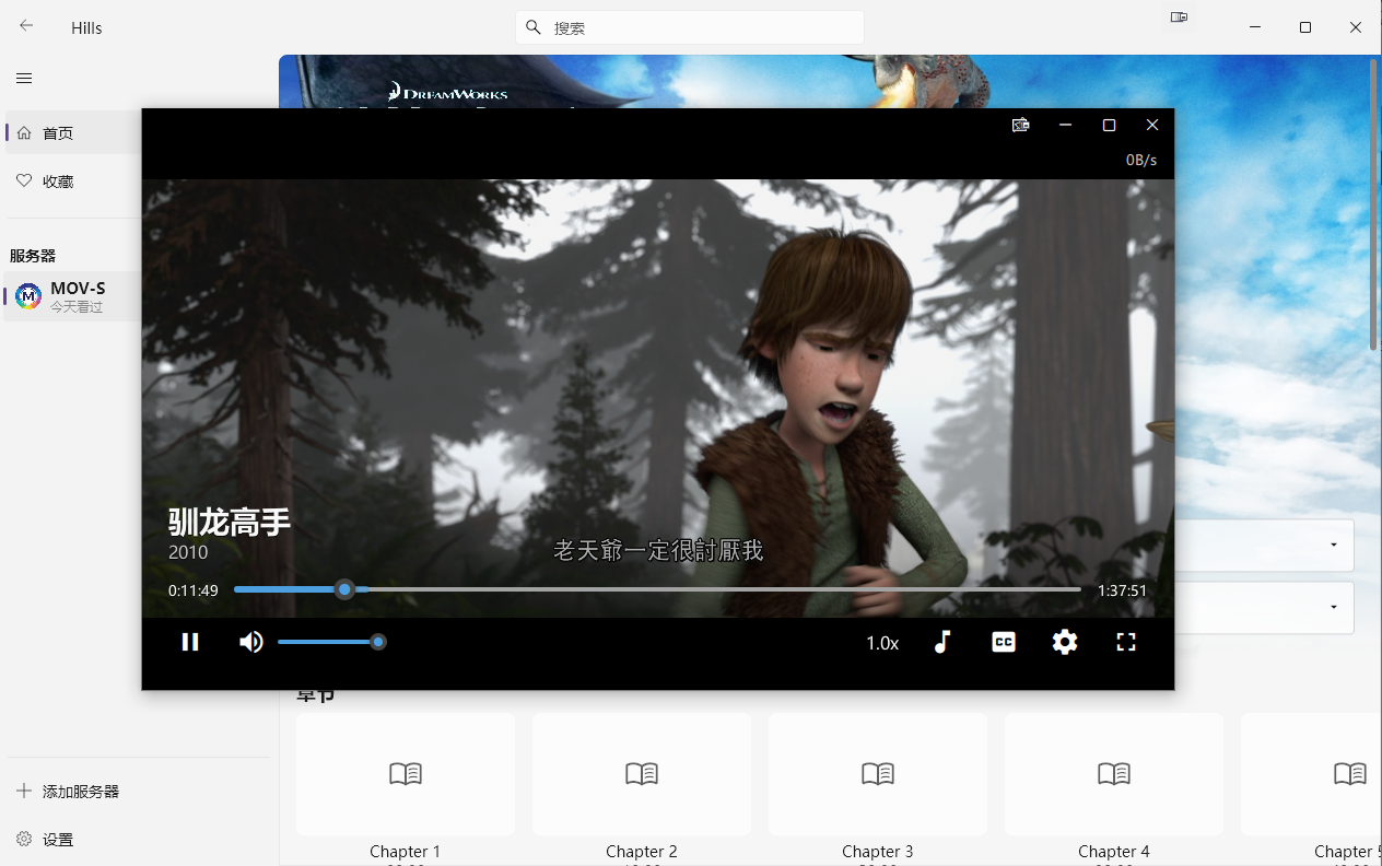

5. Unofficial Player Hills
Playback is normal with proper audio and subtitles, and the playback is very smooth.
