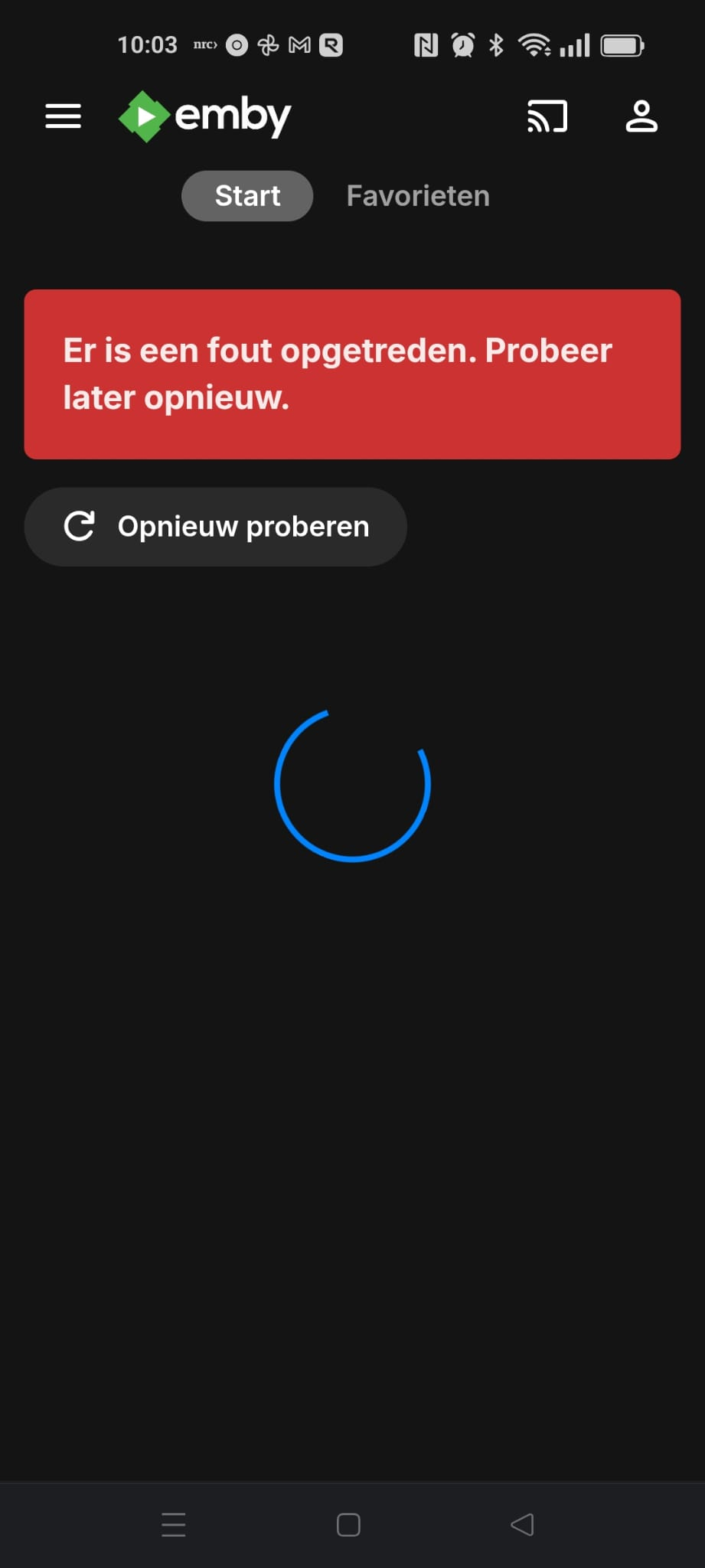

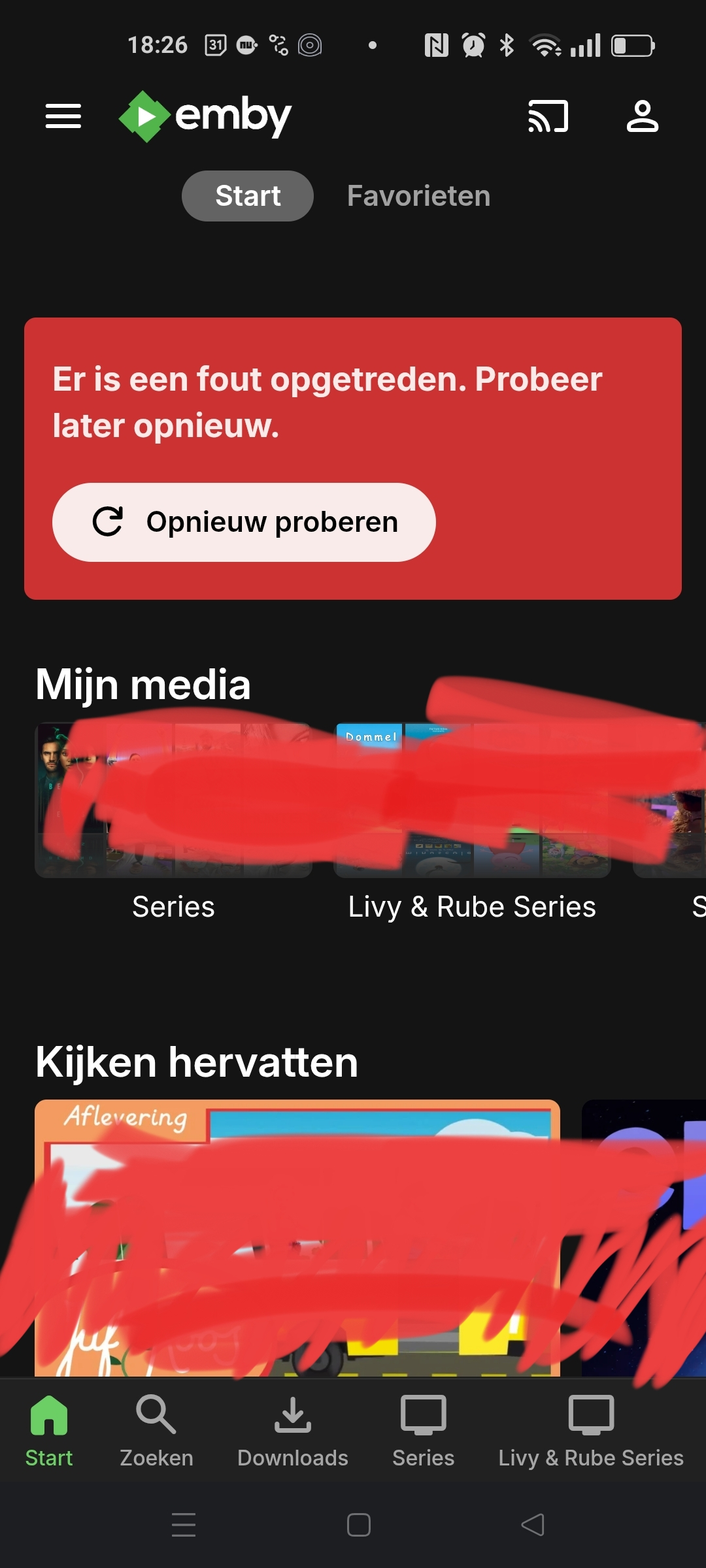

Davey's 40 Posted October 20, 2025 Posted October 20, 2025 Today ive got this two unknown screens shortly after eachother swiped away Emby and start again (never seen before in Emby)

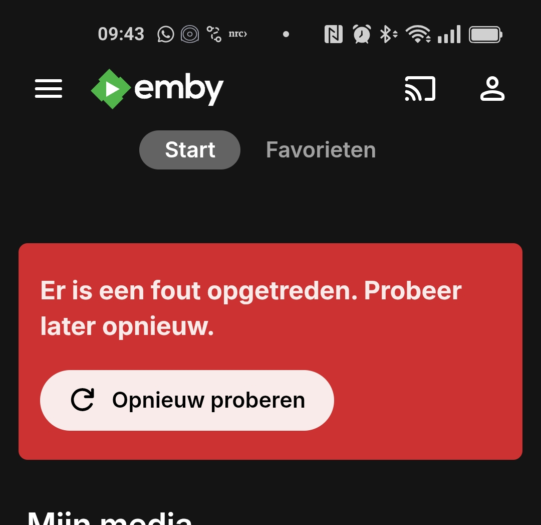

Davey's 40 Posted October 28, 2025 Author Posted October 28, 2025 When I discovered it I immediately took a screenshot and downloaded the log. Earlier this afternoon I was still playing content via Emby on my Android.

Davey's 40 Posted October 29, 2025 Author Posted October 29, 2025 Just to clarify... the moment I took the screenshot and downloaded the log I immediately posted this yesterday 'Posted yesterday at 03:43 PM' 1
Davey's 40 Posted November 3, 2025 Author Posted November 3, 2025 (edited) This was Saturday morning 09:44 GMT+1 Dutch time, I immediately saved and added the log file from my Android device Edited November 3, 2025 by Davey's clarification

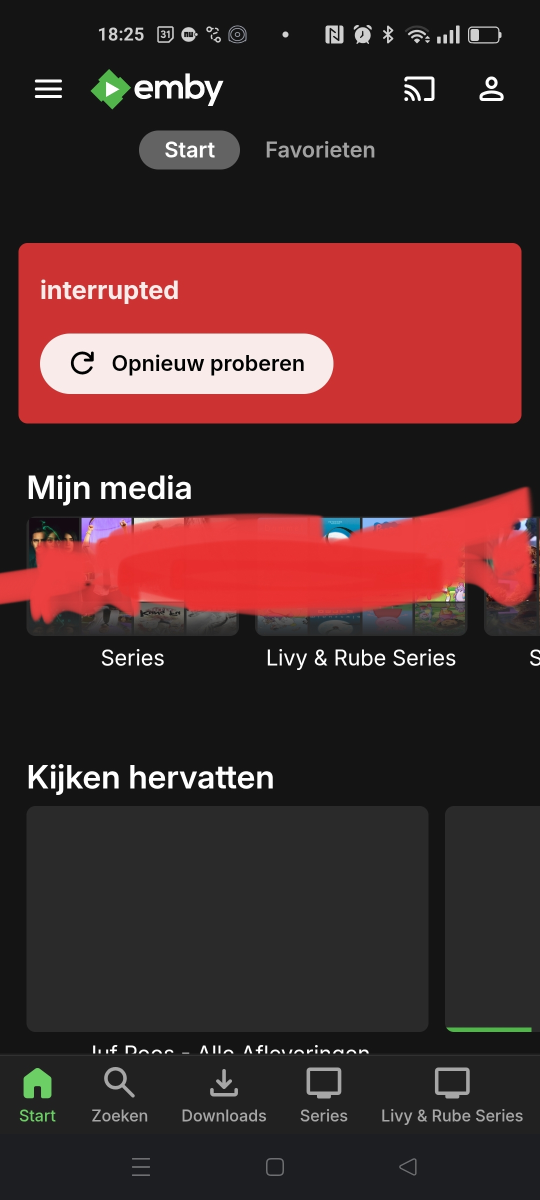

Davey's 40 Posted November 3, 2025 Author Posted November 3, 2025 it happens again (on android) emby_android_1762160576214.txt

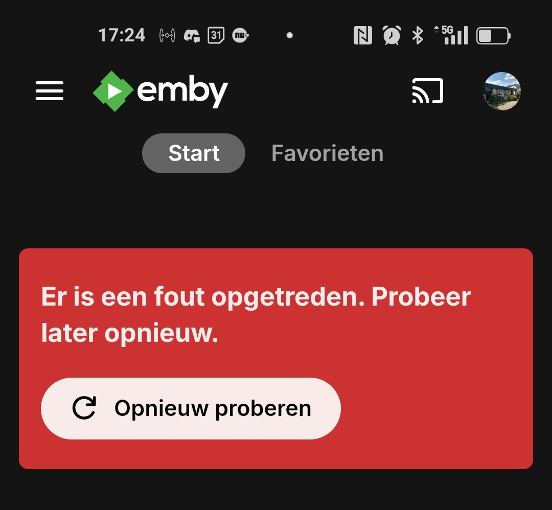

Davey's 40 Posted December 1, 2025 Author Posted December 1, 2025 Today I encountered the problem again
