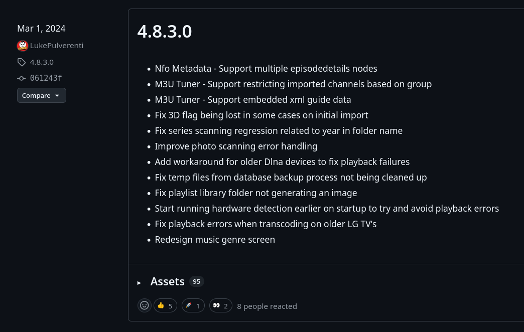

RIP314 2 Posted October 21, 2025 Author Posted October 21, 2025 34 minutes ago, Luke said: 4.8 runs on dotnet 6. 4.9 runs on dotnet 8. i guess i'm doing something stupid here, but I went to the old releases github page, I downloaded the zip file for an old server version (embyserver-win-x64-4.8.11.0), when I unzip it I get a system folder for emby, so I replaced my system folder in appdata with this old version, but it won't load, the emby logo pops up in the browser and nothing more happens. I tried removing the programdata, this triggers the wizard page, but again i just get the emby logo and nothing else happens, what am I doing wrong?
Clackdor 110 Posted October 21, 2025 Posted October 21, 2025 15 minutes ago, RIP314 said: i guess i'm doing something stupid here, but I went to the old releases github page, I downloaded the zip file for an old server version (embyserver-win-x64-4.8.11.0), when I unzip it I get a system folder for emby, so I replaced my system folder in appdata with this old version, but it won't load, the emby logo pops up in the browser and nothing more happens. I tried removing the programdata, this triggers the wizard page, but again i just get the emby logo and nothing else happens, what am I doing wrong? If you upgraded from 4.8 to 4.9 then you won't be able to downgrade back to 4.8 since there are numereous database and other changes that are incompatible. The only way to go back down to 4.8 is to either restore from a backup taken prior to the upgrade or to start fresh.
RIP314 2 Posted October 21, 2025 Author Posted October 21, 2025 21 minutes ago, Clackdor said: If you upgraded from 4.8 to 4.9 then you won't be able to downgrade back to 4.8 since there are numereous database and other changes that are incompatible. The only way to go back down to 4.8 is to either restore from a backup taken prior to the upgrade or to start fresh. starting fresh is fine, but how? I don't see an old server .exe file anywhere, I explained the github thing unless I'm missing something I can't seem to find an .exe file for an old version

Gilgamesh_48 1244 Posted October 22, 2025 Posted October 22, 2025 3 hours ago, RIP314 said: starting fresh is fine, but how? I don't see an old server .exe file anywhere, I explained the github thing unless I'm missing something I can't seem to find an .exe file for an old version starting fresh is fine, but how? I don't see an old server .exe file anywhere, I explained the github thing unless I'm missing something I can't seem to find an .exe file for an old version To remove Emby before a fresh start you do that the same way that you would delete any program. Left click on the program's icon Choose remove from the dropdown The next step may change a bit from what I do because my system's menus behave a little weird at times. Find Emby in the resulting list Left click on its icon. Then choose delete from the diaglog Then choose "delete all traces" When the remove program is finished then just install get the Emby installer from the Emby website run it and you should be golden.

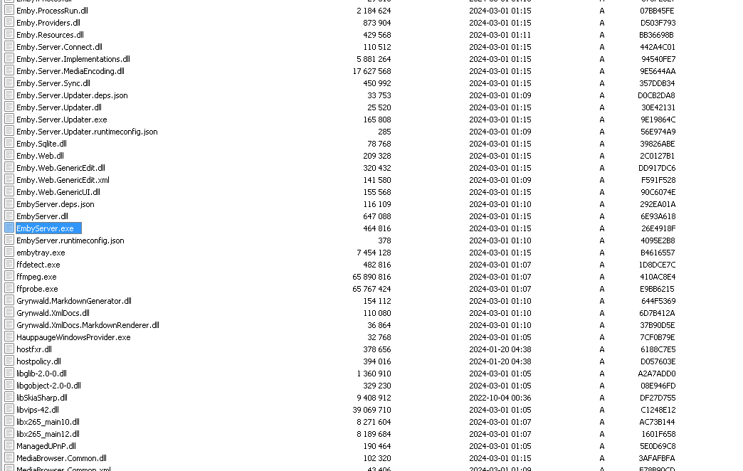

Suliamu 41 Posted October 22, 2025 Posted October 22, 2025 The EmbyServer.exe is inside the .7z-file of the corresponding release. And the releases can be found on github. When you cannot see it, check the options of your 7z-extracting-program and filemanager in your operating system.
