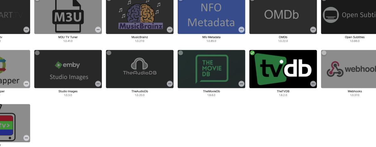

Zedderftw 1 Posted October 20, 2025 Posted October 20, 2025 When I try to manually identify I get "No items matching your search criteria were found." The app doesn't seem to be connected to tvdb at all. I can connect to thetvdb.com in my browser, and have tried turning off my firewall. I have tried uninstalling and reinstalling the plugin, have restarted the server. embyserver.txt

Zedderftw 1 Posted October 20, 2025 Author Posted October 20, 2025 2 hours ago, GrimReaper said: Edit: I can see your episodes updates further down and no calls being made to any provider, check that your TV Shows library meta-downloaders are still enabled (in case they got disabled upon server update); if they are, try unticking/ticking them back again and try to refresh an item afterwards, see how does that compare This is the issue. The TV meta is not working at all. I have uninstalled and reinstalled and enabled afaik. I'm unable to even manually identify tv shows (but movies still work as they should)
GrimReaper 4926 Posted October 20, 2025 Posted October 20, 2025 10 minutes ago, Zedderftw said: I have uninstalled and reinstalled and enabled afaik. Have you tried doing this? 2 hours ago, GrimReaper said: try unticking/ticking them back again and try to refresh an item afterwards
Solution GrimReaper 4926 Posted October 20, 2025 Solution Posted October 20, 2025 3 minutes ago, Zedderftw said: Do you mean here? No. 4 hours ago, GrimReaper said: check that your TV Shows library meta-downloaders are still enabled (in case they got disabled upon server update); if they are, try unticking/ticking them back again Settings>Library tab in the sidebar>Edit (or left-click library thumb) your TV Shows library>untick and tick again TVDB, TMDB, OMDB (whatever meta-downloaders you have enabled). 1
