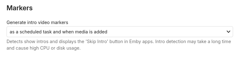

UsamaWaheed 12 Posted October 19, 2025 Posted October 19, 2025 Description / Background: All my libraries (Anime, Movies, TV Series) are scanned and with Detect Intro enabled. I have enabled the generate intro video markers for all the libraries. Generate intro video markers → scheduled task enabled & when file is added” enabled Issue Example: For Slow Horses – Season 1 (6 episodes): No Skip Intro button appears when playing. Intro normally starts at ~4–5 minutes into the video (well within the 10-minute cutoff). Season 1 meets the minimum requirement of 2 episodes I have 6 episodes. Video thumbnails have already been generated successfully. I manually ran Detect Intro Video Markers task → finishes instantly (0 seconds), suggesting it thinks markers already exist or nothing to do. Expectation: Skip Intro markers should be generated and visible for Slow Horses S01E01–E06. What I Tried: Verified video thumbnails exist for the episodes. Manually ran the scheduled task multiple times. Rescanned the library. Confirmed minimum episode count is met and intro is within first 10 min. Just FYI if this is any useful information - plex detected the intro for all.
