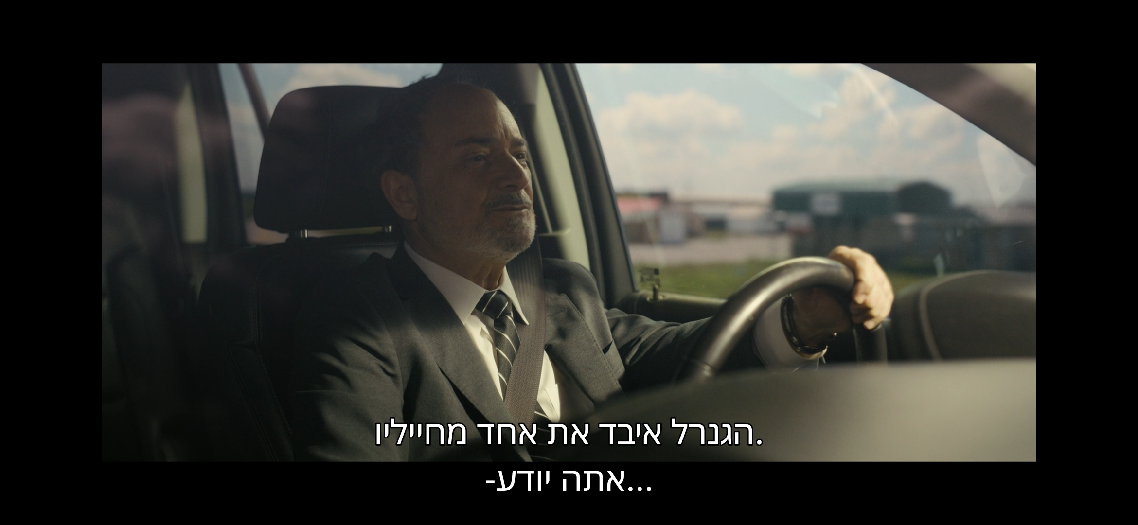

adir4289 2 Posted October 19, 2025 Posted October 19, 2025 (edited) When playing Hebrew subtitles (RTL) during transcoded playback, punctuation marks appear on the wrong side (e.g. periods, commas, hyphens). Example: > הגנרל איבד את אחד מחייליו. אתה יודע- appears with reversed punctuation only when transcoding — direct play looks fine. Details: Subtitle format: SRT (UTF-8) Language: Hebrew (RTL) OS: Android 16 Phone. Happens on transcoded streams only Direct play → OK Seems like ffmpeg or Emby’s subtitle renderer mishandles RTL text direction during transcoding. Edited October 19, 2025 by adir4289

adir4289 2 Posted October 21, 2025 Author Posted October 21, 2025 (edited) On 10/19/2025 at 11:26 PM, Luke said: Hi there, let's look at an example. Please attach the information requested in how to report a media playback issue. Thanks! Title: RTL subtitles punctuation rendering wrong when transcoding (Hebrew SRT) Description: When playing Hebrew subtitles (RTL) during transcoded playback, punctuation marks appear on the wrong side (for example periods, commas, hyphens). For example: > הגנרל איבד את אחד מחייליו. אתה יודע- This appears with reversed punctuation only when transcoding — direct play looks fine. Details: Subtitle format: SRT (UTF-8) Language: Hebrew (RTL) Client OS: Android 16 (Phone) Issue occurs on transcoded streams only Direct play → OK It seems like either the transcoder (FFmpeg) or Emby’s subtitle renderer is mishandling RTL text direction during transcoding. Steps to reproduce: 1. Start playback of a Hebrew-language media file with accompanying Hebrew SRT subtitles. 2. Force transcoding (client device/settings require it). 3. Observe that punctuation (periods, hyphens, commas) appear on the wrong side in the subtitle display. 4. Stop transcoding or switch to direct‐play mode; the issue disappears (punctuation appears correctly). Impact: This is a visual/text readability bug specifically affecting RTL languages during transcoding. For Hebrew subtitles, punctuation placement is critical for readability; when punctuation flips sides the meaning/layout is confusing. This reduces usability for users who rely on subtitles in RTL languages. Requested outcome: Please investigate the RTL subtitle rendering path during transcoding. Specifically: Whether FFmpeg (or the subtitle overlay engine) is mixing LTR/RTL directionality incorrectly for transcoded output. Whether Emby Server has a subtitle renderer flag or configuration for RTL text that is being ignored or mis‐applied when transcoding. A fix or workaround (e.g., ensure RTL markers, embed proper directionality, or adjust rendering order) so that Hebrew (and other RTL) subtitles display punctuation correctly during transcoding. Edited October 21, 2025 by adir4289
adir4289 2 Posted October 21, 2025 Author Posted October 21, 2025 Update: After further testing, it appears that the issue occurs only with subtitles encoded in ANSI. Subtitles encoded in UTF-8 seem to display correctly and do not have this problem.

adir4289 2 Posted October 28, 2025 Author Posted October 28, 2025 1 hour ago, Luke said: HI, why not just encode them in utf8 then? Sorry for the confusion - after checking again, it seems that even UTF-8 subtitles are not rendered correctly.

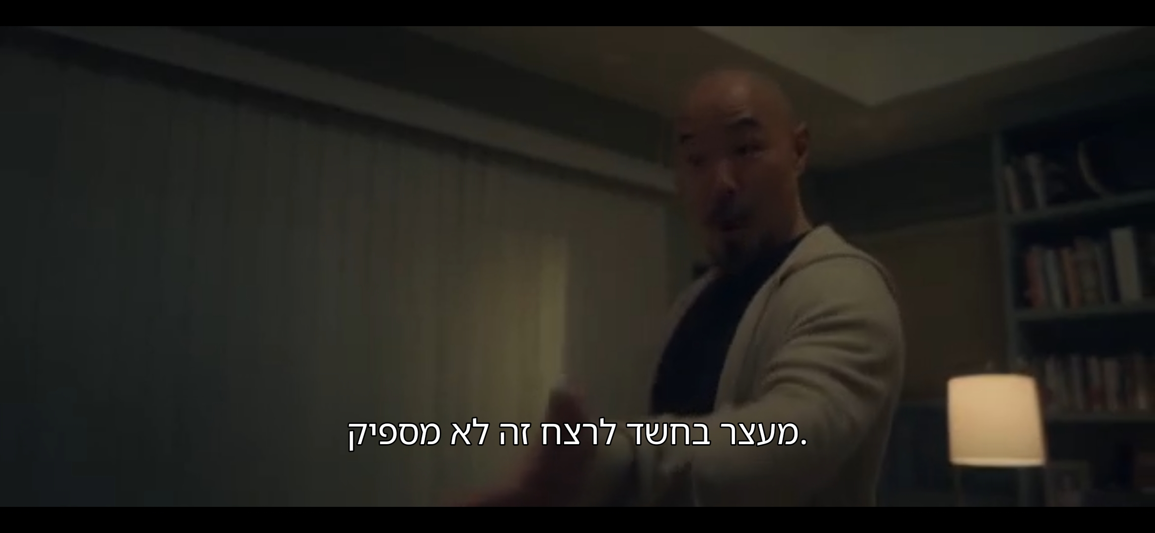

adir4289 2 Posted December 25, 2025 Author Posted December 25, 2025 On 11/20/2025 at 10:46 PM, Luke said: Hi, have you updated to Emby Server 4.9.1.90? has that helped? Hi Luke, everything worked great for a while, but latley the problem reappeared again

adir4289 2 Posted December 27, 2025 Author Posted December 27, 2025 On 12/26/2025 at 8:27 PM, Luke said: HI there, can you please provide a specific example? How to Report a Problem Thanks ! hi, i attached the subtitles here subs.zip
