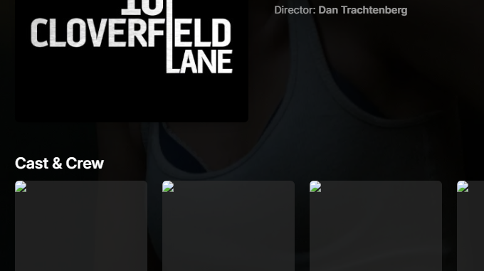

DarinM 11 Posted October 19, 2025 Posted October 19, 2025 Today I updated my server from Rocky Linux 8 to 10. I backed up the data files from /var/lib/emby/data and then wiped the drive and reinstalled. I've completed the install and set up hardware encoding. It's all working well. I put the data files back in place and while the settings are all proper and all there, the metadata is not. I probably did something wrong there. So, I've been going to each library and telling it to refresh the metadata. It seems to do it part way.. I can go into the library and the poster pics are all there.. But, if I choose a video, the cast & crew pics are not. I have to refresh metadata from there and then it refreshes. I really don't want to have to do that for all the items I have. Is there an easy way to force it to do all of them?

DarinM 11 Posted October 19, 2025 Author Posted October 19, 2025 I think I found the problem in the logs.. This error is from a metadata update: Here's the error: ----------------------------------------------------------------------------------------------------------------------------------------------------------------------------------------------------------------------------------------------------------------------------------- 2025-10-19 09:06:13.967 Info ImageService-0HNGF1R5J3E4A:0000000A: http/1.1 Response 404 to 192.168.1.40. Time: 18ms. GET http://192.168.1.10:8096/emby/Items/342262/Images/Primary?maxHeight=300&maxWidth=200&tag=81e67744d82d684b2efb5bc7b04b0628&quality=90. 2025-10-19 09:06:13.967 Info HttpClient: GET https://artworks.thetvdb.com/banners/v4/season/2140583/posters/6807e7c318aa1.jpg 2025-10-19 09:06:13.967 Error ImageService-0HNGF1R5J3E47:0000000E: Error processing request *** Error Report *** Version: 4.9.1.80 Command line: /opt/emby-server/system/EmbyServer.dll -programdata /var/lib/emby -ffdetect /opt/emby-server/bin/ffdetect -ffmpeg /opt/emby-server/bin/ffmpeg -ffprobe /opt/emby-server/bin/ffprobe -restartexitcode 3 -updatepackage emby-server-rpm_{version}_x86_64.rpm Operating system: Linux version 6.12.0-55.39.1.el10_0.x86_64 (mockbuild@iad1-prod-build001.bld.equ.rockylinux.org) (gcc (GCC) 14.2.1 20250110 (Red Hat 14.2.1-7), GNU ld OS/Process: x64/x64 Framework: .NET 8.0.11 Runtime: opt/emby-server/system/System.Private.CoreLib.dll Processor count: 12 Data path: /var/lib/emby Application path: /opt/emby-server/system System.IO.DirectoryNotFoundException: System.IO.DirectoryNotFoundException: Could not find a part of the path '/var/lib/emby/metadata/people/a/Ashley Padilla-tmdb-2426004/folder.jpg'. at Interop.ThrowExceptionForIoErrno(ErrorInfo errorInfo, String path, Boolean isDirError) at Microsoft.Win32.SafeHandles.SafeFileHandle.Open(String fullPath, FileMode mode, FileAccess access, FileShare share, FileOptions options, Int64 preallocationSize, UnixFileMode openPermissions, Int64& fileLength, UnixFileMode& filePermissions, Boolean failForSymlink, Boolean& wasSymlink, Func`4 createOpenException) at System.IO.FileSystem.CopyFile(String sourceFullPath, String destFullPath, Boolean overwrite) at Emby.Server.Implementations.IO.ManagedFileSystem.CopyFile(String source, String target, Boolean overwrite) at Emby.Drawing.Skia.SkiaEncoder.GetTempFile(String path, Boolean isError) at Emby.Drawing.Skia.SkiaEncoder.GetSKFileStream(String path) at Emby.Drawing.Skia.SkiaEncoder.EncodeImage(String inputPath, String outputPath, Boolean autoOrient, Nullable`1 orientation, Int32 quality, ImageProcessingOptions options, ImageFormat selectedOutputFormat) at Emby.Drawing.ImageProcessor.ProcessImage(ImageProcessingOptions options, CancellationToken cancellationToken) at Emby.Api.Images.ImageService.GetImage(ImageRequest request, Int64 itemId, BaseItem item, Boolean isHeadRequest) at Emby.Server.Implementations.Services.ServiceController.GetTaskResult(Task task) at Emby.Server.Implementations.Services.ServiceHandler.ProcessRequestAsync(HttpListenerHost httpHost, IServerApplicationHost appHost, IRequest httpReq, IResponse httpRes, IStreamHelper streamHelper, RestPath restPath, String responseContentType, CancellationToken cancellationToken) at Emby.Server.Implementations.HttpServer.HttpListenerHost.RequestHandler(IRequest httpReq, RestPath restPath, String urlString, String localPath, String contentTypeInPath, CancellationToken cancellationToken) Source: System.Private.CoreLib TargetSite: Void ThrowExceptionForIoErrno(ErrorInfo, System.String, Boolean) Path: /var/lib/emby/metadata/people/a/Ashley Padilla-tmdb-2426004/folder.jpg 2025-10-19 09:06:13.967 Info ImageService-0HNGF1R5J3E47:0000000E: http/1.1 Response 404 to 192.168.1.40. Time: 17ms. GET http://192.168.1.10:8096/emby/Items/342264/Images/Primary?maxHeight=300&maxWidth=200&tag=2b4d8b934aa0ac858bc300666b3c866d&quality=90. ---------------------------------------------------------------------------------------------------------------------------------------------------------------------------------------------------------------------------------------------------------------------------------------- There were lots of these in the logs for various people. I did looking in the filesystem and those files are not there even though the software seems to think it should be there. embyserver.txt
