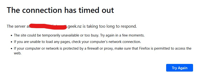

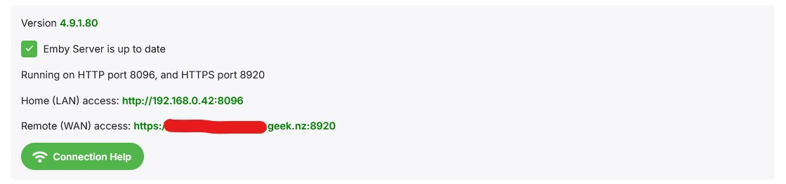

Geophph 6 Posted October 18, 2025 Author Posted October 18, 2025 Sorry to necro this thread but I could really use some help. I think I have set everything up, I can see my 8920 port is open andI have generated the SSL Cert using this guide however when I click the address here: All I get is this Im just a bit lost and could really use some guidance. Thanks

Geophph 6 Posted October 18, 2025 Author Posted October 18, 2025 (edited) I have performed a restart so here are some more recent logs. I am able to connect if i use my public IP pointing at the 8920 port however I get the security risk ahead screen and that IP must be set in the emby external domain setting. However when I try and use my Domain name thepage comes up as server not found. Im sure I've done something wrong or im missing a step but I just cant for the life of me figure it out. I got my domain from metaname if that helps. Thank you again.embyserver.txtembyserver-63896468003.txthardware_detection-63896468021.txt Edited October 18, 2025 by Geophph
Solution Lessaj 486 Posted October 18, 2025 Solution Posted October 18, 2025 (edited) It looks like your server is listening on 8920 so that's good that means your certificate should be working otherwise it can't start the listener. If you use a service like canyouseeme.org does it show 8920 as open? From within your network when you connect to https://192.168.0.42:8920 and you view the certificate, does the CN (common name) of the certificate match your domain name? It's normal to have a security warning since you're using the IP, this is just to make sure it matches what you expect. If yes, when you perform an nslookup on your domain, does it match your public IP? If yes, then you need to use the domain name to access it externally, not the IP, since the certificate would not be valid against the IP. You can further test this on your local system by putting in an entry in your hosts file for your domain which points to 192.168.0.42, this will bypass the DNS lookup resolving to your external IP and use the local IP, but still use your domain name. You should not get a security warning using your domain name at this point. Edited October 18, 2025 by Lessaj
Geophph 6 Posted October 18, 2025 Author Posted October 18, 2025 (edited) @LessajHoly cow it works! I was able to see the open port on Canyouseeme.org. In your next step I could see the certificate validation had the correct common name however I couldn't quite understand what you meant with nslookup (Again im really new to all this so it probably seems dumb). I logged into my domain registrar and pointed the domain to my public IP and hey presto it just started working! Thank you so much! Now to see if it can be accessed outside of my network. Edited October 18, 2025 by Geophph 2
