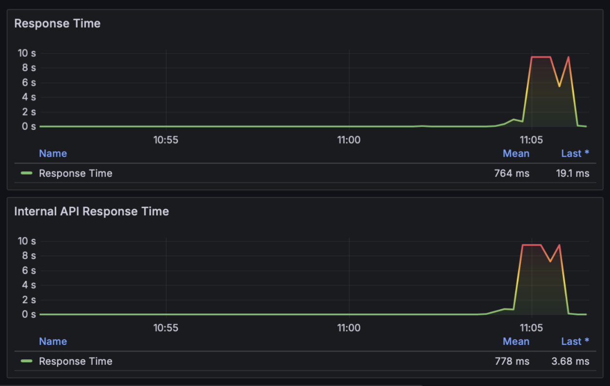

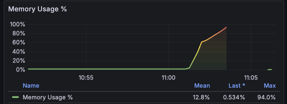

awkimball 17 Posted October 17, 2025 Posted October 17, 2025 Hi all, I have been chasing emby container hanging/crashing for the past few months and finally think I have narrowed down the specific root cause. Context: Dell R730 Proxmox 9 Host (48 CPU, 128GB RAM) Debian 13 LXC Container w/ Emby 4.9.1.80 (42 CPU cores, 32GB RAM) Periodically my emby container completely stops responding, becomes very sluggish and I am not able to login via SSH or the proxmox pct console tool. I originally thought this was an intel GPU issue as I switched from an NVIDIA GPU earlier this year and I anecdotally thought the issues begun around then. It was very hard to diagnose because I do not have access to the container when it is in this failed state. I finally broke down and setup Prometheus for monitoring and a Grafana dashboard, and this has finally indicated that I am really seeing a OOM RAM issue. For this specific issue repro I am streaming 2 4K movies simultaneously and both are Direct Play / Direct Stream Remuxing due the the file container not being compatible with macOS Safari. As you can see, as soon as the streams are started the container RAM completely fills up, and after a couple of minutes the container becomes completely unresponsive and the streams stop. At this point, I have to force stop the container and restart it to recover. I suspect this is because emby/ffmpeg is remuxing the video files into a container compatible with the streaming client, and as such is loading the entire (large) video files into memory. I have used emby for years, why is this only an issue within the past year? If this is simply a linux memory management issueI I would expect the kernel to handle this properly and dispose of cached memory when it gets too full. Is this an emby/ffmpeg issue? Swap is off on both my proxmox host and the emby lxc container as I have a lot of RAM, I would prefer to keep swap turned off. Here are some images from my grafana dashboard that shows the rapid memory fill up just a few minutes after the streams begin, and then the metrics cut off when the container becomes unresponsive. I will also upload the emby server and ffmpeg stream logs from this session, with enhanced logging turned on. It seems really odd that I can no longer serve 2x 4K streams simultaneously when they aren't even transcoding, just remuxing/direct playing Thanks! ffmpeg-remux-f64d60e1-684c-4e99-83d0-f5aece2eeb5c_1.txt embyserver-63896295956.txt ffmpeg-directstream-101e7ef9-94c8-4e6b-b8ec-0ada5e8a74d4_1.txt 1
awkimball 17 Posted October 17, 2025 Author Posted October 17, 2025 Obviously I can mitigate this by throwing more RAM at the emby container, but why is it loading the entire video file into RAM? I suspect if I give it more RAM it will just fill that up too and then crash again

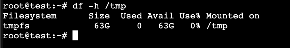

awkimball 17 Posted October 17, 2025 Author Posted October 17, 2025 2 minutes ago, Lessaj said: Is your /tmp file system RAM backed or disk backed? This is where the temporary files will go when remuxing or transcoding. Do you monitor the space used for this path? Wow.. I think you nailed it. /tmp is indeed tmpfs which is RAM backed. This normally would be fine, but weirdly inside the container is says tmpfs is allocated 64GB even though the entire container only has 32GB. I will dive more into this, it seems like something is going wrong when proxmox determines how big the tmpfs should be

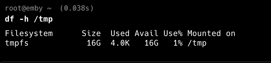

awkimball 17 Posted October 17, 2025 Author Posted October 17, 2025 OK! Problem pretty much solved. It looks like there's some issue with proxmox/cgroups/lxc which means that the tmpfs size is created with half of the host's RAM and completely ignores the actual container memory limit set in the proxmox lxc .conf. As a result, it tries to fill tmpfs to 64GB and when it hits the container limit (32GB) it OOMs and crashes. I am going to make a post on the proxmox forum and see if this is expected, or a known issue or something. In the meantime, I am going to override this with `lxc.mount.entry = tmpfs tmp tmpfs nodev,nosuid,size=16G 0 0` in my container config which should limit tmpfs to half of my containers RAM, rather than half of the host ram. 1
