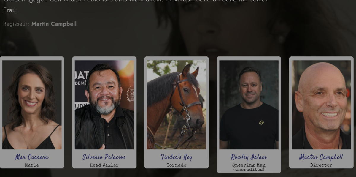

I noticed in freshly scraped media that translation for the director is missing. I realized that the correct translation must be available, as "Regisseur" is clearly displayed above, see screenshot below (Martin Campbell).
I investigated the remote data and noticed in the item json, that crew now seems to also get the "Role" applied, not only the type as before.
      "Name": "Martin Campbell",
      "Id": "124941",
      "Role": "Director",
      "Type": "Director",
      "PrimaryImageTag": "30ca34459bb499df2e92e44714e88be3"
While the type gets translated, the role is not. The role of non-actors cannot be edited from the web interface.
A solution would be to remove the role as before or also apply the translation to the key, with the risk of falsely translate role names.
